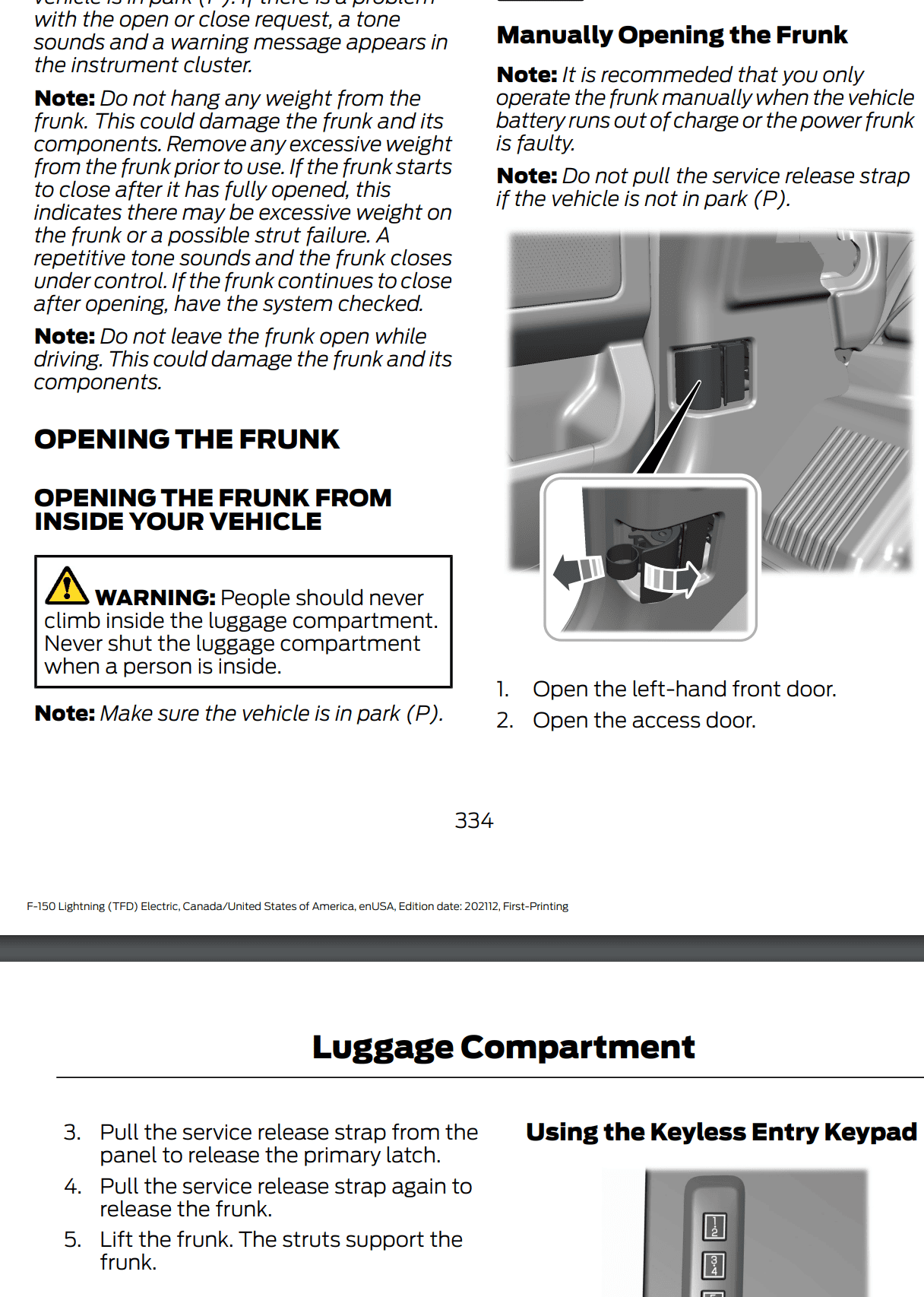

DO NOT CLOSE THE FRUNK UNTIL YOU RESOLVE THINGS.
On the Mach-E, you can't open doors or frunk without power in the 12V. F-150L battery also in frunk. Leave it open until you resolve things.
That's not true for the Lightning.

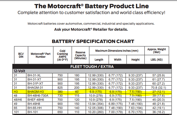

I have to ask...is the 12v battery a normal, available 12v? If so a trip to the autoparts store may be in order. I know you shouldn't have to pay(warranty) but a quick battery switch *may* resolve the situation quickly.
The 12v battery is smaller that the typical 12v ICE battery. It only has 380 CCA with very little reserve capacity. I don't think it would start my 31 hp mowing machine.
But temporarily, any 12v automotive battery could supply the power needed.
Interesting..wonder why they went with a small battery. I get that it isn't used to start the engine, but I had a Ford hybrid that always used the "big battery" 330v to start the ICE engine. It had a normal 12v battery...
I think it is the same size battery as the MME. I'm sure they went with the smallest possible size for two reasons: Cut manufacturing costs and reduce weight.
Maybe..it was nice with then hybrid because I could run down to any Autozone/Advance Auto and pick up a new battery...
I can say as an aside that when the battery went dead in the hybrid it died quick and the car was DOA. No sliding scale of weak battery or anything...when it went dead NOTHING electrical worked.. even those ran off the big battery. I guess what I'm trying to say is the 12v battery is critical to the system, even if it isn't in use. At least that was the deal with Ford gen 1 & 2 hybrids.
It's simply because a big battery isn't needed to drive a huge starter motor. It's needed to provide safety mechanisms to disable HV from being active 100% of the time. And unlike your starter batteries on your typical ICE, which are used to start the engine then kept topped off, these batteries are deep-cycled more (but aren't necessarily designed for it).
Their job is to 1) enable contactors in the battery pack to enable HV energy to those systems that need it, and 2) keep regular systems alive so the vehicle can continue to operate while "off".
They're kept small because there's no need to make them huge and expensive, because the HV pack can kick on and power things.
