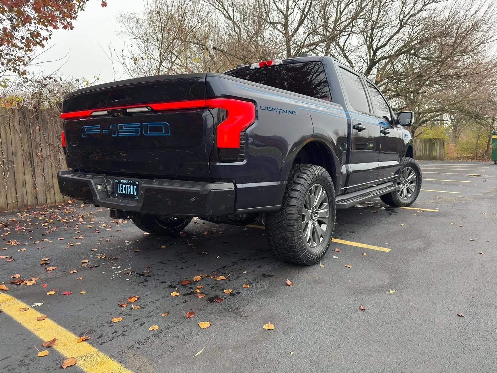

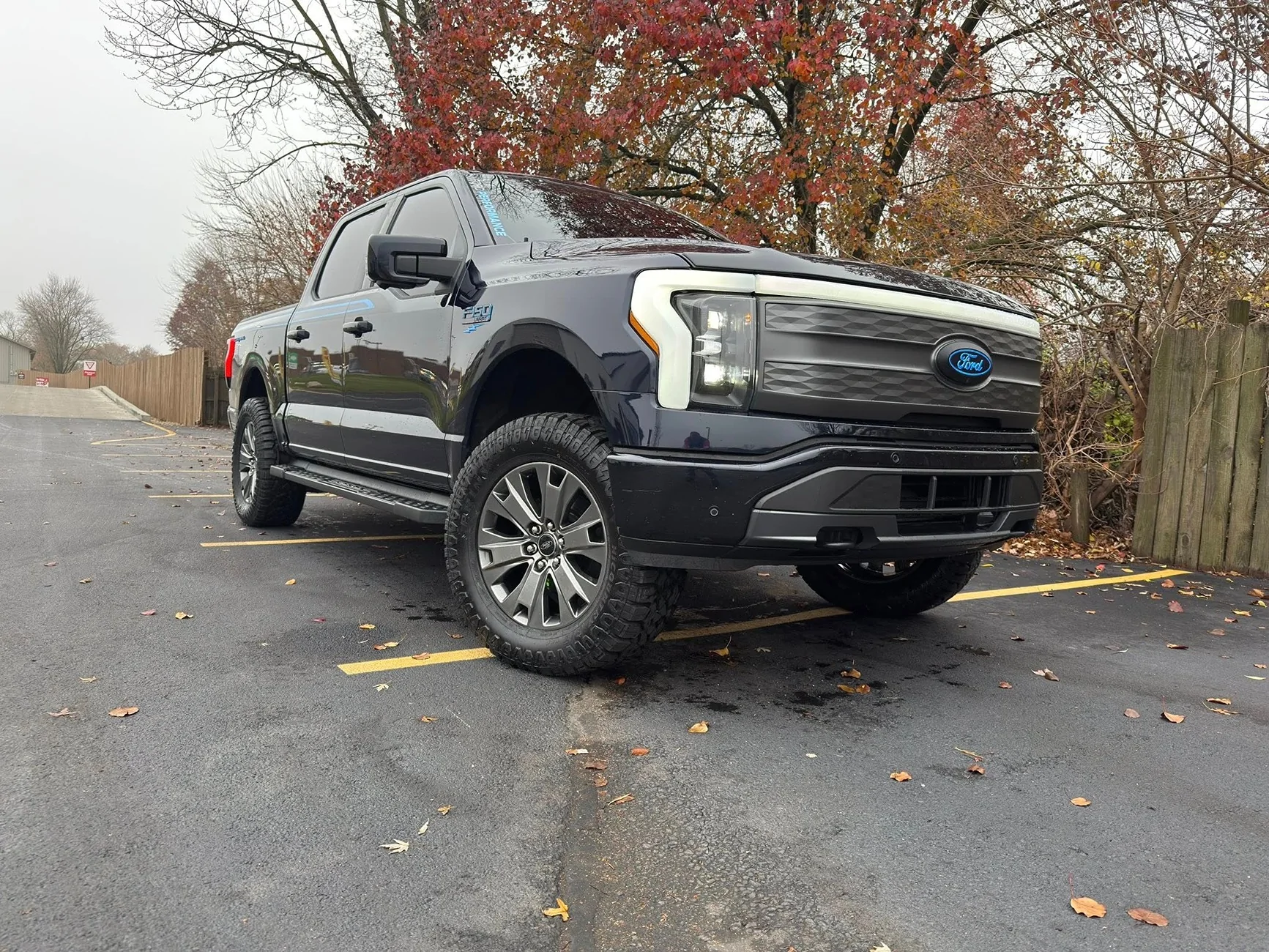

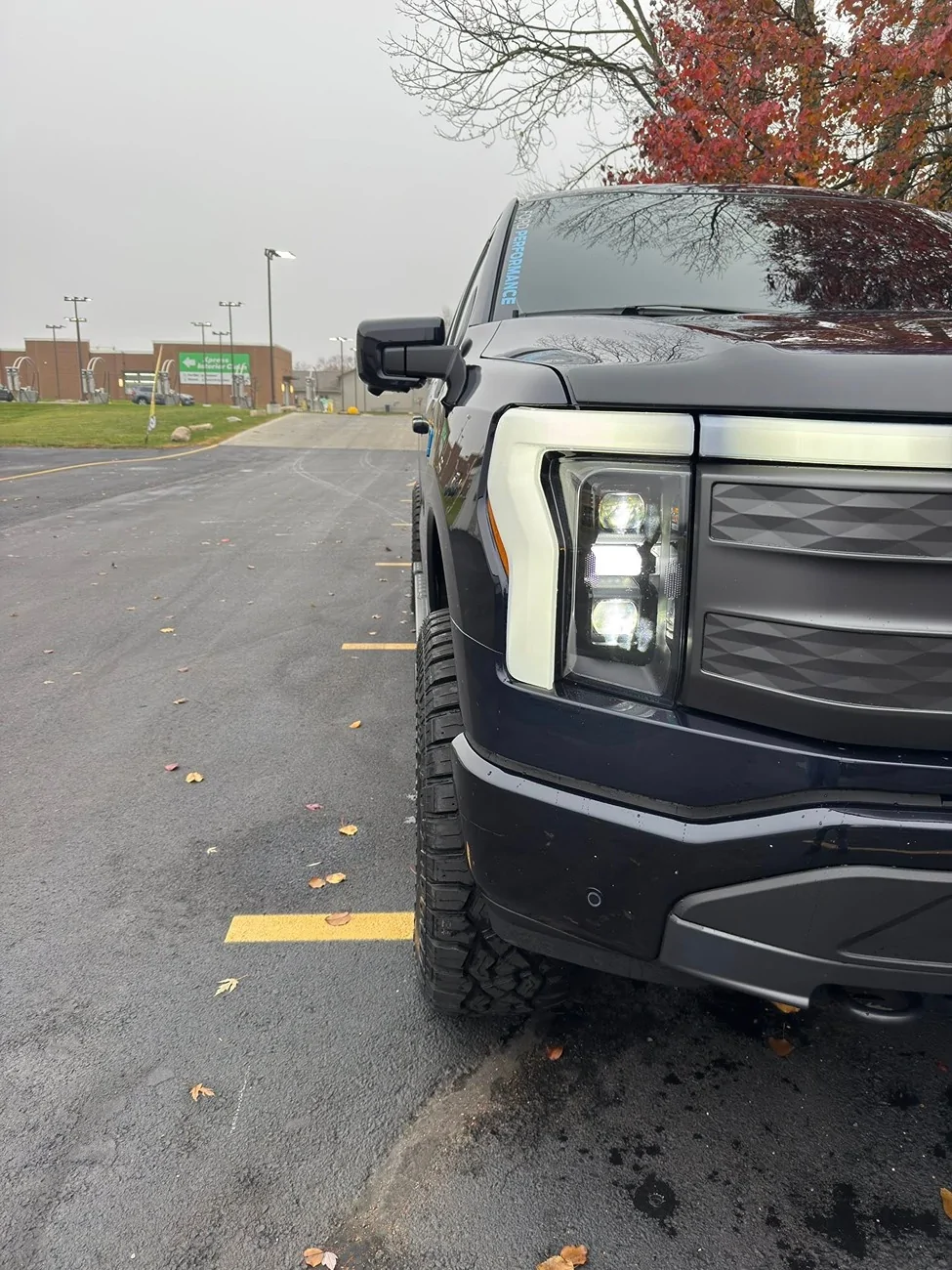

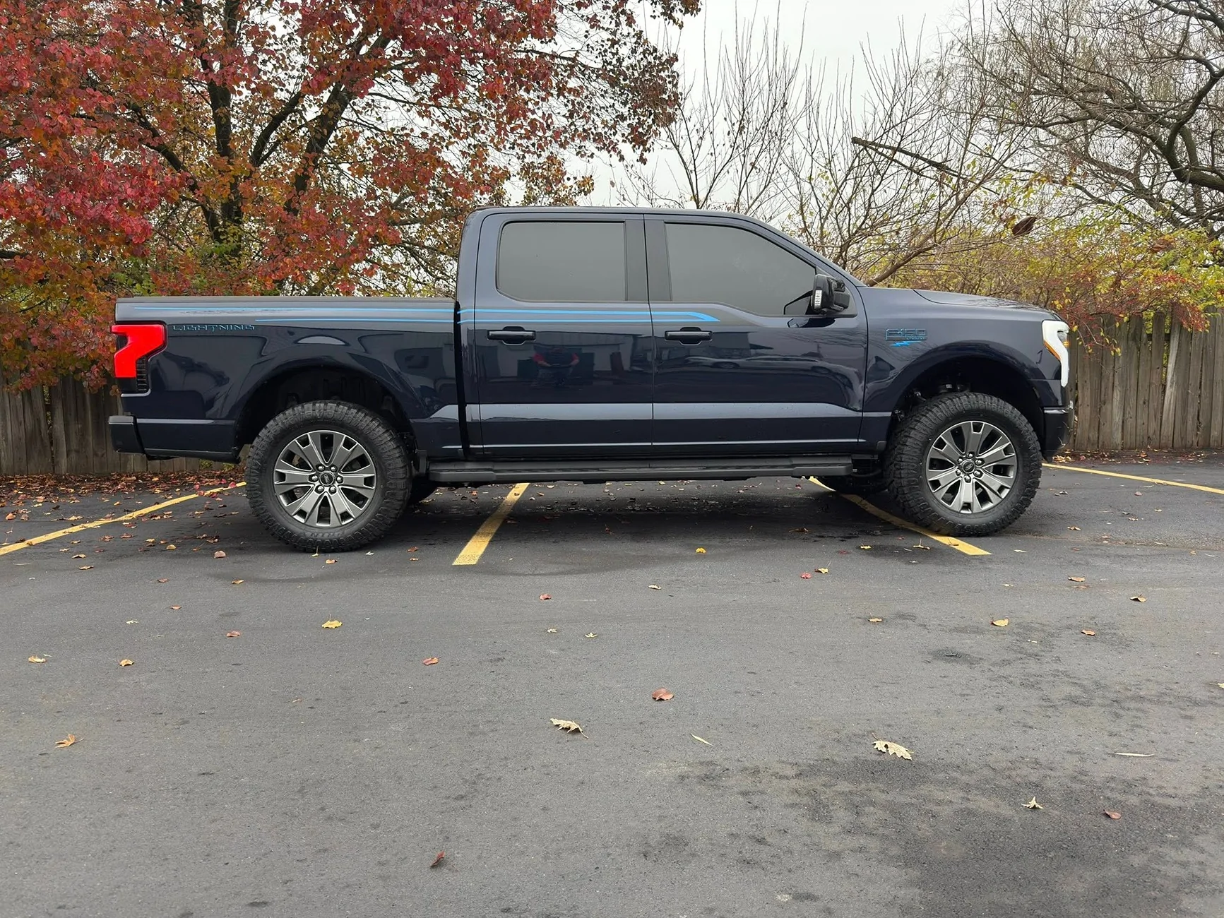

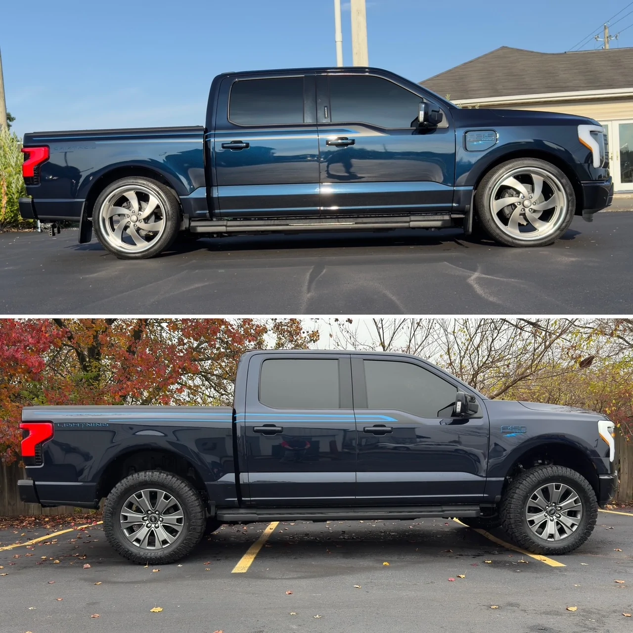

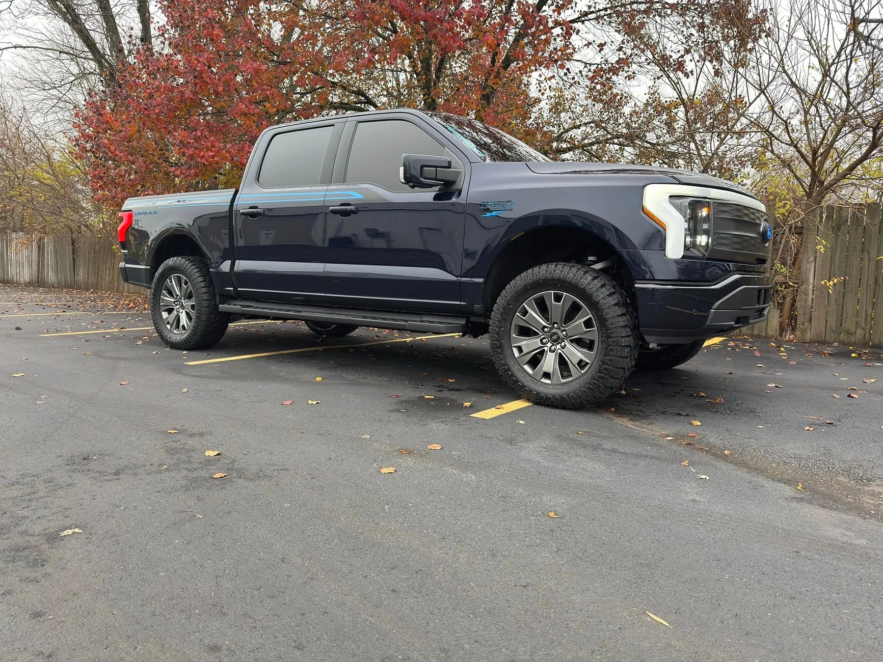

Been running the drop setup for about a year now. I love it and think it looks great but I was ready for a change for a few reasons...
1 - Wanted a different look
2 - Wanted more "truck functionality". (Payload, towing, etc.)
3 - Better ride quality. (Didn't ride awful lowered but you could definitely tell a difference)
4 - Axle boot issues. (I had lowered mine a little more than others and it was causing the inner boot to rub the control arm on suspension compression resulting in eventual leaks)
I went with the Rough County 3" leveling kit that includes new upper control arms. Tires are 35x12.50 20's on 2016 Lariat Special Edition wheels with 1.25" spacers. Spacers not only help the look but are necessary because without them the inside of the tire rubs the upper control arm.
I'm super happy with the look and ride quality. No issues with ADAS, Blue Cruise, etc.

I noticed your "cosmetic" charging port door is no longer there!
MaintGrl
Marsha
Dec 21, 2023
812
912
El Sobrante, Ca
Yes, it IS in some pictures, but gone in others....
Rayden
Aug 11, 2025
218
242
'23 Lightning Lariat ER
I think it's only on that first "Before" pic and seems to have vanished after that. I'm guessing since he works in a collision repair shop, maybe he had a new front corner panel put on?
jmyer72
jmyer72
Jason
Dec 19, 2024
166
2024 F150 Lightning Lariat ER
Service Advisor
Good catch. No, it's a 24 so it doesn't have the fake door. I reversed a pic I had of the driver's side so the truck would be facing the same direction
