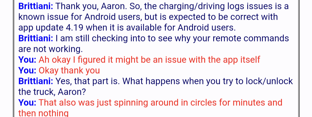

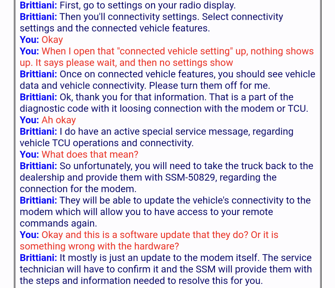

The saga continues: I haven't had any further issues with the Deep Sleep Mode or LVB. However I'm still having the same issues with Fordpass. Basically none of the remote commands work at all. They just time out and nothing happens. Additionally It will not refresh the information from the truck, which is very frustrating since I can't track charging, or anything else. After researching I've gone through every step of rebooting, reinstalling, reactivating, reinserting, reinspecting, and rereading that I could find. I know other people are having issues with Fordpass so I wanted to share some info that I got from Ford below.
It seems like some of it is the app itself (no surprise) and will be "corrected" with the next app update. The other issues are somehow linked to the modem in the truck, so I will be going back to the dealership tomorrow morning with a specific code (SSM-50829) for them to address this issue. Transcripts below:
