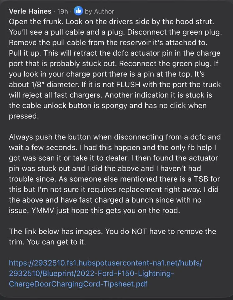

I saw someone resolve this by using the latch release in the frunk to pull the pin back.. and they were then able to dcfc. Has nothing to do with getting moisture in the charge port.. it's able to cope with that. Oh I see reading now you think it might be frozen due to the water.. that makes sense.
Mine was just stuck protruding out, Ford replaced it.. but i wound up spending 6 hours at a level 2 charger to get home when that happened.
Good luck!
I was just typing that to see if that would help with the issue.

Let us know, I've been recommending it to people but I haven't heard of anyone actually trying it.
