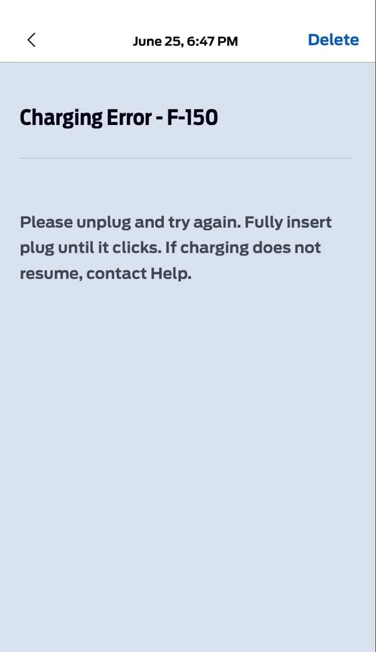

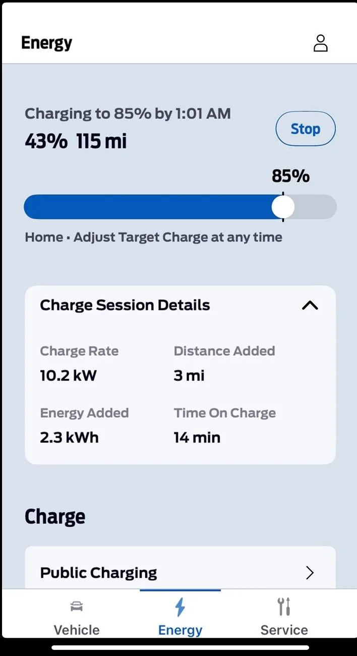

I’m still getting a Ford Pass “Charging Error” when I used my Tesla Wall Connector at home just now.
It’s hard wired on a 60 amp circuit set to charge at 48;amps. The Wall connector was powered off while I was away. i turned the breaker back on about 1 hour before charging so it was essentially power cycled. The blue light sequence on the truck charge port acted normally and charge started normally, but Ford Pass message showed “Charge Error-F 150”.
additional info: yesterday I charged at our cabin location with my other Tesla Wall Connector with no errors. That charger is on a 50 amp line charging at 40 amps. I don’t remember ever getting the charge error at the cabin.
next time I’ll turn down the output at home to 40 amps and see if it errors again.

I don't have any scheduled charges set at all. Ford Pass posts a charging error but the truck charges fine and EVSE starts charging immediately as expected. It's only recently that the issue popped up. like everyone else who is posting the same thing.
It has to be a Ford Pass issue.
