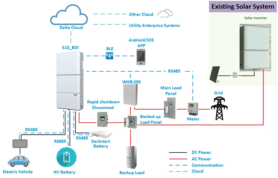

But then, there's also people with existing home batteries in this program using Connected Solutions to feed the grid that are getting this setup. And that works somehow. It's just net metering that's crippled. Or can't net meter alongside battery feeding the grid.
They are not correct. The Ford/Sunrun system is a Delta inverter capable of connecting to the truck, an LG battery (2 actually) and has MPPT for direct solar input.
In addition is can also tie to existing AC coupled solar.
The LG RESU Prime 16H is fully compatible with the inverter they are already providing. Ask them what the add on cost would be. you can buy this battery from signature solar for under $3k, but it sill needs professional installation.
I have the Ford system, and verify that AC coupled solar works just fine in off grid scenario, as long as you move the solar breakers into your backup load panel as well. In my case I have a 9 year old SolarEdge inverter that I tied in. In off grid, the excess solar will charge the truck automatically. I have previous posts on this.
Interesting. Thanks.

tearitupsports
Russell
Jun 1, 2024
455
513
Cypress, TX
These are the direct quotes from Sunrun:
Solar is fine, we just cannot integrate solar into the Home Integrations System because we will run off a different inverter.
In an outage, the solar panels cannot add anything / charge the truck.
That statement is just plain false. I have the system and it works just fine. I would challenge them on this.
This image is straight out of the inverter manual:
Ford F-150 Lightning Massachusetts - Vehicle to X Program 1762467720186-mk
Our deployment is using the Ford Home Integration System (HIS). Is that what you have?
It sounds like the HIS is the limiting factor.
