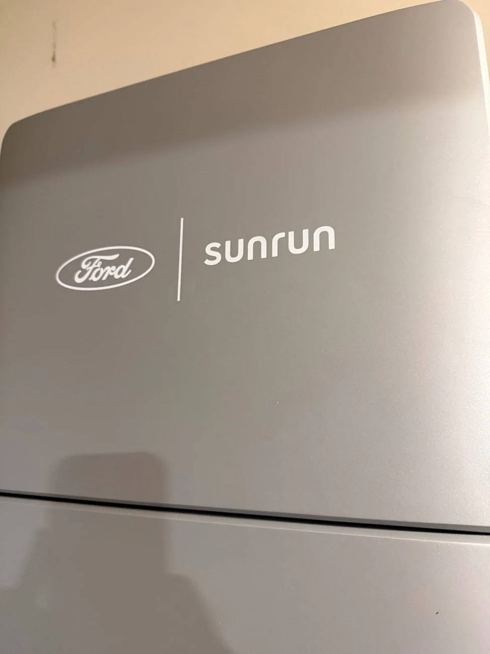

Our deployment is using the Ford Home Integration System (HIS). Is that what you have?
It sounds like the HIS is the limiting factor.
The Delta Ex_BDI is the Ford inverter. There is no limitation in the HIS. Sunrun is just giving you the wrong info.
