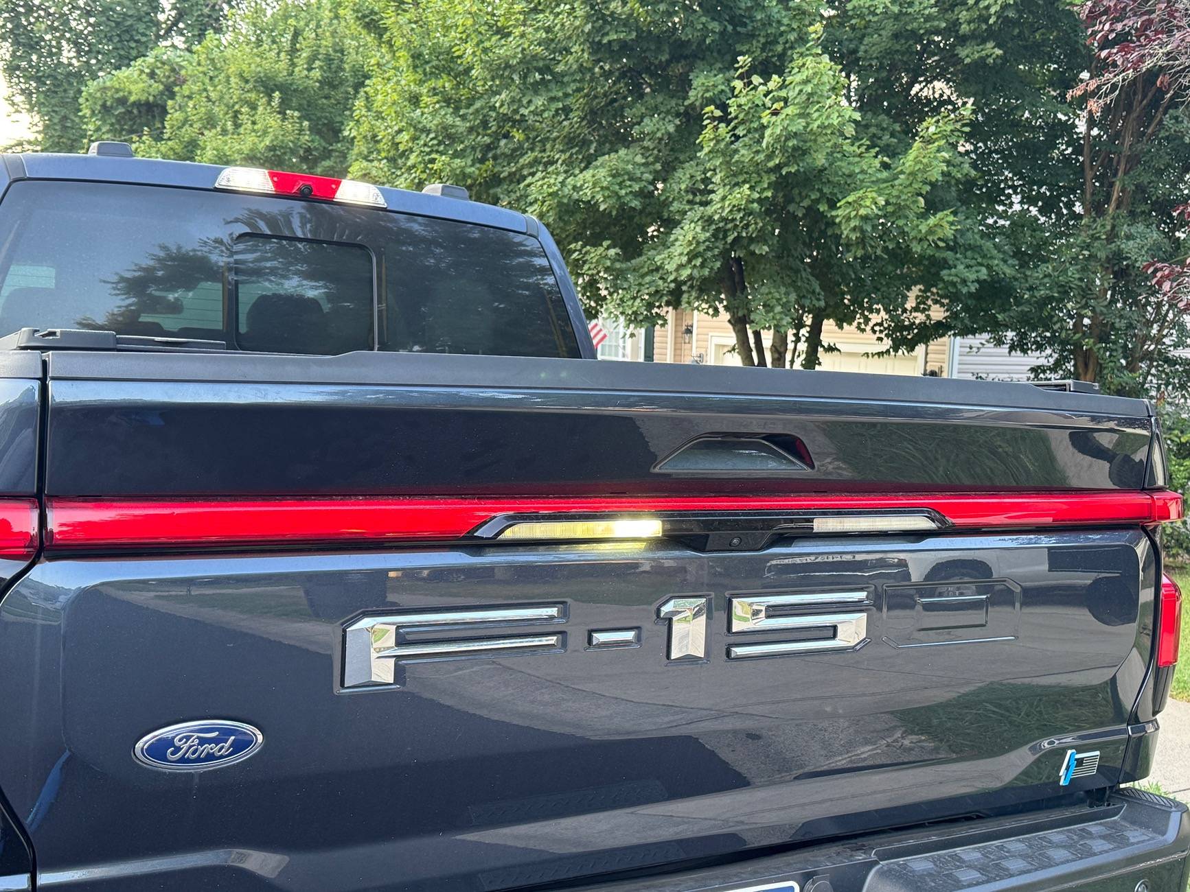

Gotcha. I filed with NHTSA the other day. And I have the trifecta of water, strobe/dead light failure, and camera damage. Mine checks all 3 boxes unfortunately. After the recall…
Ford F-150 Lightning Moisture in the tail lightbar IMG_4685
Great you did that. They have to act when they see safety issues like this, as part of what appears to be an unresolved recall...
