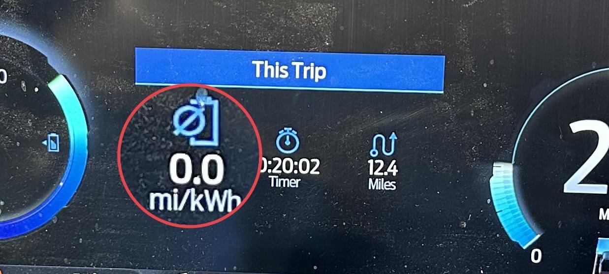

Ford can’t fix bugs that been around since the launch of Mach E.
what’s wrong with this picture? ā€This Tripā€ normally doesn’t reset every time truck is turned off.
Today: it reset efficiency but not time and distance. That’s a new one for me - it usually doesn’t reset all 3.
I don’t always leave my foot on the bake when turning of, though that has not been 100% effective either.
