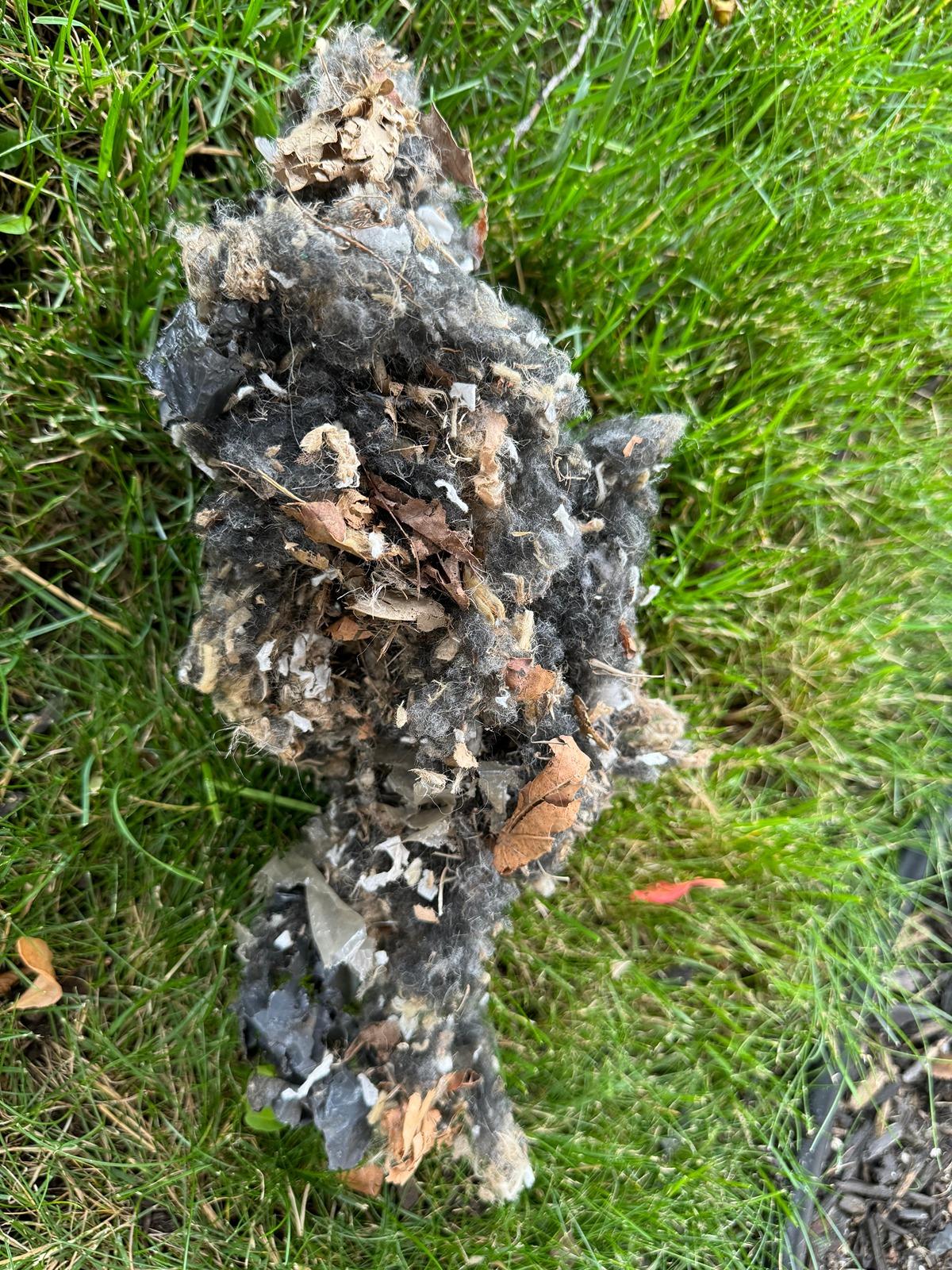

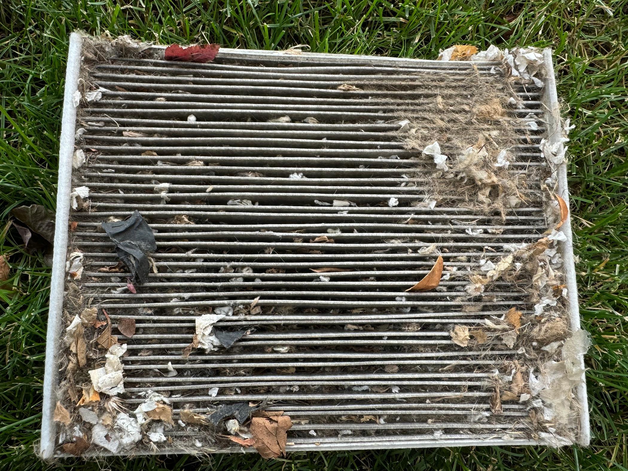

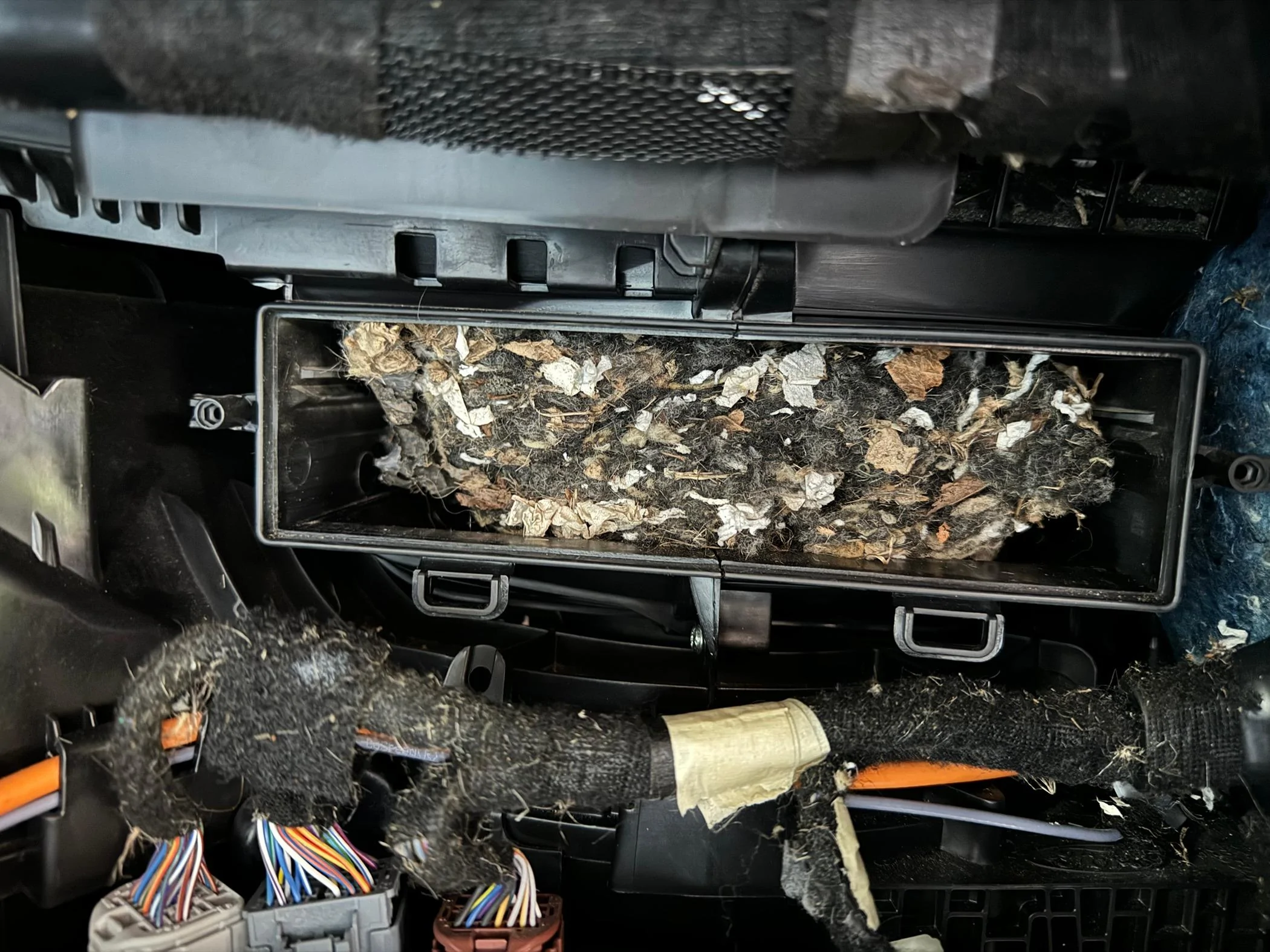

For a while I have not been able to figure out where this smell was coming from whilst in the truck. I had a bag of dog food in the truck while it sat at the dealership on 2 separate occasions for a total of 200 days. Something had gone through the dog food (it was under the seat - emergency dog food - small bag that I forgot to take out). Whatever animal was in the vehicle had hid small amounts of it all over the truck. After multiple thorough cleaning attempts, all dog food seems to have been removed yet the smell still remained. I decided to check the cabin filter and voila.
Hopefully with a new filter, this smell should dissipate in a few days.
Question: Where does the air come from through the cabin filter? Should I be checking elsewhere - just in case?
