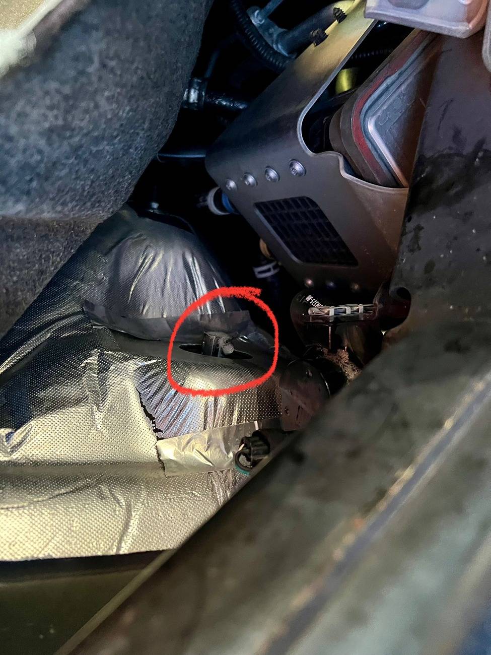

I've been a Ford owner for eons, the problem developed on all my former trucks....
Tips from my favorite PowerStroke technician!!
I was scared to drill the hole through the plastic like that Powerstroke tech.
So, I ordered this less-expensive product from Amazon:
Kool-It
It has a hose that inserts up through the A/C drain opening underneath the truck. The entire contents of the can are dispensed as a foam through the A/C drain. Wait 15 minutes, then turn the A/C on low for five minutes.
My thoughts and things I learned:
This Kool-It product smells like spearmint gum. It definitely fills the entire A/C system with foam. After five minutes, I turned my A/C on high and foam was blowing through the vents in my face. So, I switched it to low for another 10-15 minutes. It's hard to tell how much gunk is removed from the evaporator because the discharged foam drips all over the frame of the truck before landing in the catch pan, or more often, on the tarp next to the catch pan. Inserting the product through the drain did not require the cabin air filter to be removed. I checked the cabin air filter afterwards, and it was not wet.
Below are images of the A/C drain. The drain is located behind the front, passenger wheel well liner. If you lie down behind the front, passenger tire and pull the wheel well liner toward the outside of the vehicle, you'll see the drain. See images below.
Definitely place a tarp under your catch pan. This stuff drips everywhere. Next time, I'll wear safety glasses. A lot of debris falls from the wheel well liner. I'll wear latex gloves next time because the spray top doesn't attach all that well to the canister for the product, so some leaks onto hands.
I'm hoping to get a couple months of good smelling air out of it, but I'm going to order another one or two cans to have on deck when it's time.
Edit: When I reordered, I decided to try this Kool-It product below because it describes the scent as "Fresh" instead of "Mild Spearmint," and I'm curious if it's a different fragrance.
Kool-It Fresh 2-pack
