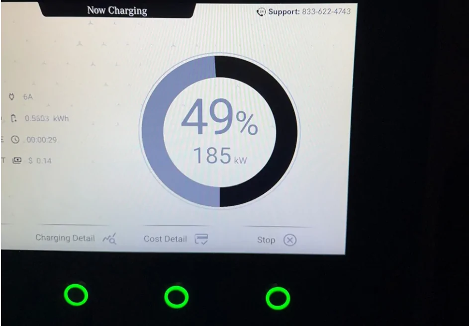

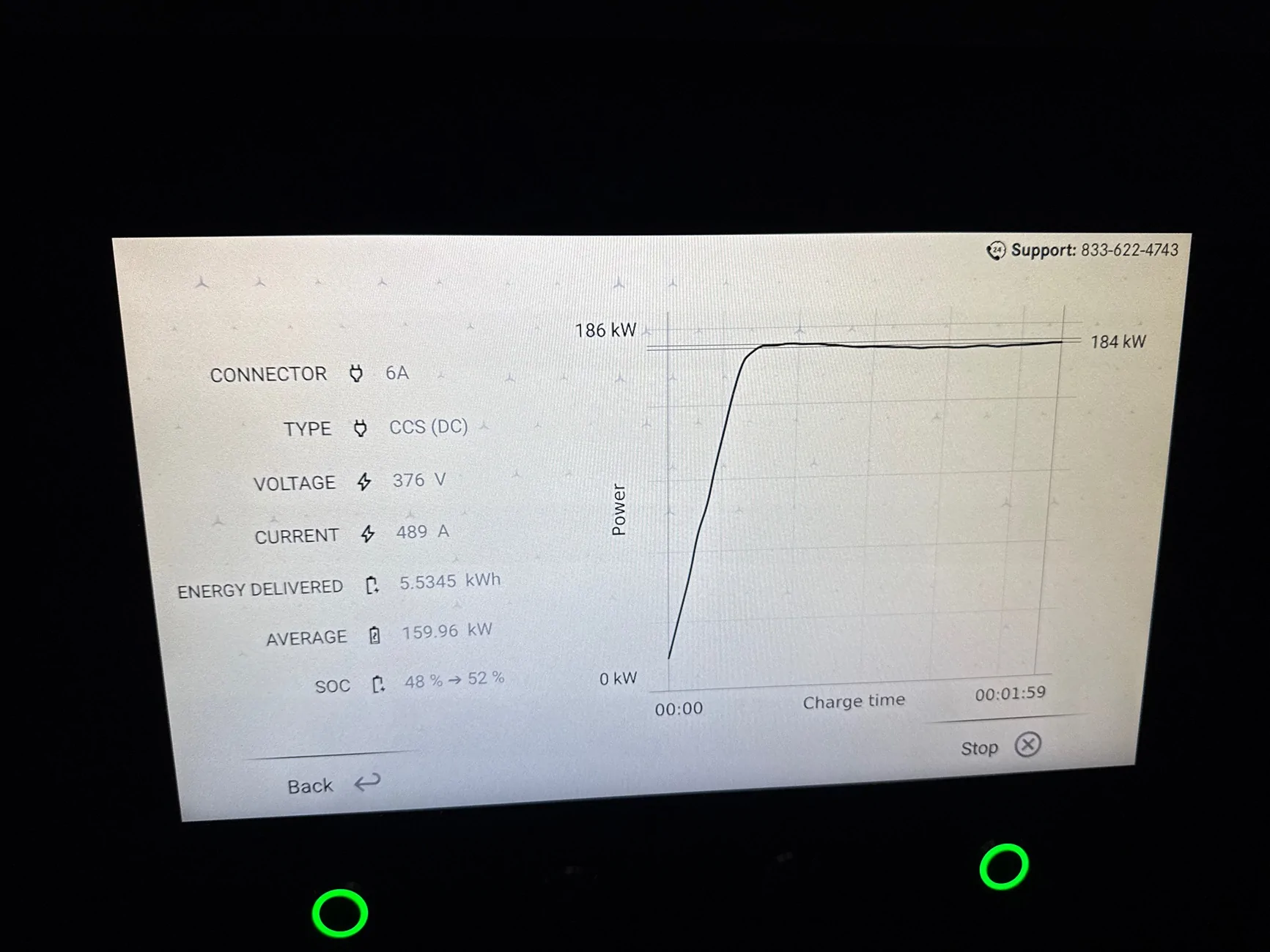

Testing out a new local Mercedes network DC charger. Plugged in at 48% and hit 185kW. Most I ever got before on the SR pack (before swapping it for an ER pack) was 167 kW.

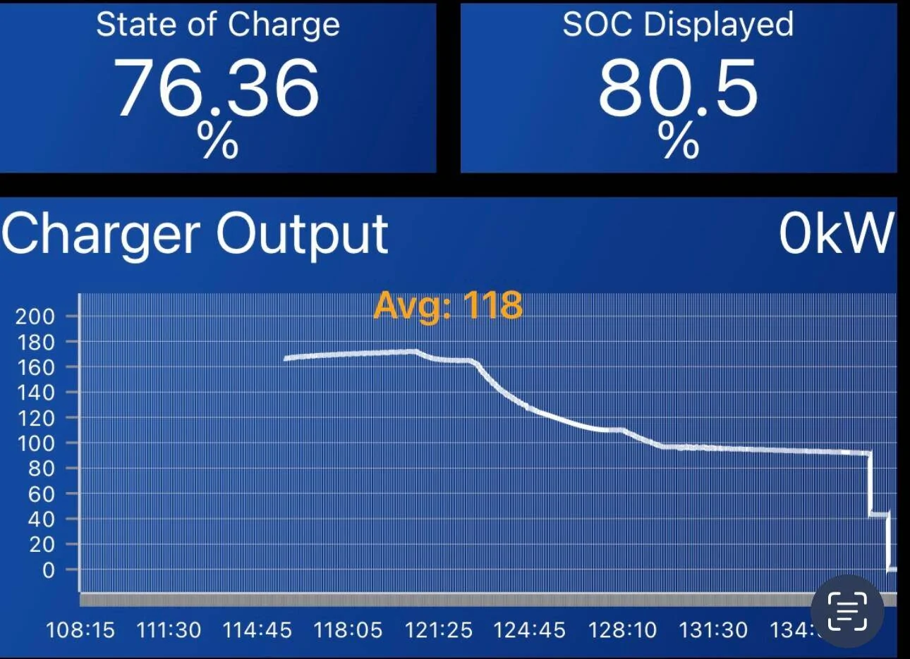

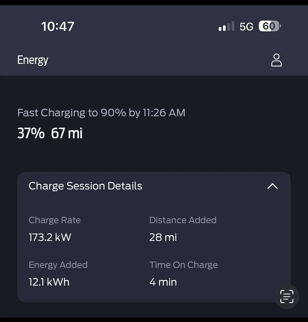

FWIW, I've gotten a bit over 178 max on my SR, but usually ~174 max, occasionally lower.

Both SR and ER are limited to 500A but the ER battery is a higher voltage. That accounts for the higher power on the ER pack. You could have actually pulled 8 kW more but something was limiting you to 489 A.

My guess is it started dropping when I hit 50%.
