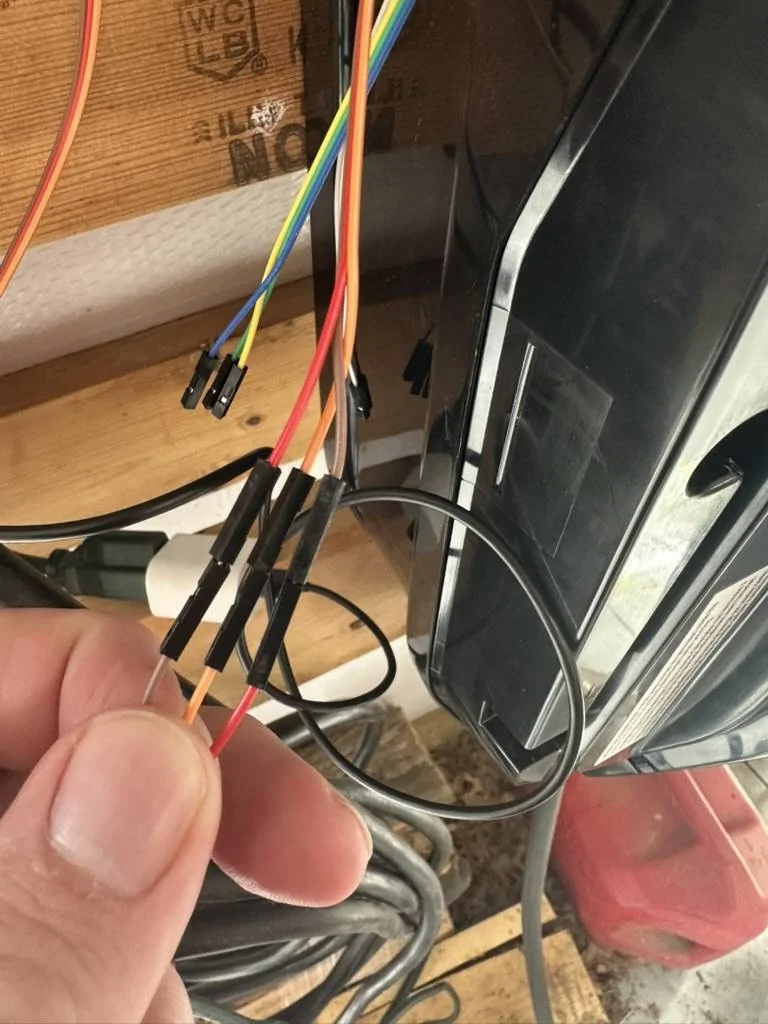

Finally hooked up the usb port to my Pi and noticed it doing this when I had it plugged in. As soon as I unplugged it, it stopped. Wonder if it thinks it is about to get a firmware update.
Were you running any code?

No I was just trying to see if Linux would show anything in dmesg when it was plugged in (it didn’t). I need to hook up the other uart and see if it shows anything, maybe that’s where the usb port is attached to.

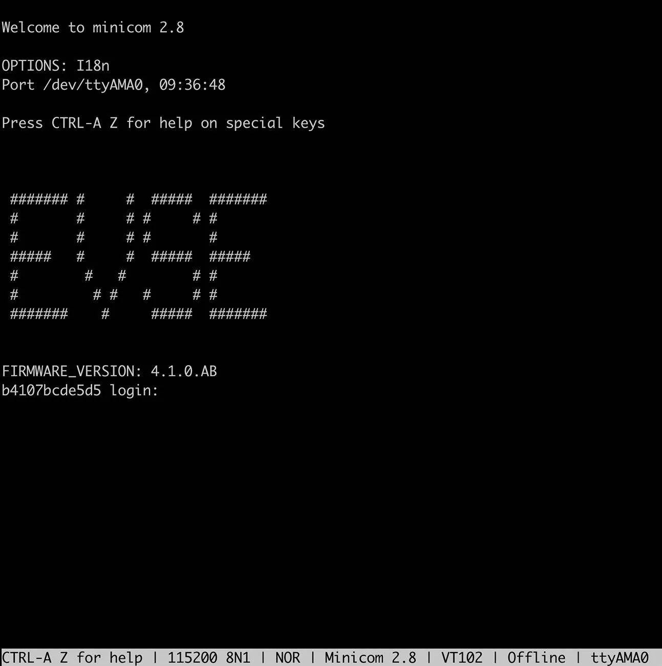

I'm trying now to get UART to work with the A8 Debug UART port but have not yet found the correct serial configuration. I'm getting lots of gibberish on the console though, so I think I'm wired up correctly.
Can someone who has had success share all the details of their serial configuration?

Here is my Minicom setup (115200 8N1) that is hooked up to my Raspberry Pi Zero:
Ford F-150 Lightning New FCSP API Python Library (fcsp-api) Screenshot 2025-07-05 at 2.22.06 PM
