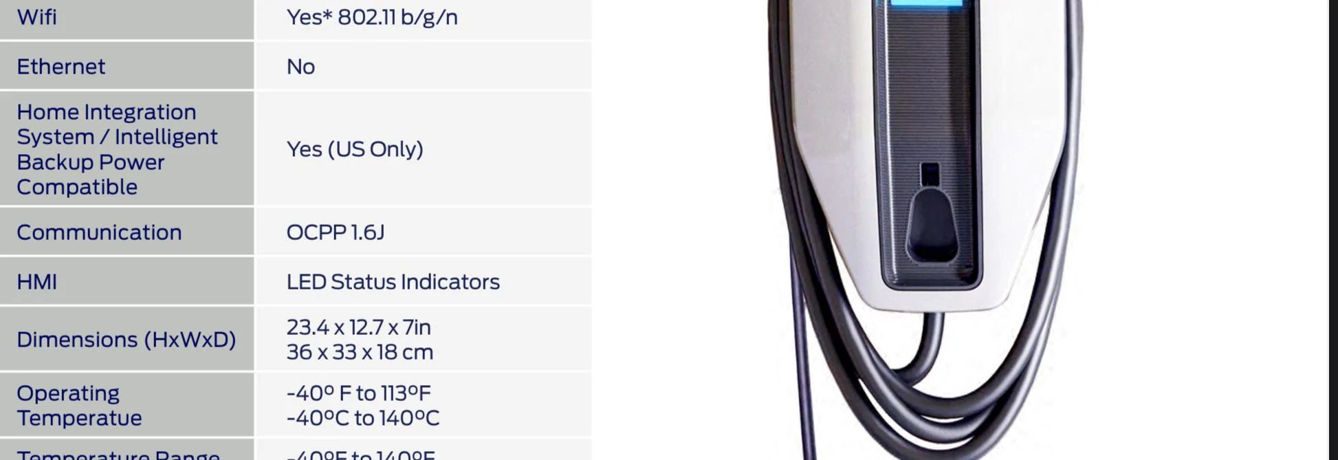

Where did you see a spec sheet that says it can go to 60C? I tried searching but could only find a max temp mentioned in the installation guide:
" d) The maximum rated ambient temperature of this device is 113°F (45°C) "
I apologize….60C is maximum ambient for storage, not in use.
And then we have this spec sheet that says 140C! ?

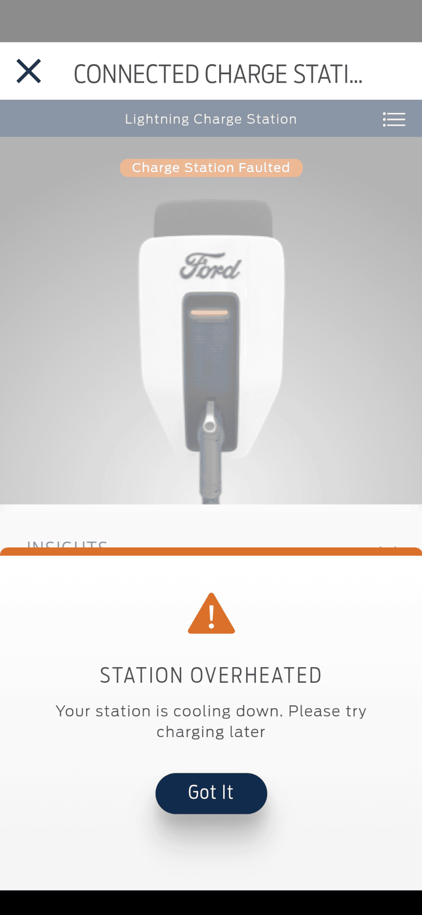

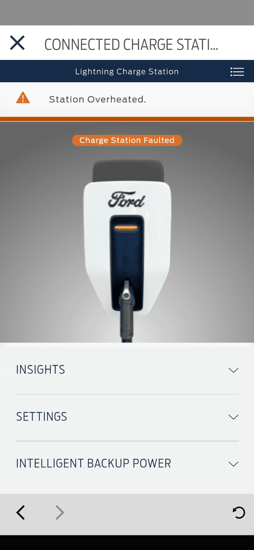

Mine has been doing this for months now. I notified Ford and Siemens, and I was told it was operating as expected, even though my FordPass is getting blow up with error messages.
Similar occurrences on my end. Was told to derate the unit to 64 amps to solve the problem and they were working on a software fix. I did that as instructed and as the spring and summer heated up I started getting the overheating notices again. Which I told them about and received zero response.
