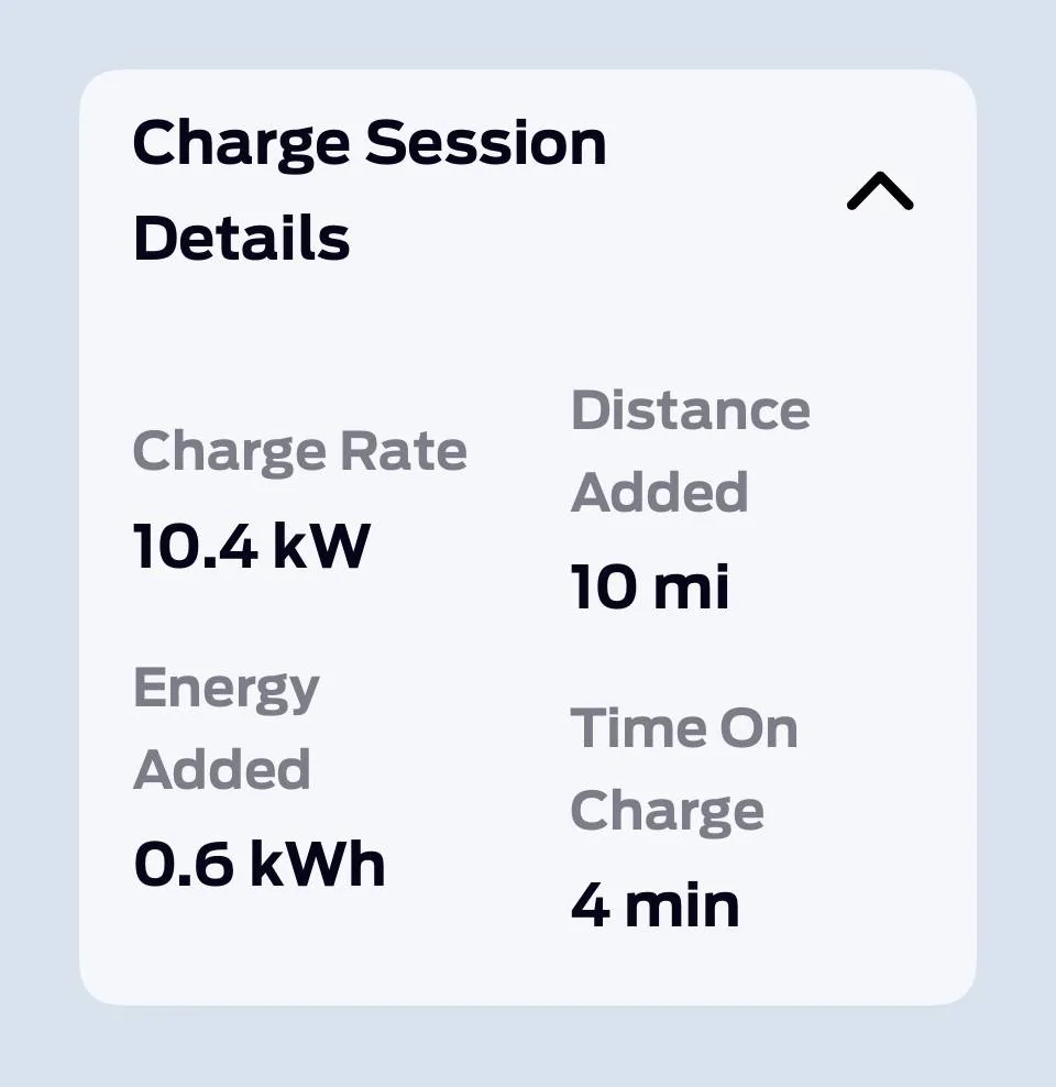

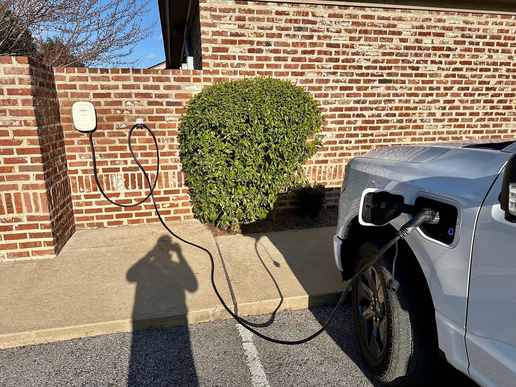

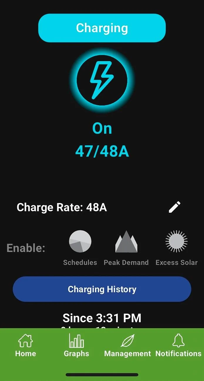

Got the Emporia charging station operational at my office. 60A breaker so it’s charging at the full 48A level. Lots of fan type noise coming from truck but assume that’s normal (I’ve only charged at home on the Ford mobile charger to date so nothing to compare to). Emporia shows charging at 11.1kw.
Cluster and Ford app show all good, but charge rate shows
Still waiting on QMerit for home charger installation.

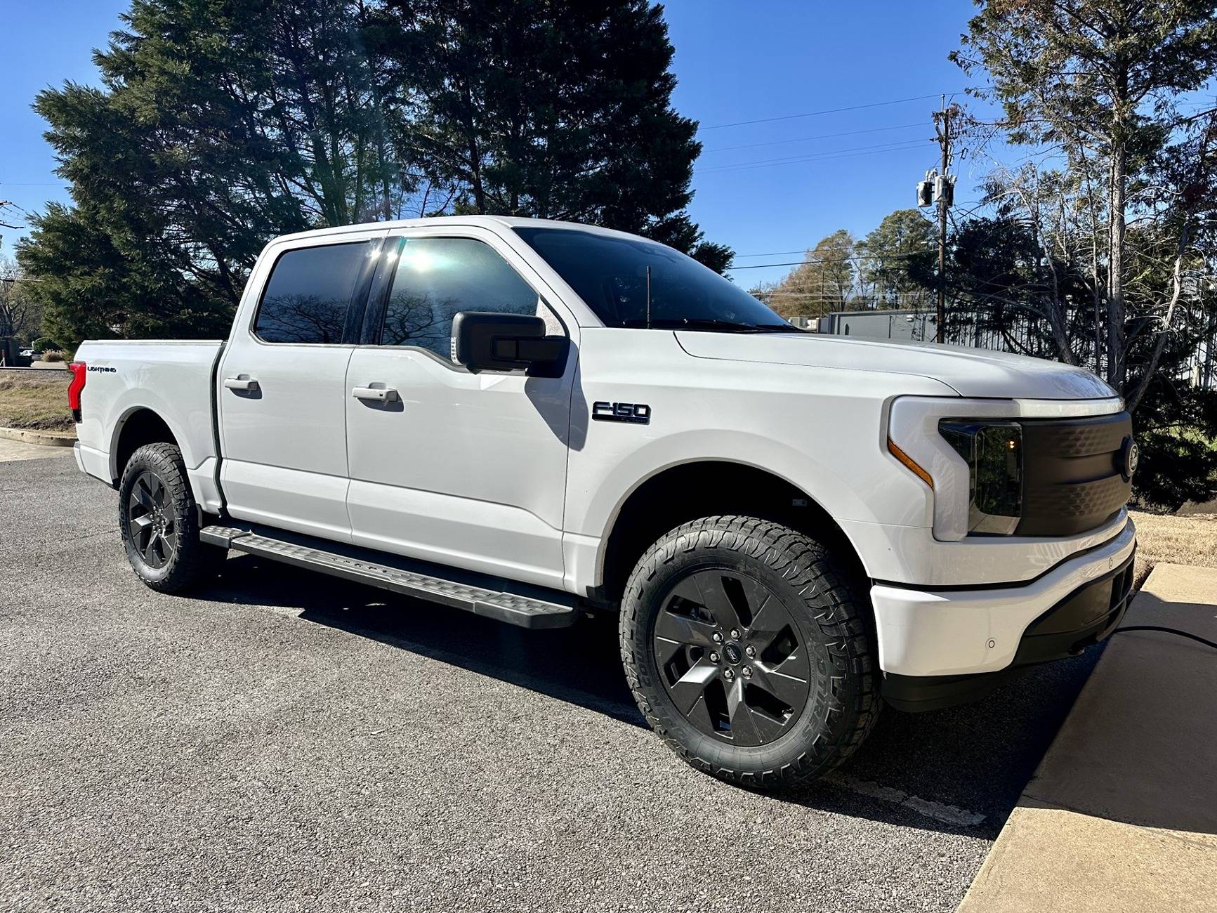

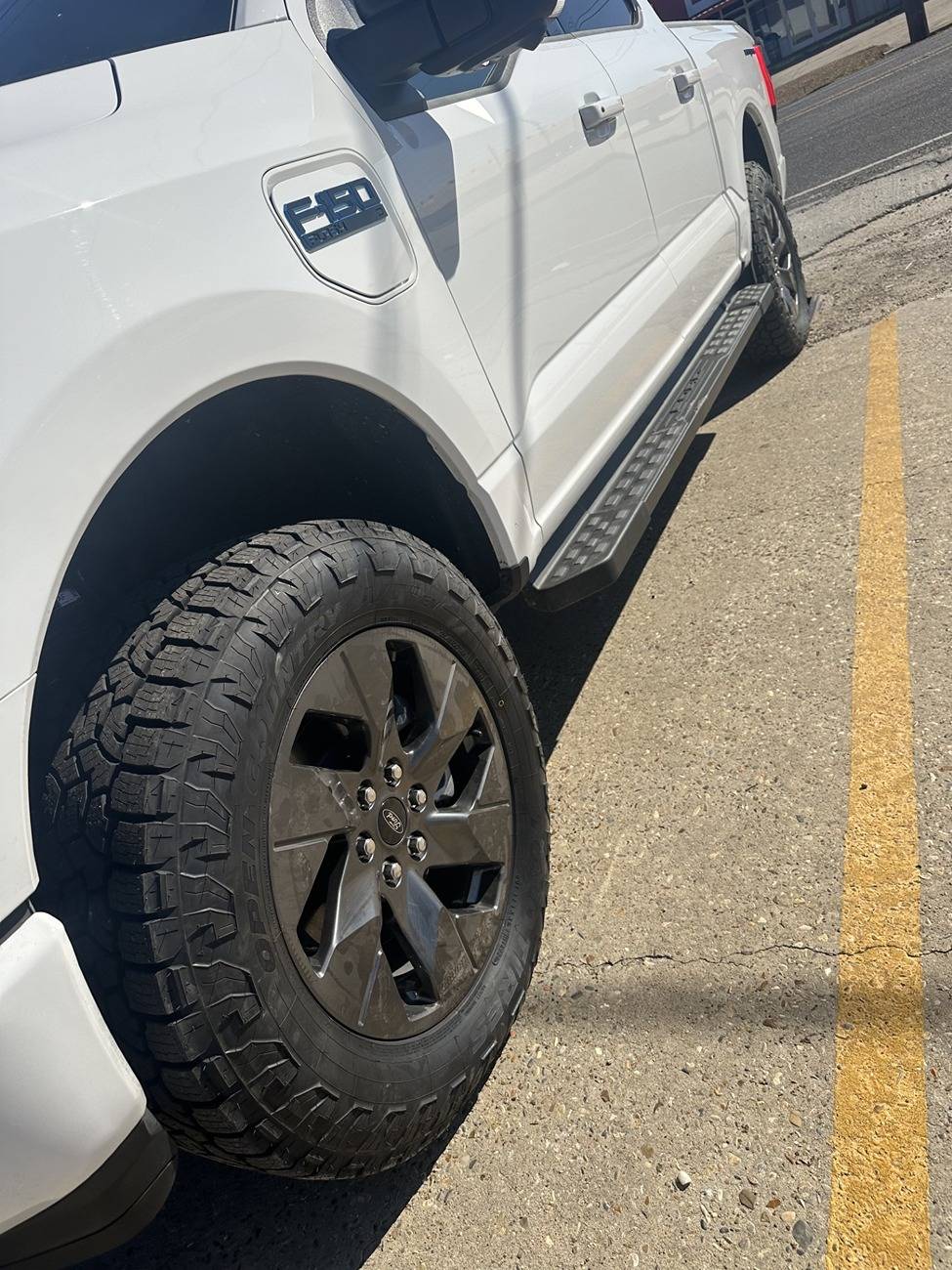

Toyo Open Country ATIII EVs went on today. 275/65/20 (non E rated). Then took it in for alignment since I did the RC puck lift a few weeks ago. Was barely out of spec.
Real happy with how they look and drive. Will report back when I have a handle on range impact. Love the way she sits and looks.
That's all the changes I plan on making to the truck. Just driving from here on out.

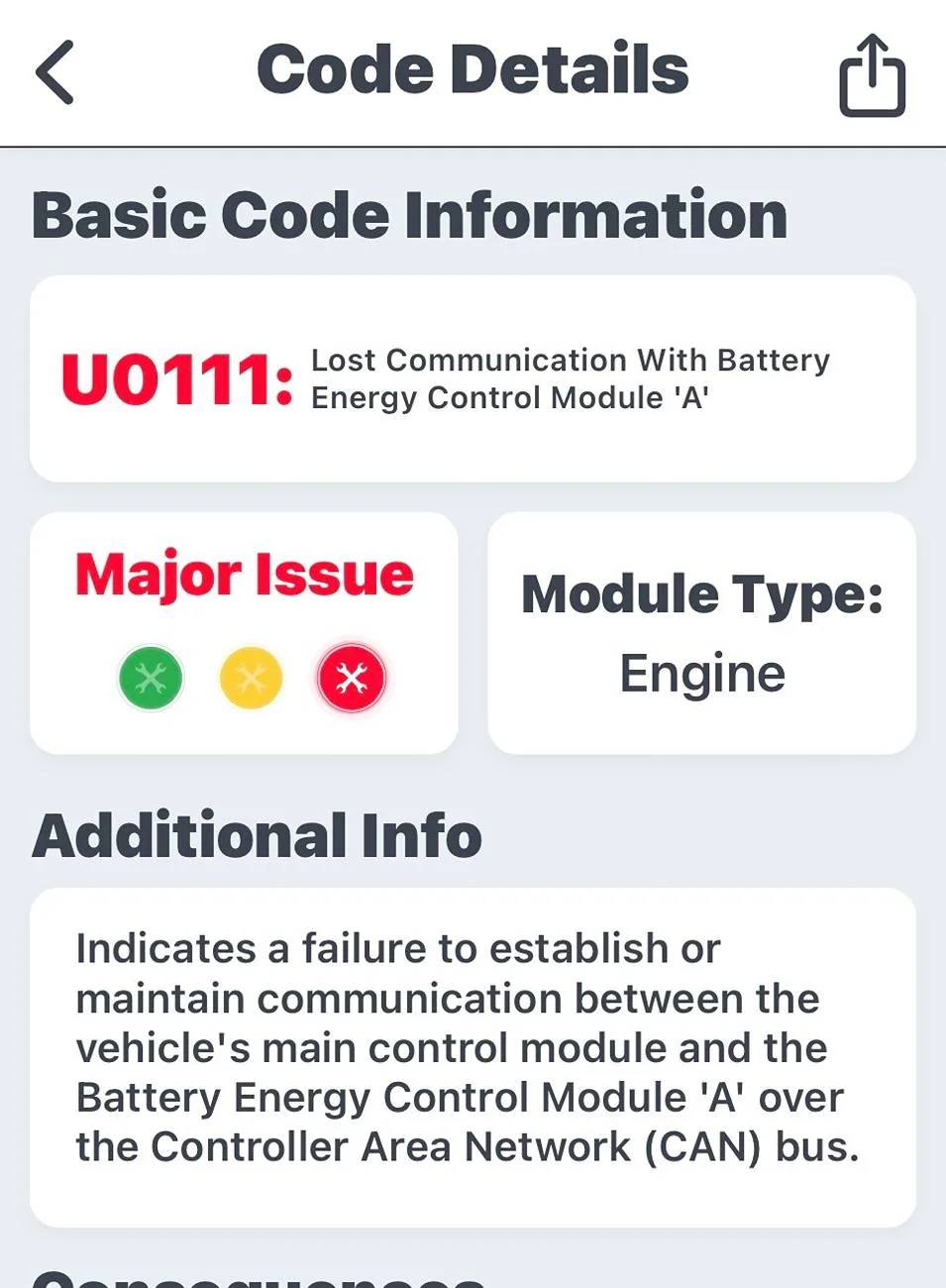

Service vehicle soon warning. Again. Operating normally. Cleared the code. Will take it in i guess. Ruins my day.

Code has been cleared, driving normally. I’m going to take it into the dealership in the morning and let him take a look.
On another note, speedometer is off about 3 miles/hour once truck gets above 70. Ordered a Bluetooth ODB cable and will do the forscan fix when it arrives.

Truck continues to throw the drivetrain error often. And yesterday got a new one, shifter malfunction.
Made an appointment at the local dealer and I’m dropping it off there shortly for the balance of the week. Timing is good since I am out of town for business until Saturday.
They are going to research all of the powertrain codes, replace the shifter, and I also have them looking at my squeaky steering wheel and my rattling brake assembly.
that’s a lot of bad things for a six week old truck. Fingers crossed i guess.
Fans running while charging is normal, especially when it's warm. Had wife wake me at 1 am once. Truck was charging in garage, A/C was on full blast which made it sound like an ICE was running. She thought I forgot to turn off the truck. Nope, it was summer and the truck was cooling the battery.
Qmerit took about a week before I had a local contractor pick up my job. It's possible the contractors in your area to crazy busy. My brother is using them as well, had someone call him the next day. Now he's just waiting for Emporia to get the black version back in stock.
