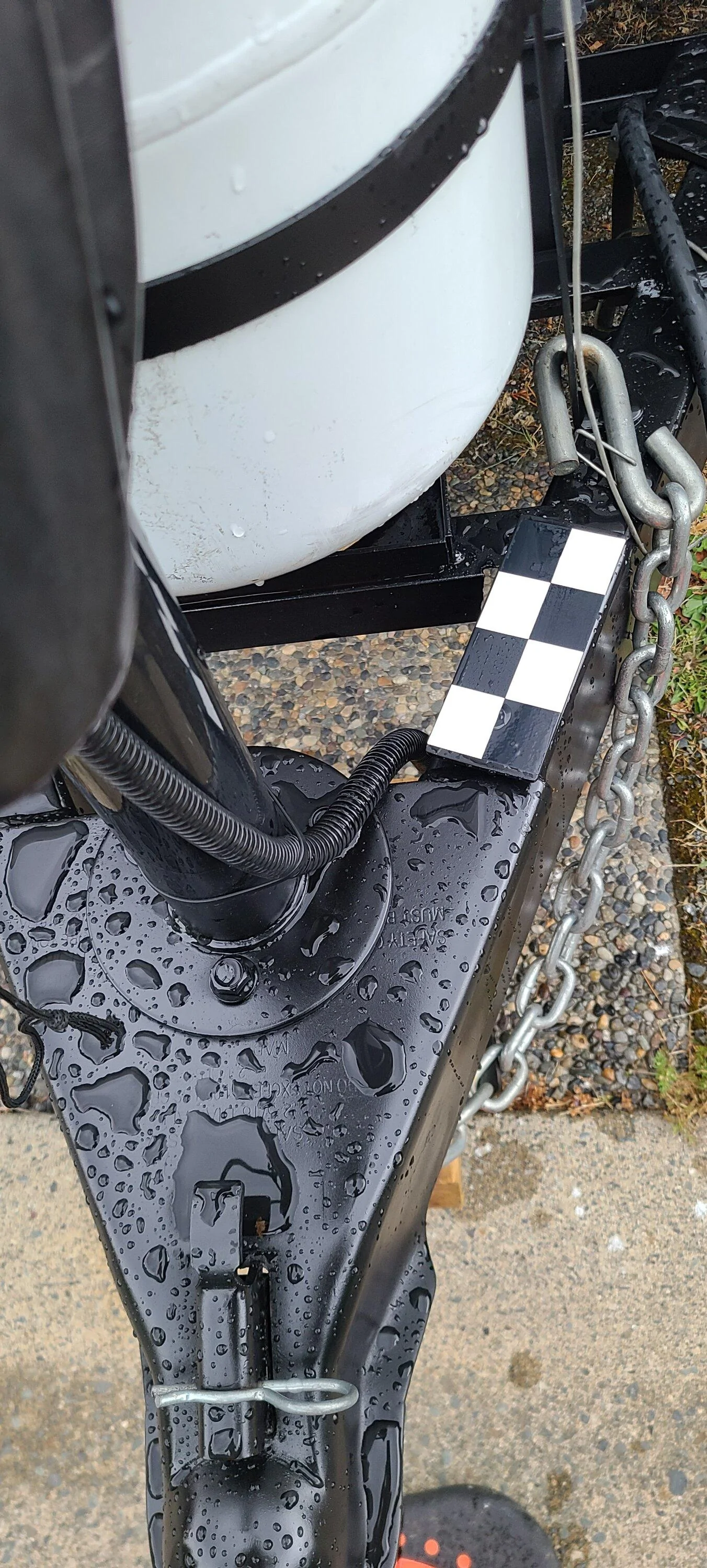

Yes you would need to attach a decal as well to the rental. Or attach the decal tosomething else that can be temporarily attached.
I used a 2" strip of aluminum for my decal so it would have a flat surface, as there were many welds on top that interfered.
Once you did that though, a few measurements are all thats needed to setup the trailer, but now you need to calibrate in a parking lot...if you had the rental for a day prior to the trip then that might work?
Ford F-150 Lightning Pro trailer assist on random trailers is impossible 20230725_075825

This ^^^
Mount decal on magnet. Stick magnet to trailer.
Mount decal to piece of plastic, then use clear tape to attach to trailer.
Not hard.

both good ideas - I like the magnet option - easily detach and add to any trailer you want to tow... I have two campers - this would be a good idea for those, too... even though I have several stickers...so, .....
but, in the end, I don't use ProTrailer assist, anyway, since I can back a trailer without it...oh well.
