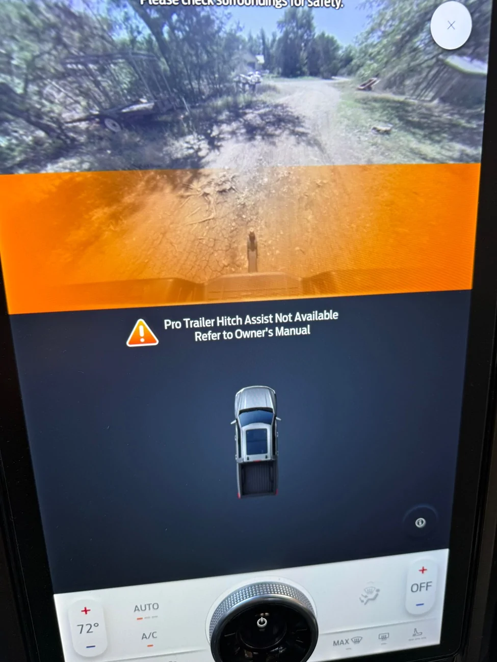

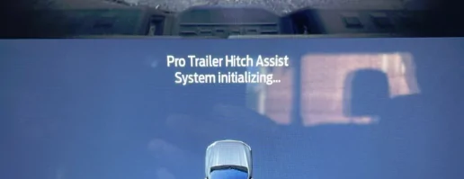

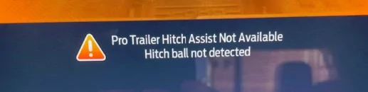

So...for my 2023 Lariat ER, I have for ABS: 760-03-01 is CCDA 11. We are focusing on the 3rd number, xxXx.
So, by looking at the hex to binary conversion, @Firn has a 9, which translates to 1001. I have a D, which translates to 1101. The order goes: AFS (AFS) • CTA (CTA) • PIB (PIB) • AutoHitch (AH).
If I assume that @Firn 2023 Pro does not have cross traffic assist (CTA) while a 2023 Lariat does, then D is correct. Thoughts from the team?
I am not making any changes and will attempt to connect to my travel trailer when it is not in a storage garage. When I tried it before, it was in the garage and did not work.

That seems correct to me too. Make sure any DTCs are cleared for the reverse brake assist, before trying also.
I made changes last night and it didn’t work, so I changed things back. Then my reverse brake assist didn’t work until I cleared the DTCs. I’m wondering if I had cleared them, then tried the hitch assist if it would have worked correctly.
I will try again tonight.
