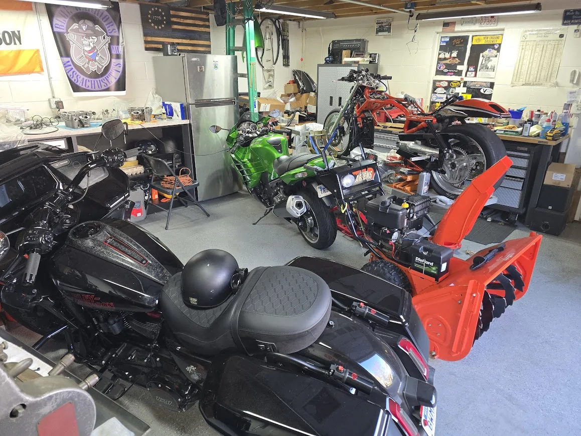

Yesterday, I needed to get the Snow Blower out of my trailer where it lives through the non winter months.
Installed the hitch, lined up my truck and tapped the Pro Trailer button to see if it would give me assistance, no luck, only wanted to have me do a calibration drive, (ie. introduce a new trailer profile) since I had previously deleted this trailers profile in previous debugging tests.
I suspect that even when I complete the trailer training routine that it'll not offer to do a hitch assist routine, it'll only do the back-up assist process for parking an already attached trailer.
Maybe there are manual updates I could make with FDRS and the recently acquired programming tool??
