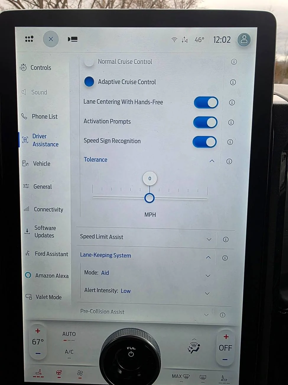

I spent the better part of yesterday getting all my modules up to date with FDRS.
I did the 3 hour IPMA last night. Now I no longer have the lane centering with adaptive cruise control.(The white hands on the steering wheel never appear in the top left of the cluster)
It's turned on via the screen control. There are no dtcs stored.
I know the IPMA is working as lane keep will still ping pong me between the lines.
I am thinking this is a coding issue on the module.
Should I load the as built data from Ford via Foescan?
Does anyone have the Blue Cruise 1.4 coding to enable it? Maybe the new firmware needs new coding?

Were you wearing your seat belt?

That is new behavior with the update.
Before lane centering with adaptive cruise control engaged with or without a seatbelt being buckled. Now it will not engage lane centering with cruise control without the driver seat belt being buckled .

This is a very well known issue (added feature?) for this IPMA update. I know it's documented here but if you have 30 minutes to kill, start over at the ICE forum.
https://www.f150gen14.com/forum/threads/ecu-module-programming-guide-using-fdrs.8249/post-570293
TLDR; Original premise was this IPMA update was bad because a few people saw that lane centering was broke. Turns out Ford added the feature (bug?) that seat belt is needed for BC.
As far as overriding this, you'll have to read the rest of that thread as I don't recall if that's possible.

It's not. It's hard coded in there.
