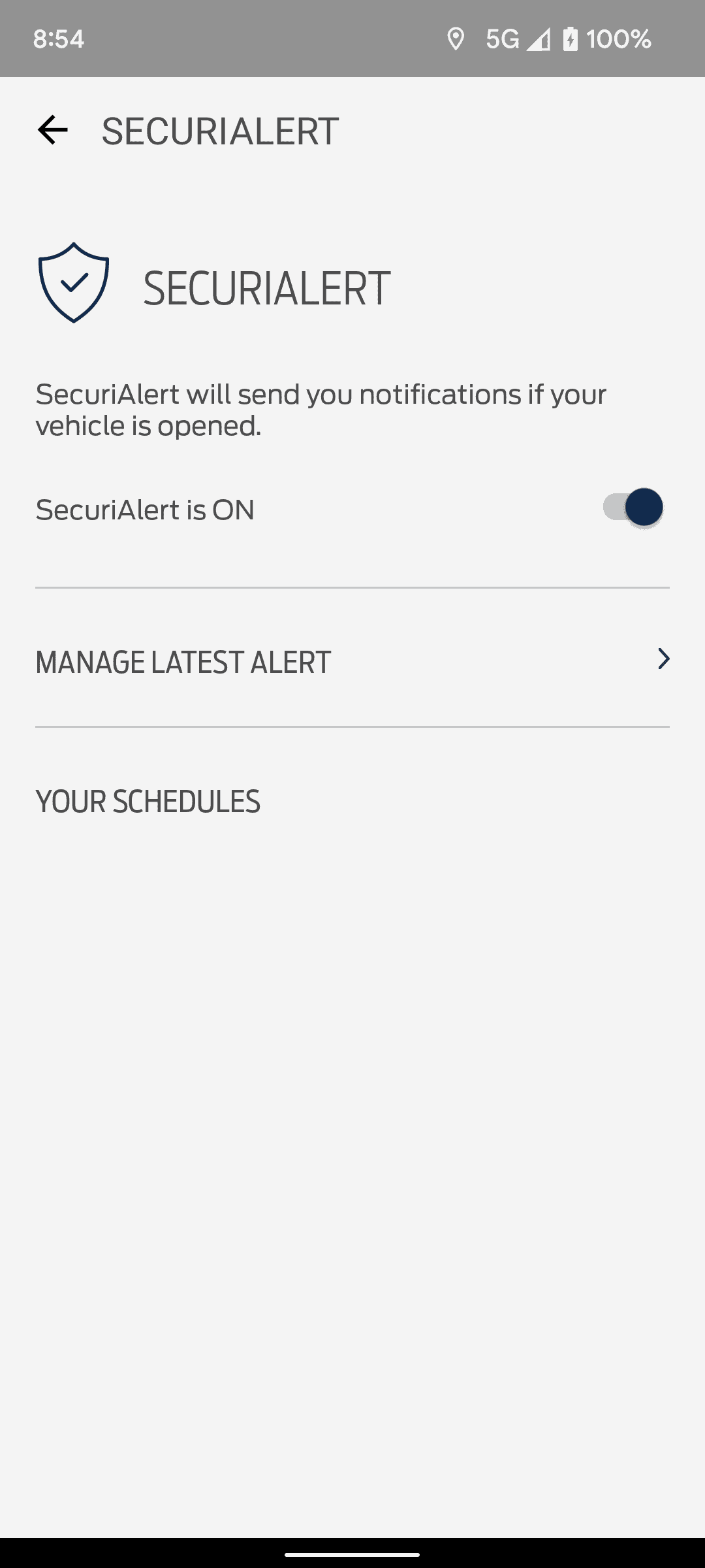

Pixel 6 running Android 12 and FordPass version 4.12.1 has never (since Dec '21 purchase) had a button to create a SecuriAlert schedule, so I've never used the feature. I've looked and looked and no way to create a schedule. Manually turning it on and off seems to work, so I suppose I'd use it if leaving the truck in the airport parking lot for a few days or something, but since scheduling (eg to auto activate while sleeping) has never worked I've chalked it up as another half-baked feature of the truck.
Anyway, OP, it sounds to me like an issue with the FordPass app version on the phone, not the truck-side of things.
Ford F-150 Lightning no SecuriAlert? Screenshot_20220323-085439

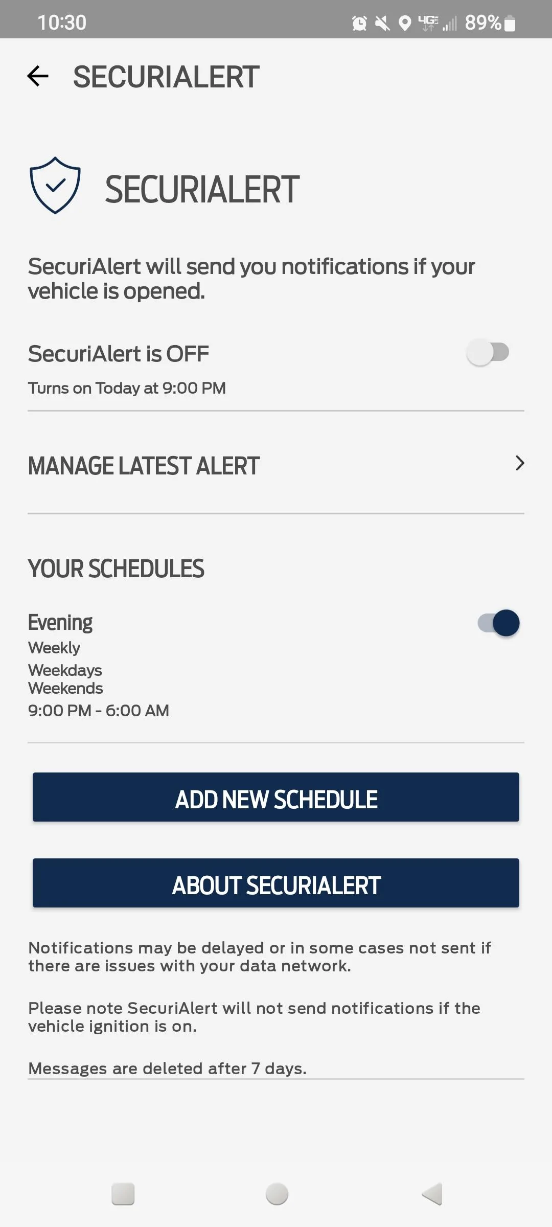

S21 Ultra running Android 12:
Ford F-150 Lightning no SecuriAlert? Screenshot_20220323-103007_FordPass
We must have different software in the truck? I have a 22 so maybe the 21's software hasn't caught up to allow the scheduling? Hope that it is an update, it really makes using this feature easy.
