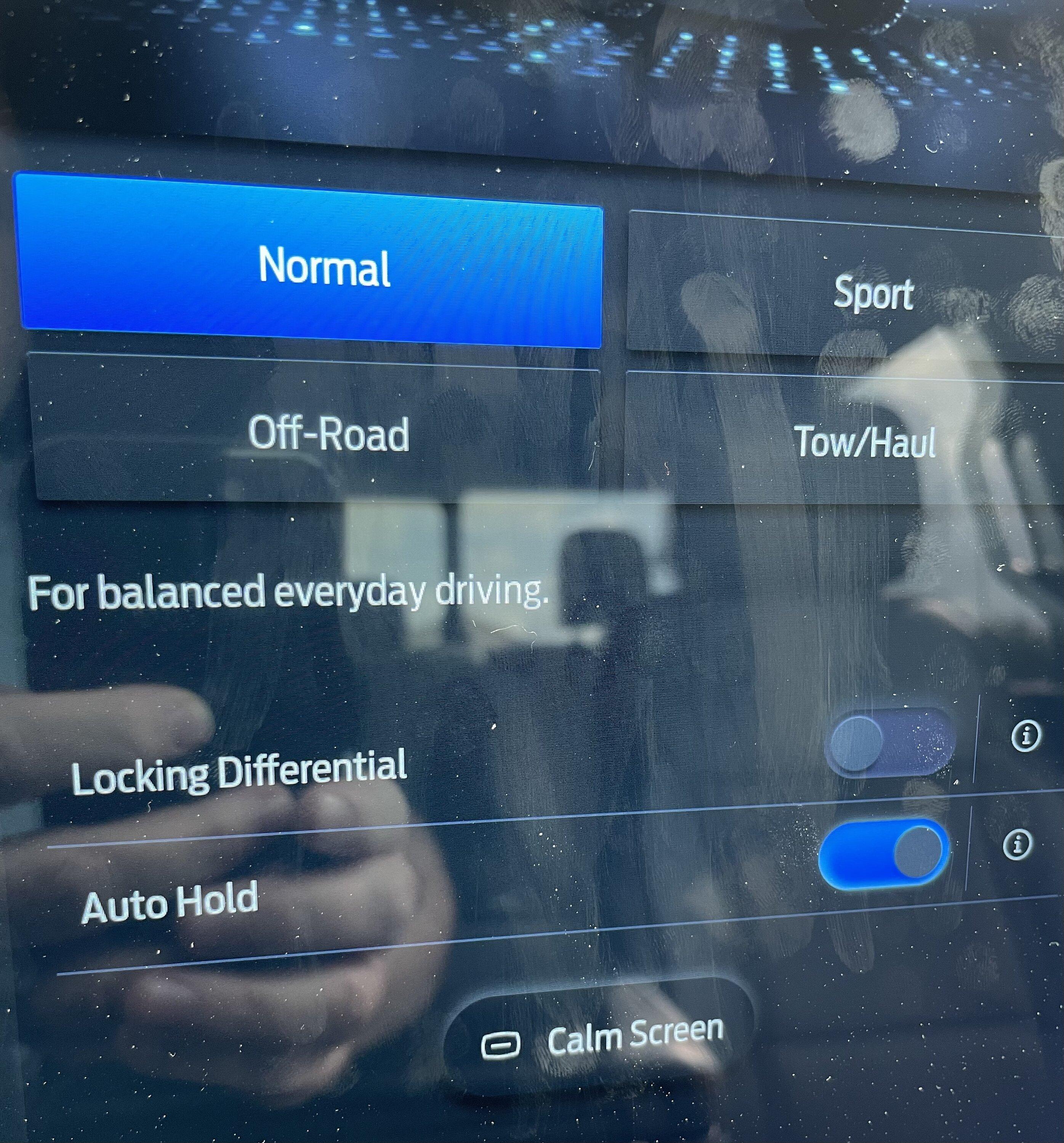

Well - after prompting by a Ford insider, I've confirmed my disappearing option for 1PD is because I made some changes with Forscan. I don't know which ones yet, but I restored a couple of modules to their original configuration and it came back. I put my changes back in and it disappeared again.
So it was on me. I'll check in with the Forscan folks and confirm I didn't do something wrong or that changing some of the options I changed also caused this odd behavior.
3,749
4,809
Note - this is an old thread I'm updating just for tracking and to see if the same ever happens to anyone else. Note this is likely something I did and you shouldn't be worried that the same might happen to your screen. It is just a caution when using Forscan or any tool to update your truck.
My 1 Pedal drive never returned. It had to be a bit I flipped in Forscan that I could never trace back in '22. At that time I restored all of my backup files and it came back, duplicated the 3 or 4 Forscan changes many others in this forum made and my 1 pedal disappeared again. So I've just left it like that.
Today Power-UP 6.3.0 made a change to that screen and added "Auto Hold". I hoped my 1 Pedal would come back, but it didn't. I like the feature, so nothing is lost, but I thought an update might bring it back some day.
This is my latest update.

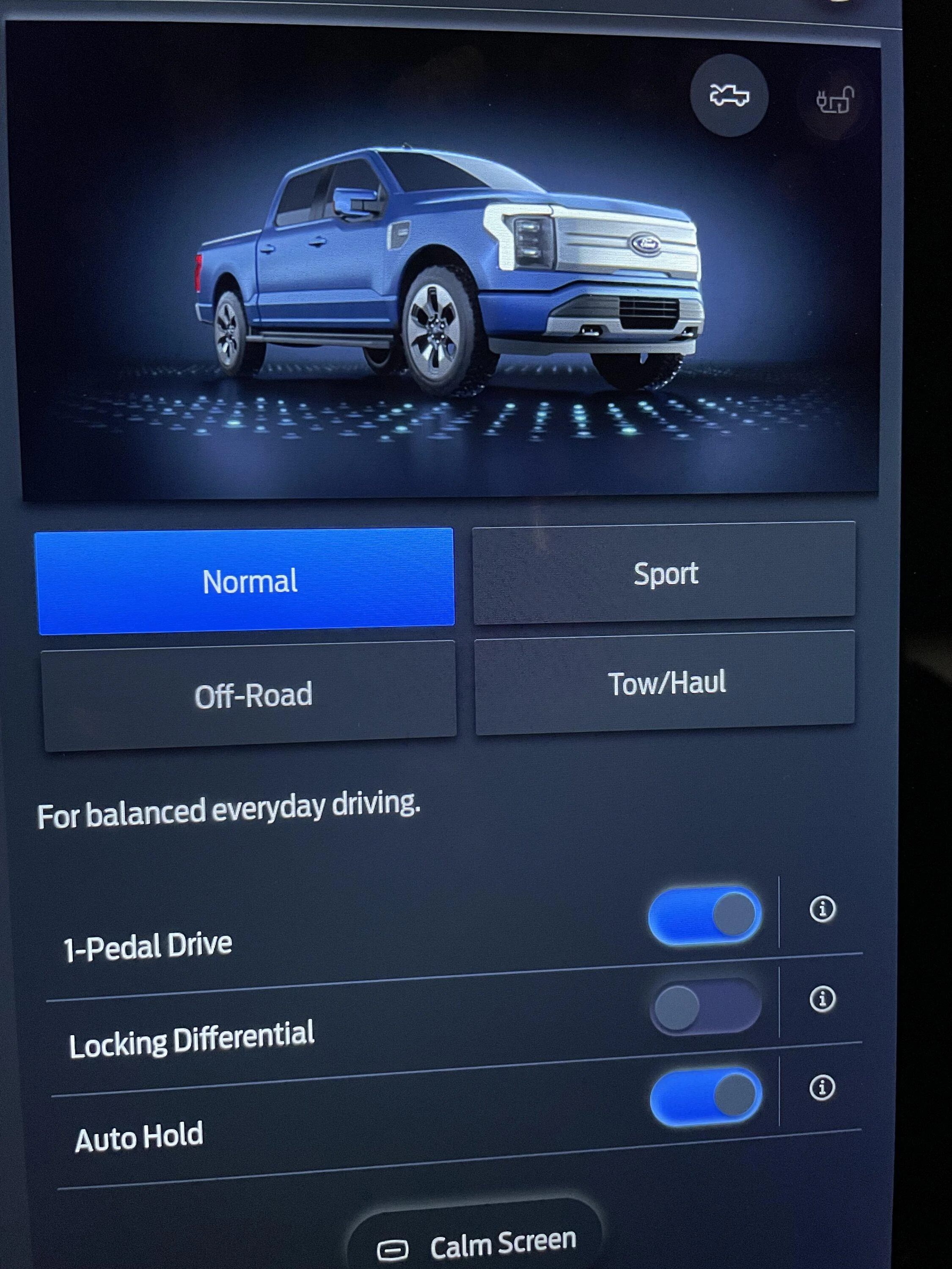

Well I now have my "One Pedal Drive" screen option back.
Turns out I didn't fat finger a bit in Forscan, but it is because I had made changes to turn on Cameras At Speed which our trucks already have. One of the bits which I thought was turning Cameras on, actually turned off my option to have "One Pedal Drive" displayed on the screen.
I fired up Forscan this afternoon and used it in GUI mode which isn't the preferred mode. I made a backup of my APIM settings. Opened the APIM area and the first option is to "Enable" One Pedal Drive. I made the change to enable and saved it then cycled the ignition and my setting was back. I made another backup of the settings, compared the two and the bit it flipped back was one I had made for the cameras at speed.
So after a year - my mistake is corrected.

Did you ever find a way to have 1PD and Cameras at Speed both enabled?
3,749
4,809
No - I can confirm that indeed the change for Cameras at Speed wipes it out. We tried on @LUXMAN 's truck and 1 Pedal disappeared immediately. The changes are not compatible.

I was able to enable both Camera at Speed and 1PD. The trick is to enable it in Forscan using the regular mode, not asBuilt.
