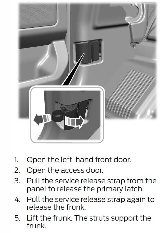

Frunk: thee is a manual pull in the truck:
1. Open the left-hand front door.
2. Open the access door.
3. Pull the service release strap from the
panel to release the primary latch.
4. Pull the service release strap again to
release the frunk.
5. Lift the frunk. The struts support the
frunk.
Ford F-150 Lightning Opening the tailgate or front trunk if the 12v battery is dead? open frunk manually from inside
release the frunk.
frunk.

I had seen the manual release for the trunk, (I figured it was either that or for the tailgate) but after a little messing with it didn't get any result (I didn't want to get too aggressive and break anything), and I didn't feel like taking a screen-time deep-dive while sitting in the truck to figure it out at that moment. (I'd much prefer a paper manual that I can read by kerosene light while sitting in my rocking chair.) "Soon" I will spend some quality time sitting in the truck reading the manual on the screen. 😩
