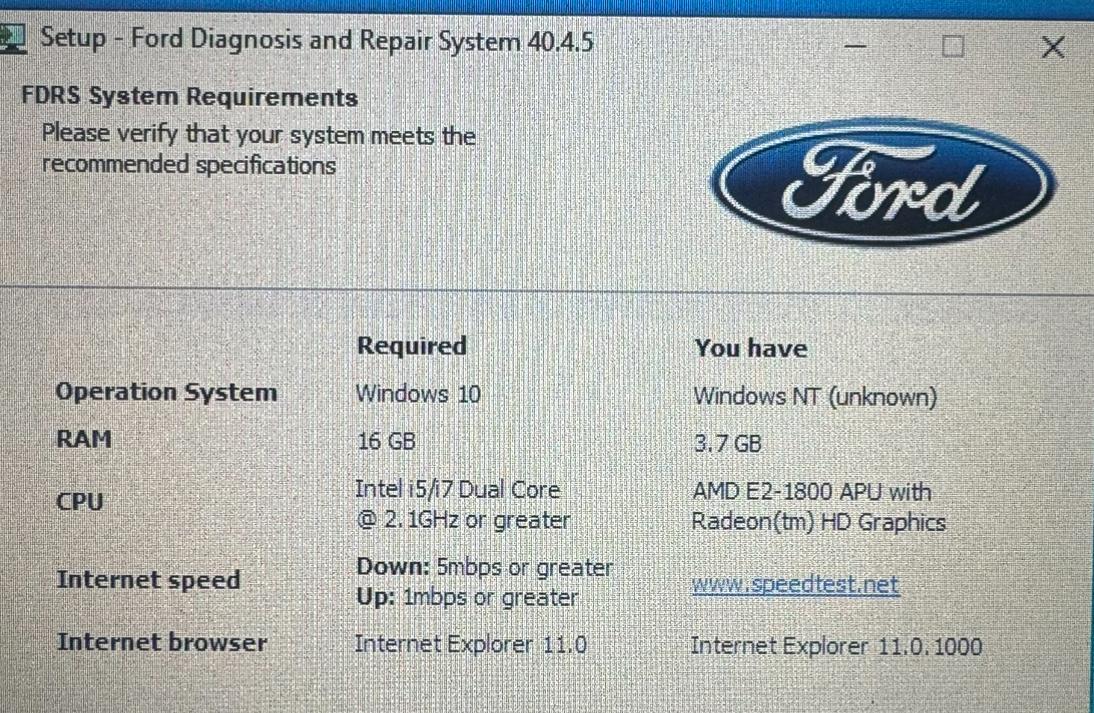

Plus now I just discovered per FDRS software my current laptop needs replaced as not meeting the software system requirements. It’s always something…Time to buy new computer too now before I can proceed….i’m computer shopping now. lol ?

Yep been using MacBooks past 10 +|- years and have let all my windows machines I guess get out of date. Between iPhones and iPads just don’t use windows systems much these days. I’m shopping now for a decent Laptop with 16gb ram, decent ssd drive and touch screen or not have not decided yet.

Good to know thanks. Glad you averted any tragedy. I’m ordering new laptop today before I can proceed. FDRS says only lists INTEL processor, I’m an AMD fan usually. Out of curiosity what is your laptops processor you are using..? So I might have to switch back to the INTEL camp lol.
