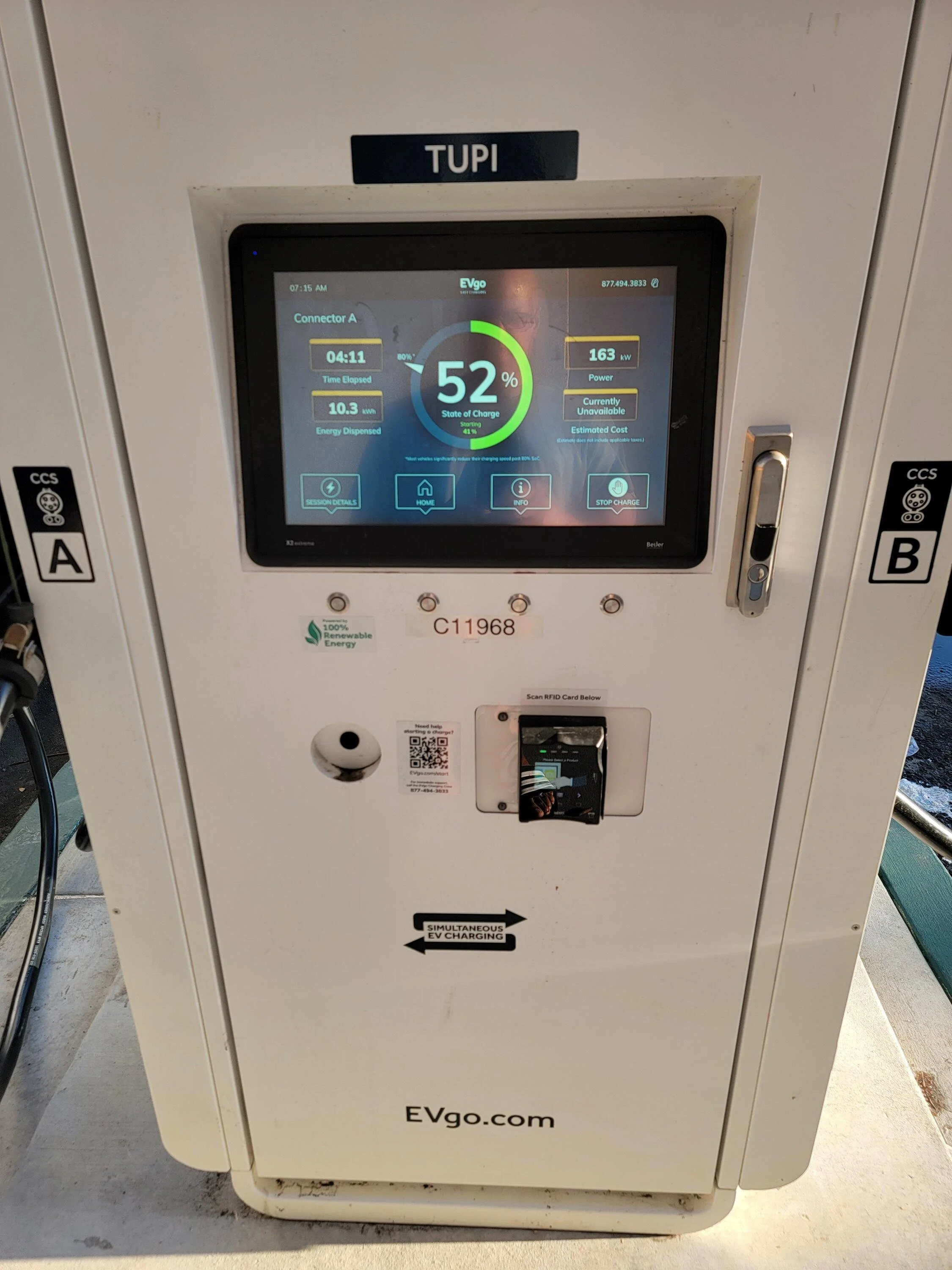

The SR Lightning maxes out at 120 kW, and that's only at the start of charging if SOC is low. So it's not an EA issue, it's as designed. See https://www.ford.com/support/how-to...ightning-charging-frequently-asked-questions/, which says this:
Can I charge at a 350kW charge station?
Yes. Most Electrify America DC fast chargers can deliver up to 350kW of power, but your Ford all-electric vehicle will only accept up to 120kW or 155kW, depending on if you have the standard-range or extended-range battery, respectively.
I’ve seen as high as 178kW charging my ‘23 XLT SR on a 350kW EA. My understanding is that charging kW in our Lightnings is determined by available current, due to the relatively low pack voltage (mid-300V). EA 150kW units max at 350A (345V x 350A = 121kW charging) while EA 350kW units can output 500A (345V x 500A = 173kW charging). So, while it’s true that our Lightnings can’t charge at 350kW, we will always get higher max charging kW from a 350kW (500A) unit than a 150kW (350A) unit.
