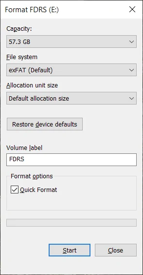

You will need a J2534 pass-through interface that connects FDRS to your truck. I used the VXDIAG VCX Nano. Its a cheaper version of more expensive interface but gets the job done! You can read details how to set it up to work with FDRS here.
The APIM update process is rather easy. Connect your interface to your truck and laptop running FDRS, open FDRS, read VIN from vehicle. Once done, click on Toolbox tab. You should see all modules on your left hand side. Click on APIM (if its green), on the right-hand side you should see all options you can perform on this module. If there is update available, you should see it in this section. Once you initiate the APIM update, just follow the on-screen instructions, its pretty straight forward from there!

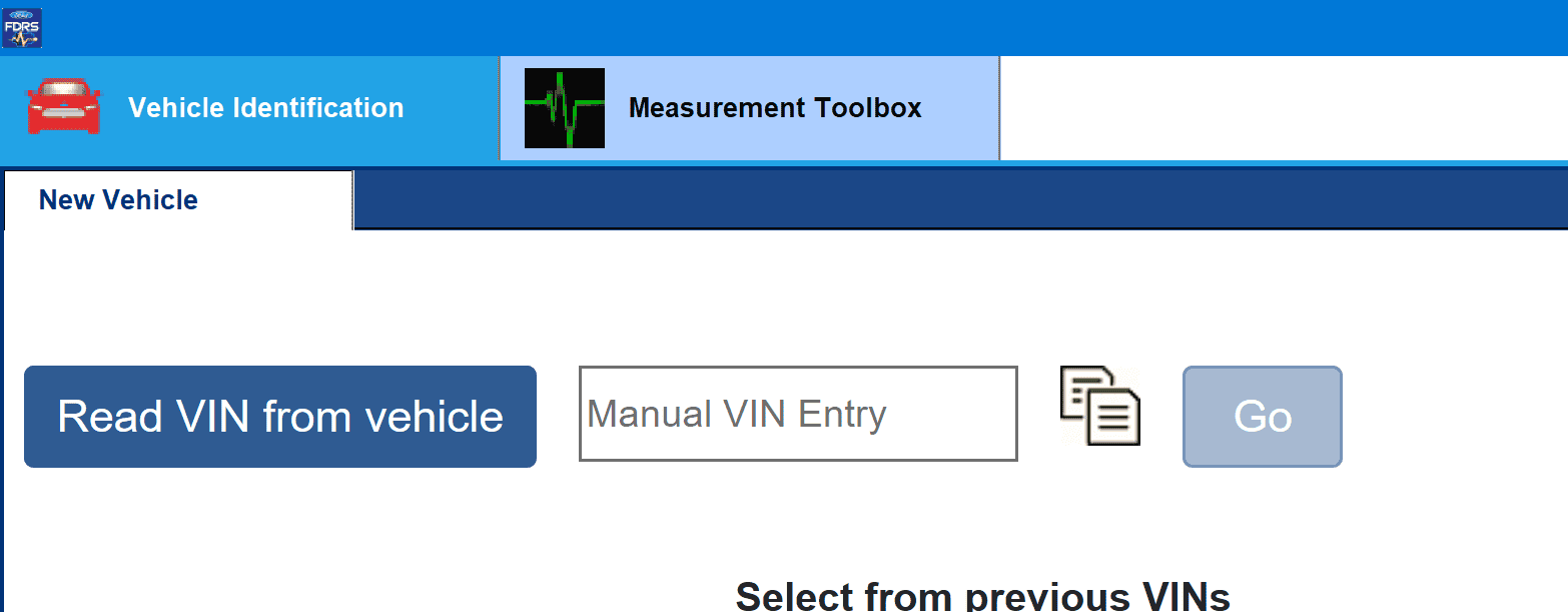

It’s been a while since I last used any official Ford diag utilities. I used to have access to borrow a VCM II. On older versions there was/is a way to bypass VIN checks by attempting it multiple times with no network connection. After X number of timeouts it would prompt for manual VIN input (at least for the PCM). I’m not sure if that still applies in this situation.
For some reason I didn’t think the VCX Nano was J2534-2 compliant, but there’s so many clone devices out there I’ll have another look.
Just to clarify the manual process. Is FRDS required the whole way through?
I was optimistic we could cheat by timing out the VIN checks on your vehicle, use my VIN when it prompts for manual entry instead, download the files to local storage, then share them over a cloud service so I can upload them to my APIM via USB without the need to rent FRDS and buy VCM III clone.

FDRS offers an option for manual VIN entry:
Ford F-150 Lightning Power-Up 2.3.0 OTA rolling out 1642087245226
Never tried that option though...
