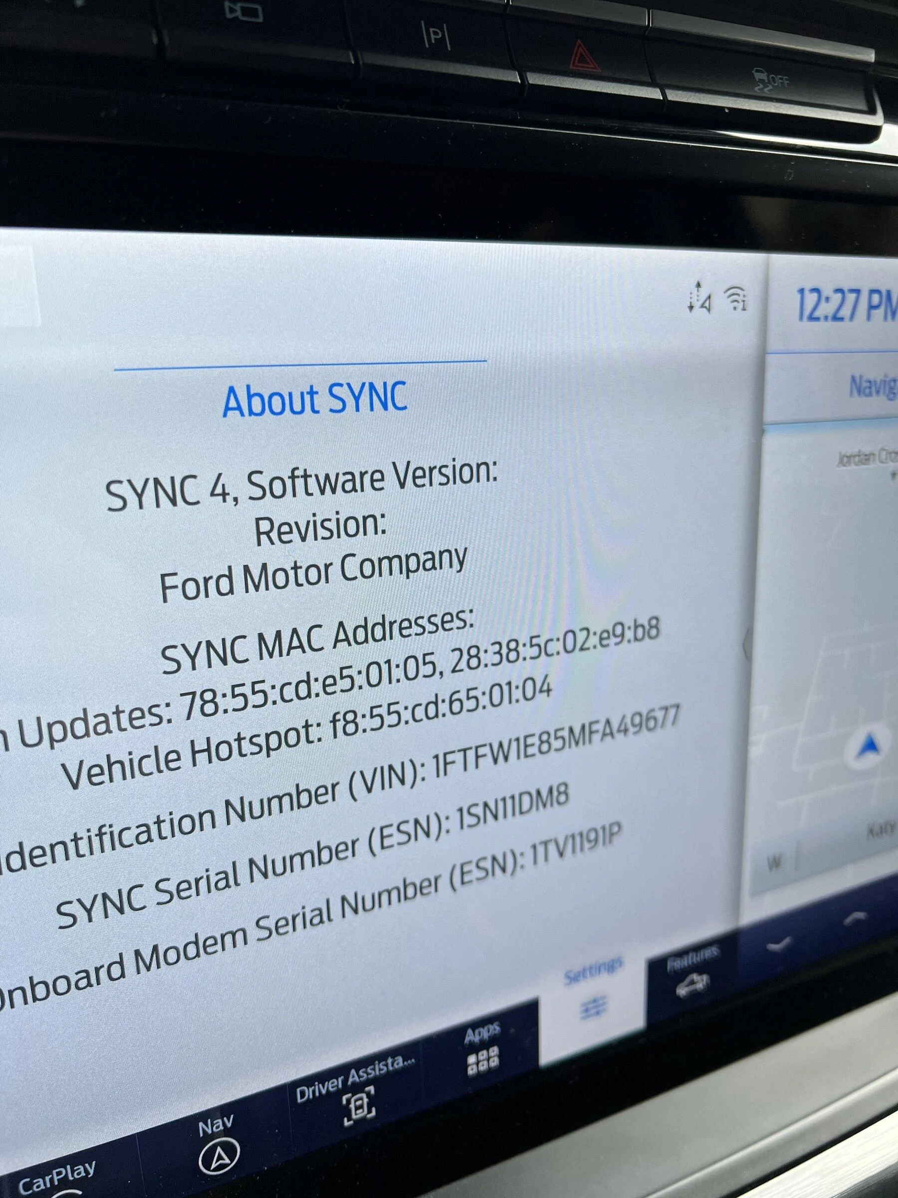

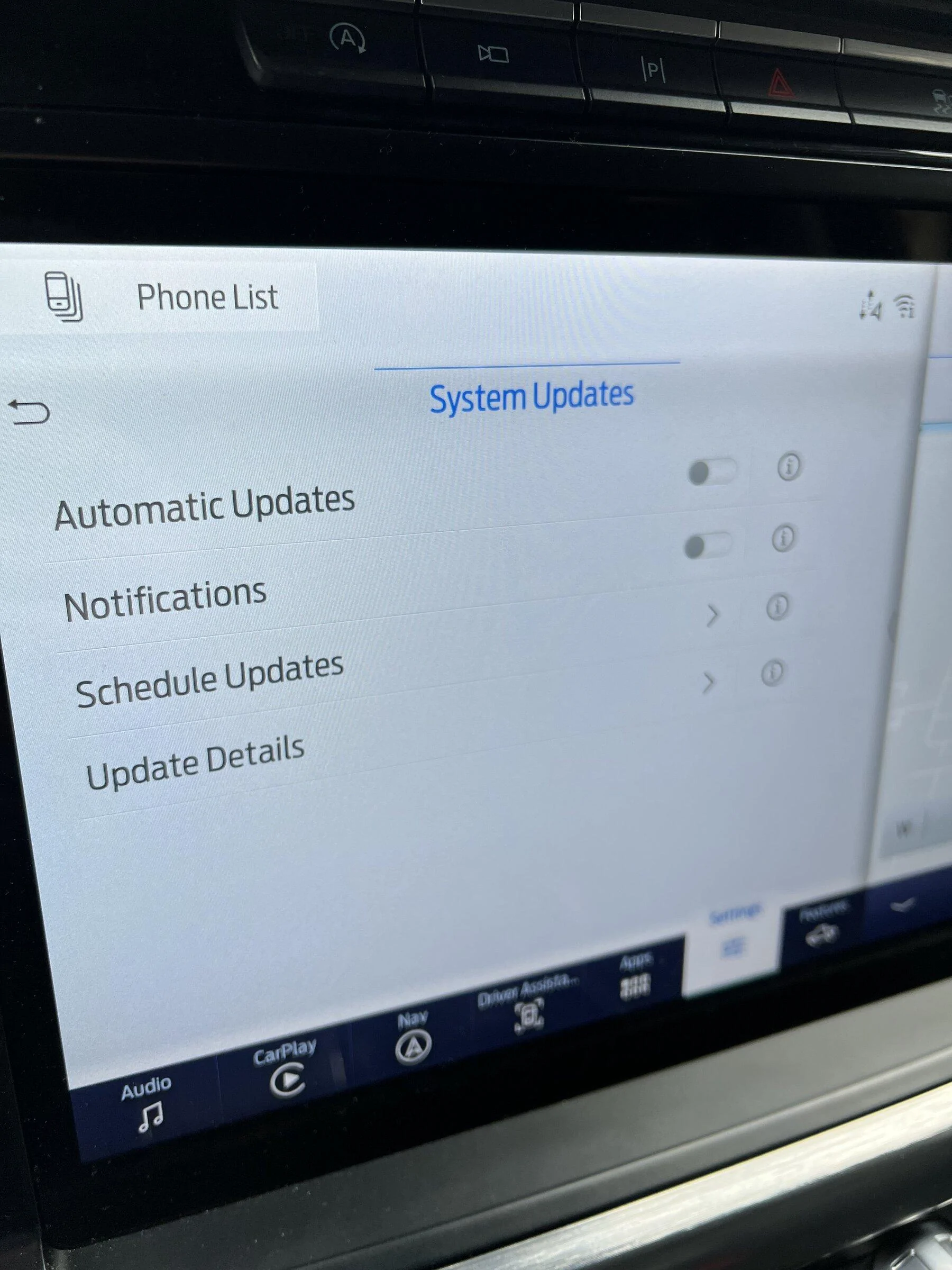

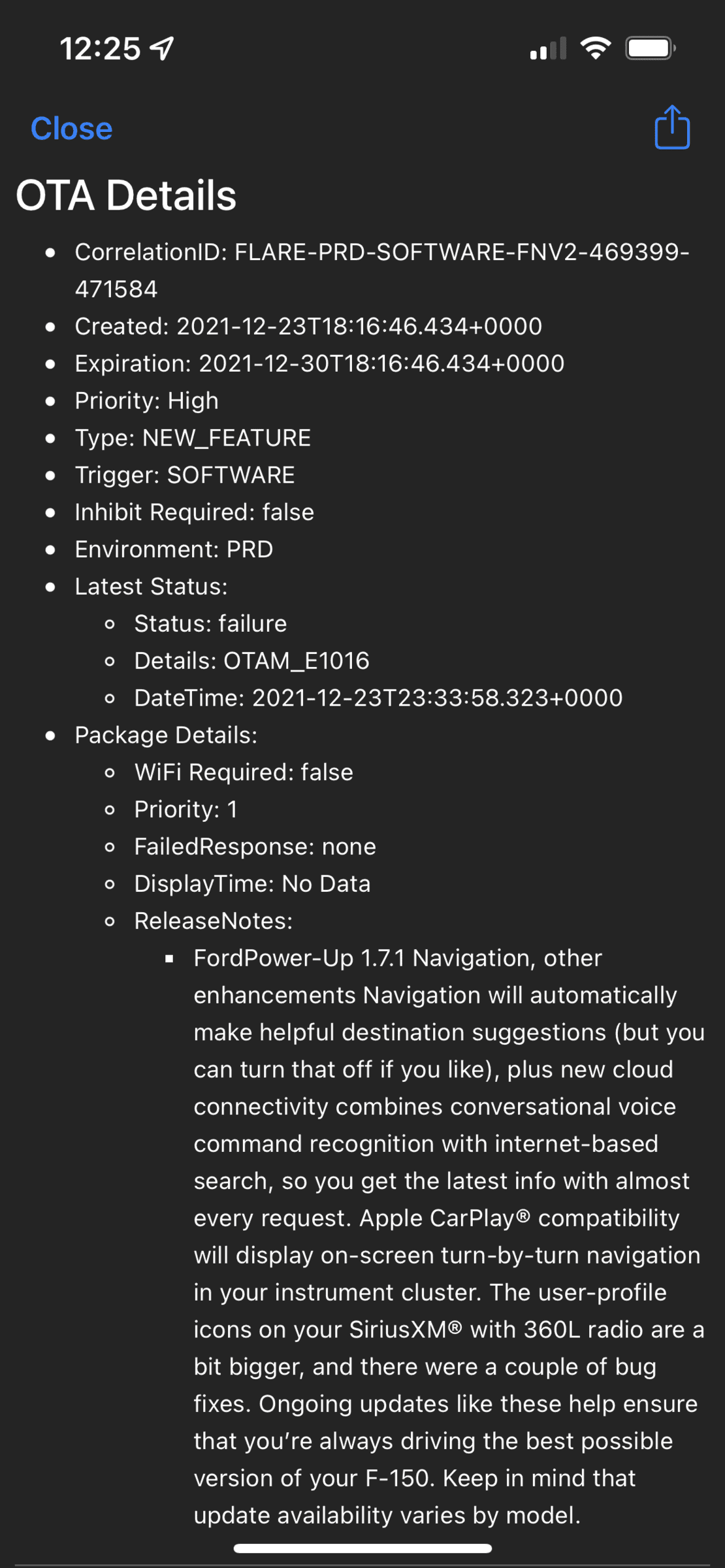

Well, shit. Then maybe I'm stuck in some weird APIM purgatory then. I still can't see my revision, can't turn on auto updates, and tonesto's tool still reports 1.7.1 as failed.
Exact same as you, no updaets, and auto updates cannot be switched on.
