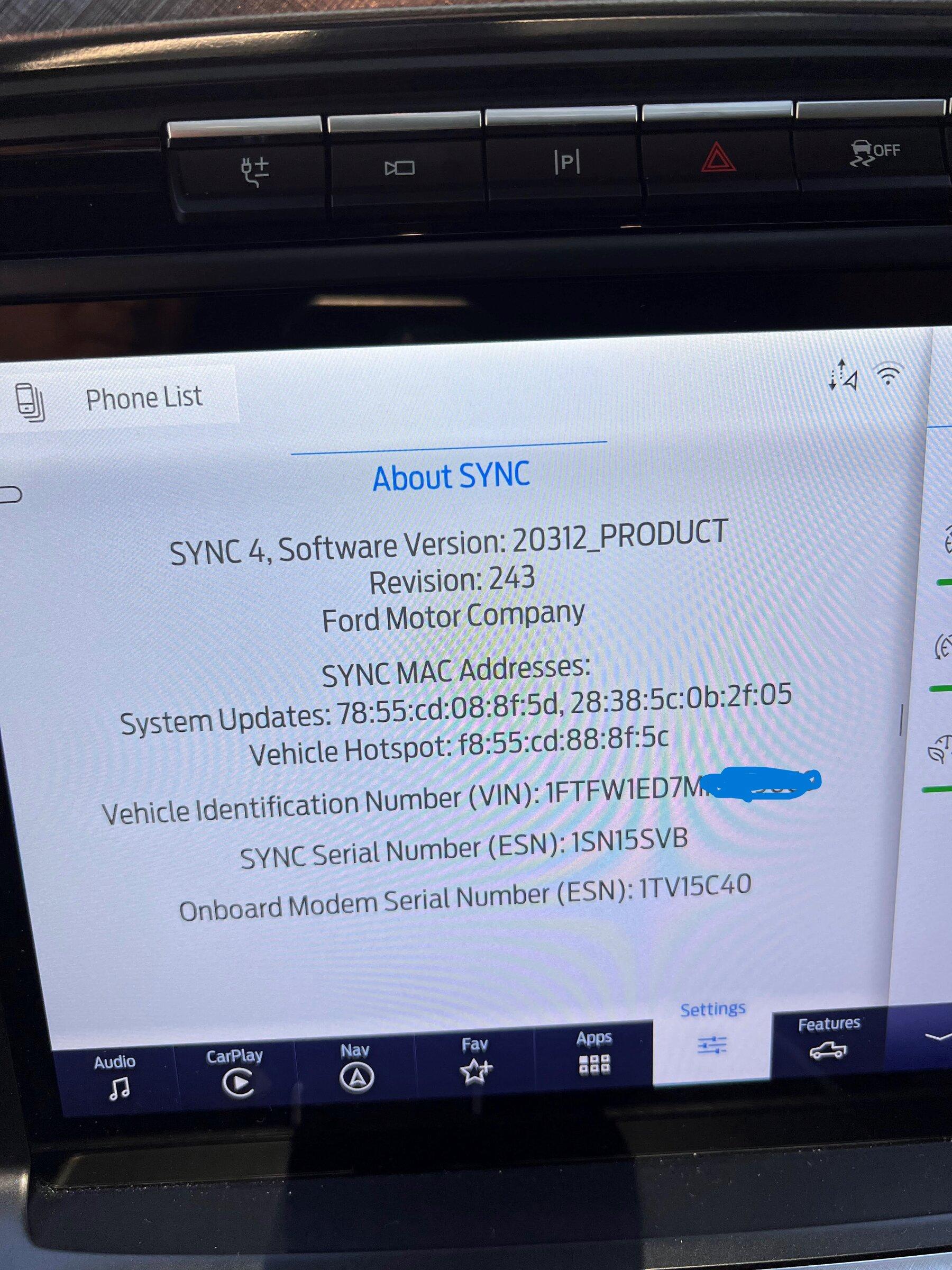

So this may sound like a dumb question but how do I know what update version I just got?
There are no numbers to say what version I have that I can see.

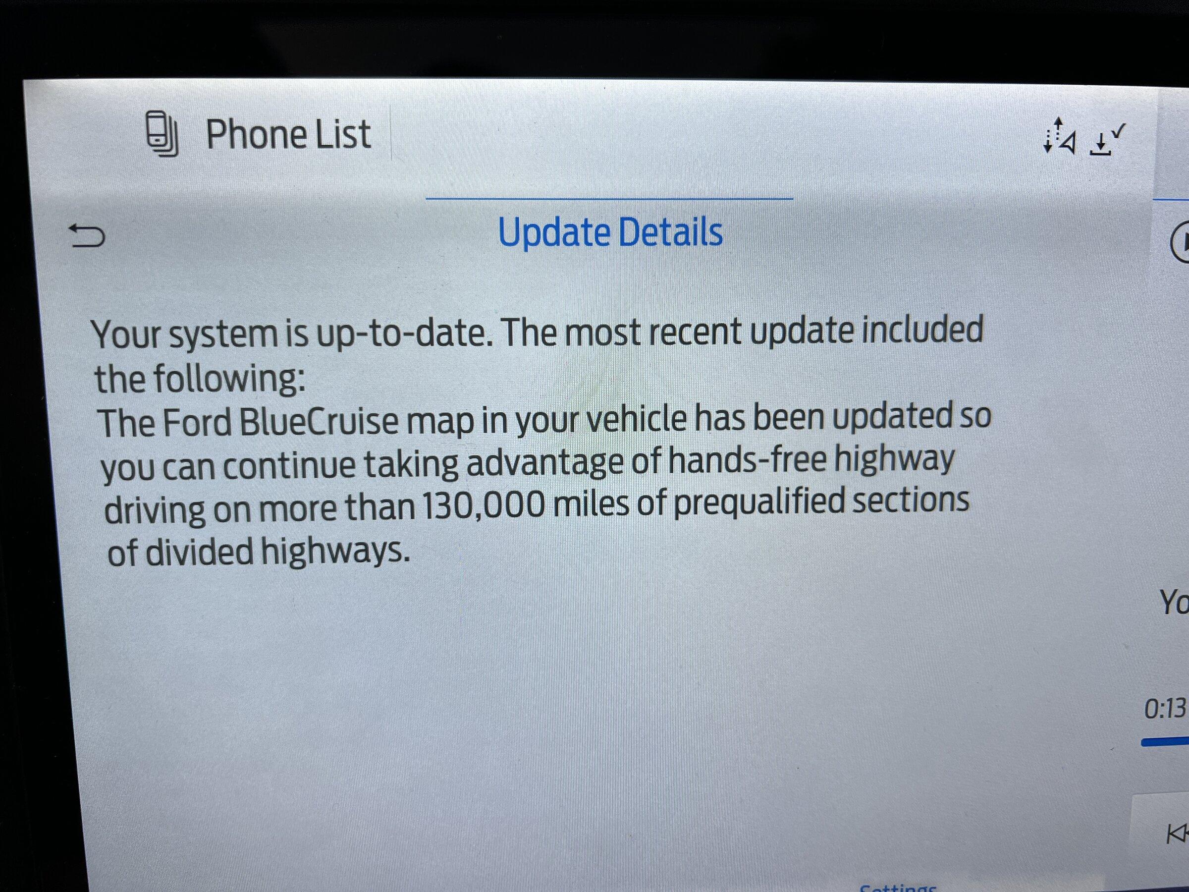

You are a job 2 truck. The update you just got was for bluecruise only. The only OTA sent out so far for JOB 2 is the one you just got. The apim software version is only referring to the apim. That version was the version shipping around july/august.. then 21223 started in October or so

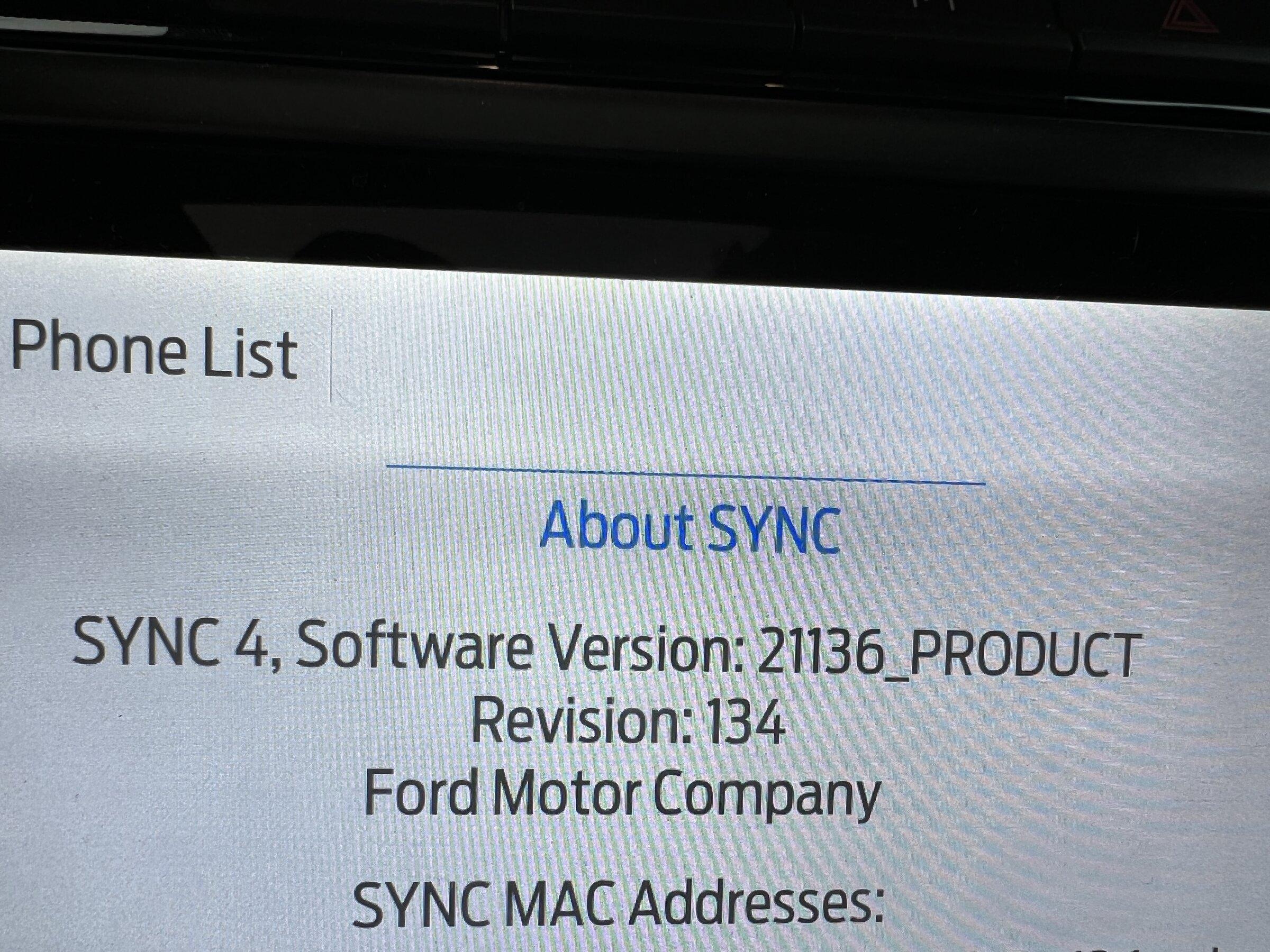

  • OTA 1.7.0 The PowerGenerator UI Element changed according to the change log. I didn’t see the change take effect until I hard reset Sync 4 twice in consecutive order even though the System version indicated 21146 Rev 145 the entire time.

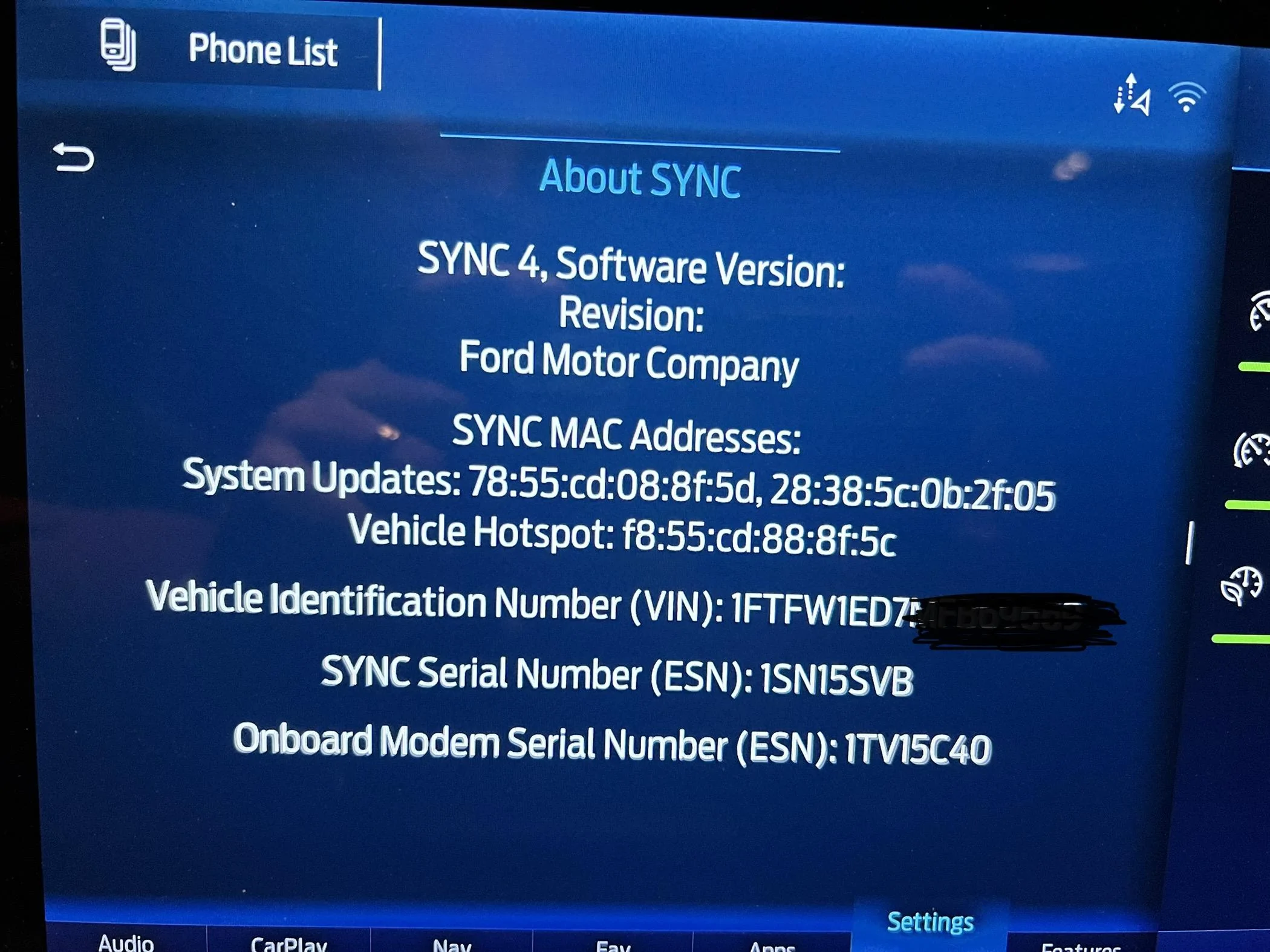

I guess I am not alone. Took my car to the dealer 2 months ago with the gray-out update and no info, they tried to update at the dealer with no luck, they ordered "the module" and every week when I ask they are saying that is on backorder and they have no clue when will arrive.
Ford F-150 Lightning Power-Up 2.3.0 OTA rolling out IMG-8963
After I took the car home from the dealer, I checked and all the info was present and the auto-update button toggled again. I checked for software update and nothing was available to update, the next day the screen went back to no info and gray-out, so go figure.

TSB 21-2117 tells them how to fix this issue. I have done it myself successfully but I manually updated the software after the TSB in FDRS rather than wait and see what OTA would do.
