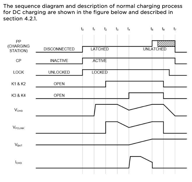

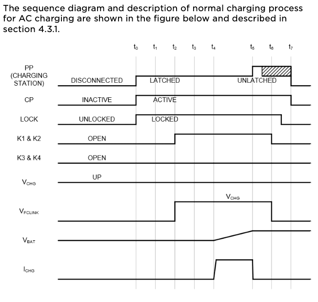

The question on this thread is the opposite condition - sending DC from the fast charger to the AC input of the onboard charger. This condition may also be covered in that standard. I have to believe this possibility has been accounted for.
Both conditions and AC/DC differentiation are covered in the linked appendix and Section 4 of the original NACS document.
Added:
Ford F-150 Lightning Are J1772 AC contacts tolerant of HV DC? Screenshot 2024-02-23 at 9.55.45 AM
Ford F-150 Lightning Are J1772 AC contacts tolerant of HV DC? Screenshot 2024-02-23 at 9.55.55 AM
K3 and K4 are contactors used to control the connection of the vehicle battery to the charging station. K3 and K4 are closed during DC charging and open during AC charging.

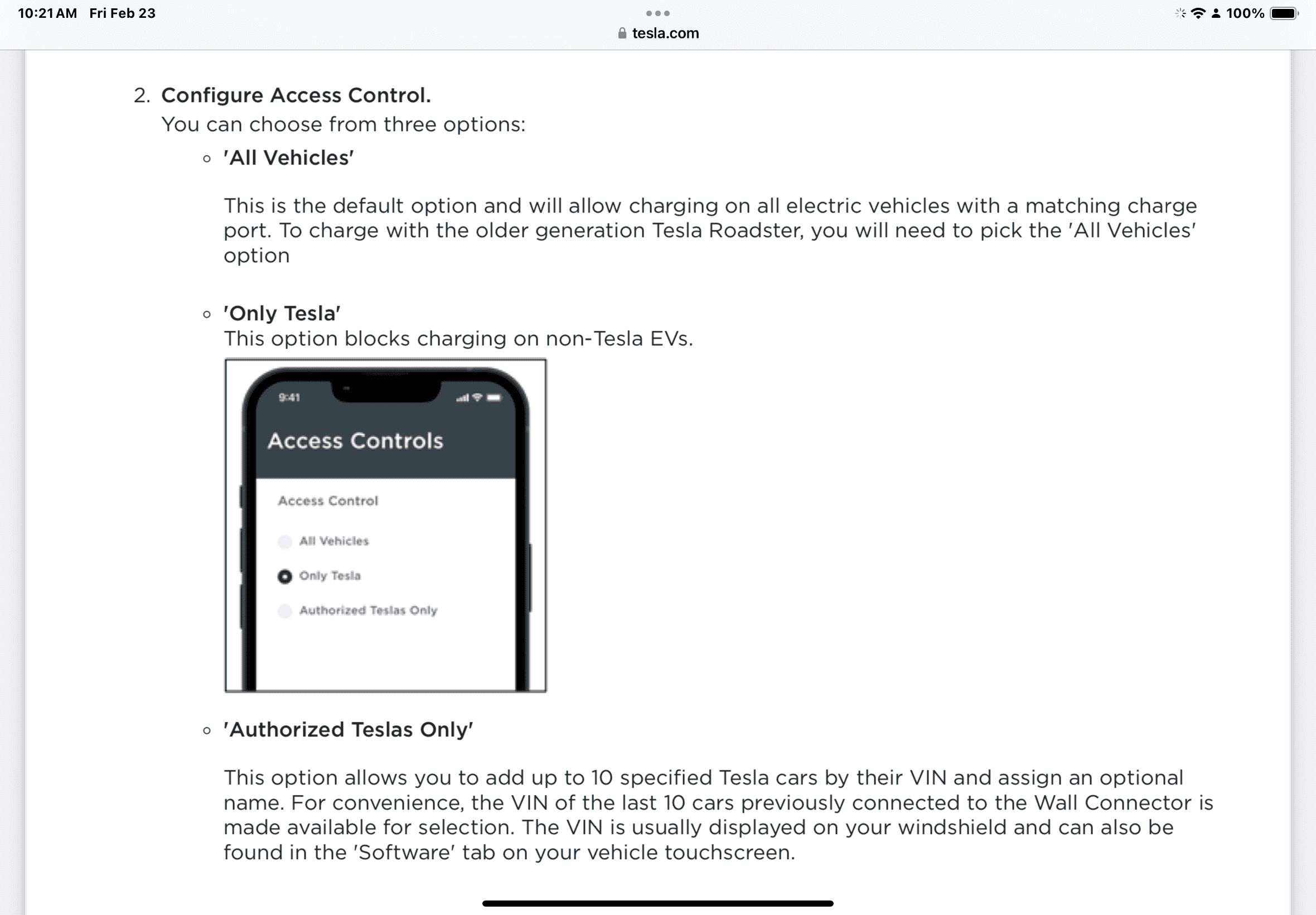

I have latest generation 3 Tesla chargers at 2 homes.
Commisioning set up offers 3 modes. All Vehicles, Only Tesla and ONLY Authorized Tesla vehicles by VIN number.
It sucks if someone set it up for only Tesla. I leave mine set to all vehicles. If I’m not home and someone needs an emergency charge they can use my Tesla charger. I even keep a Tesla to J1772 adaptor there if needed for other than Tesla EVs.
Our cabin is in a gated community in a very remote area of Florida. I helped out a Bolt driver who limped into the guard gate. The guard called me and I had the nice polite elderly lady come to my cabin and plug in for a few hours so she could get enough charge to get to the nearest DC fast charger.
We EV owners need to stick together.
