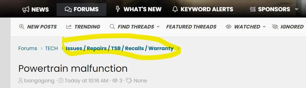

How do I get to issues?
240
16,853
19,179
Thank you. I`m reluctant to to go to dealer when truck is running fine. What will they muck up?
If you're using a desktop browser, you can click in the crumb links above the thread, your thread is now housed in Issues........., you can also use the search function to do a keyword search.
