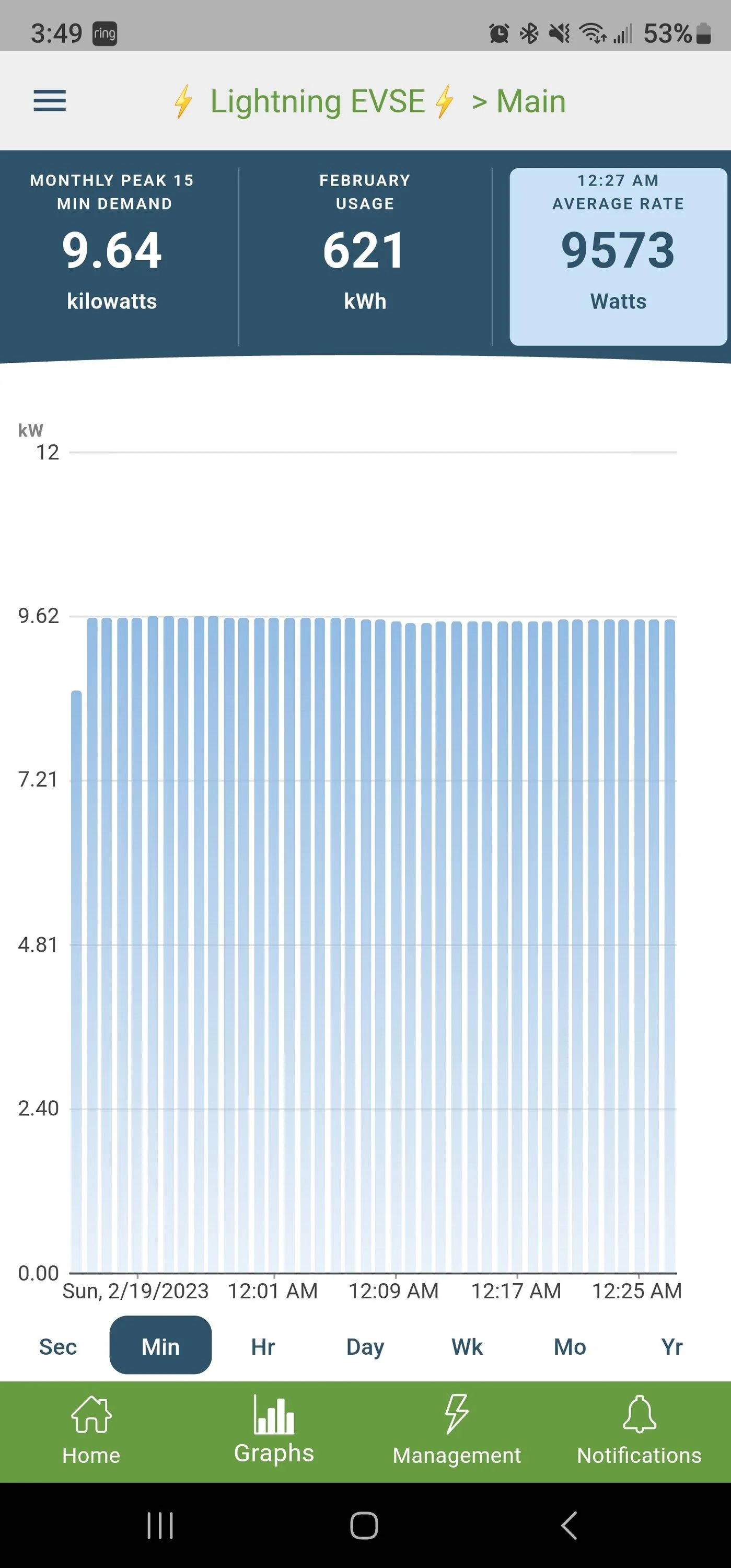

I get 9.6kW every time on my SR MY23 Pro with an Emporia charger at 40a. It might be your specific truck, but it's not all trucks.
