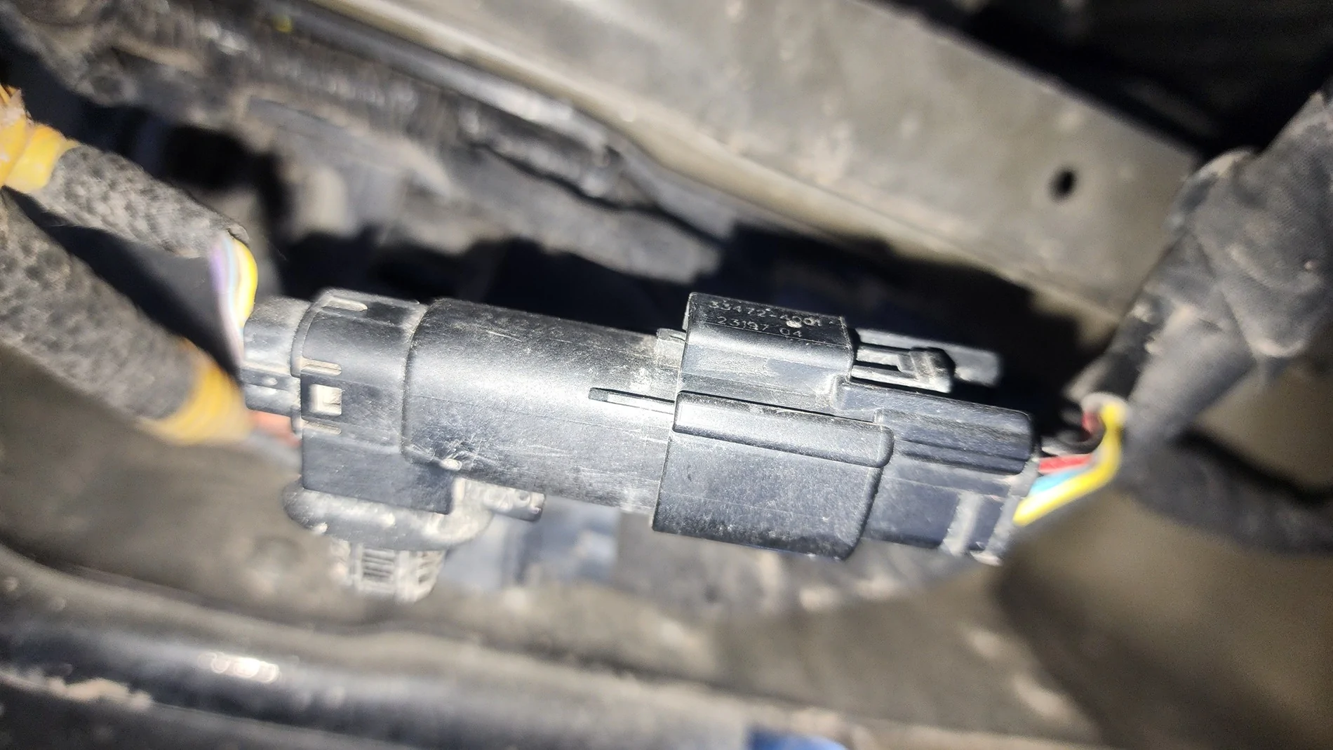

Hello guys. 2025 Flash. The frunk and cab power outlets work just fine. I went to use pro power for the first time yesterday and it didn't work in the bed. Got all the other settings figured and reserve on manual down to about zero. Checked and found the bed plugins (orange wire hanging from the box attached to the bed) were just hanging and possibly left that way after having the bed liner sprayed.
The main plug plugged in just fine like it is supposed.
However the communication plug with 4 small wires only goes in so far. Figured out that the white male and female connector parts stick out enough that the entire assembly won't slide in until the holding latch on top engages. However it does connect together far enough for the 4 flat pins inside the plug attached to the bumper to slide into the other plug.
When I try to turn on the bed power on the sync screen by touching the bed, it lights up for a momentarily and I get a message about dealer service required.
Only thing I haven't tried so far is to disconnect the battery ground for 5 minutes to reset the system.
If the plug ends up working I will have to tape it to hold it together.
Any ideas? Thanks.

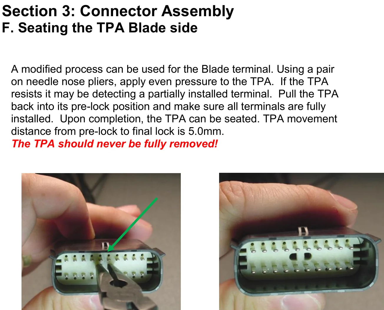

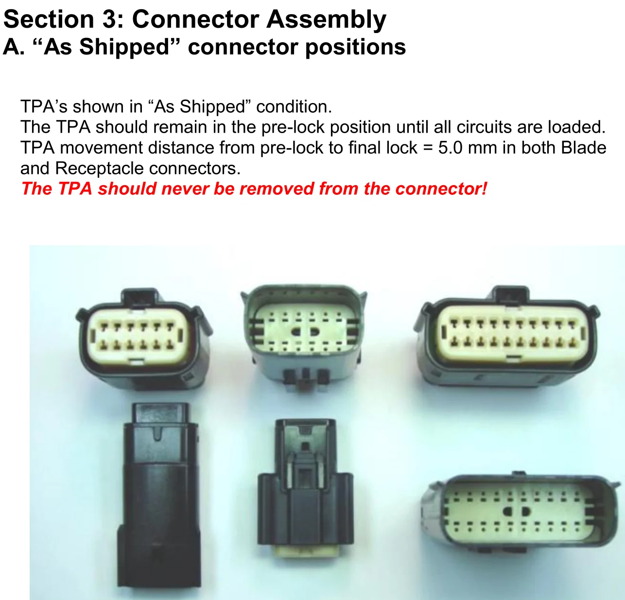

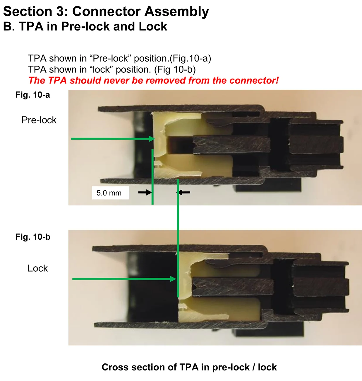

I've tried moving both white TPAs and they don't seem to move. Looking at your photo above, Except for being 4 pin, my connector coming from the bed box looks like the top left one with the white TPA just a little bit recessed like the one in the pic. Except for being 4 pin, my connector at the bumper looks like the top middle one with the white TPA recessed in about an inch like the one in the pic. The 4 pin TPAs are too small and don't have inside holes for needle nose pliers. I can get them plugged together until the white TPAs are touching but hard as I push the connectors don't move and I still have a ways, half inch or so, to go before the latch on top of the black parts of the connectors will engage. At one point I shorted across 2 of the pins and could see a small spark.
Tired Lizard
Gene
Jun 18, 2025
23 F150 XLT Powerboost, 22 Escape PHEV, 23 Bolt EUV
The male connector white TPA can take a Hard push on it when assembling the connectors from scratch.
I had to use needle nose pliers pushing very hard to get it to snap down 5mm.
The female TPA is just a little recessed when locked in.

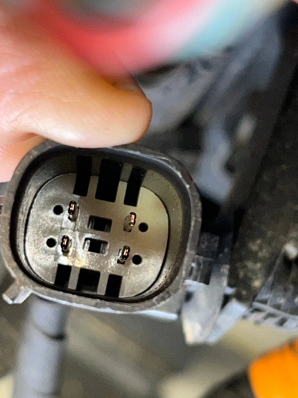

Ford F-150 Lightning Pro Power bed outlets not working: Fix#13 1781915028059-z2

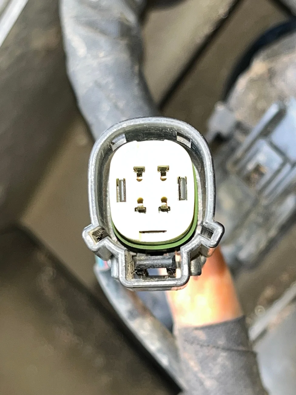

Male pins with a locked TPA:
Ford F-150 Lightning Pro Power bed outlets not working: Fix#13 1781914958858-u

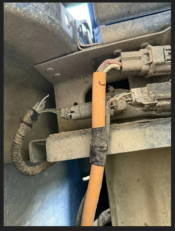

Broken/cut wires:
When I got this error it was only for the bed outlets. I popped my head under the truck and saw some of the wires were cut.
Ford F-150 Lightning Pro Power bed outlets not working: Fix#13 broken wires ppob fault

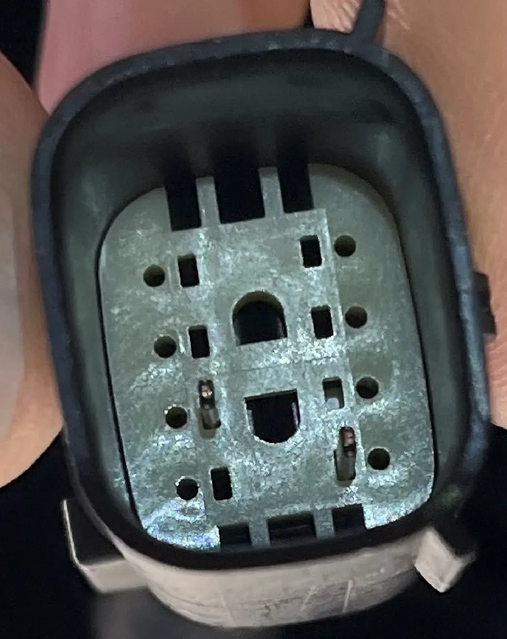

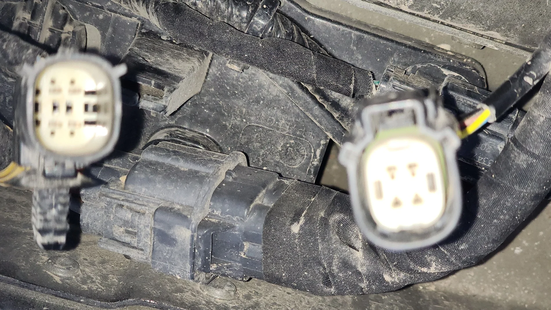

I am attaching some pics with the flash on. I can see that both sets of TPAs must be in the locked positions. When I have it pushed together I know the exposed pins are in the female socket once they touch and pushing hard in will get me a quarter inch of spring loaded travel before it springs back.
Still seems like if the pins are making contact in the TPAs that it should have full communication locked or unlocked. Still need another inch of travel to get the top holding latch to engage.
I see I need to pry out the female pin socket but not sure what that will get me. I can't latch on to anything on the pin side to try to pull it out. Will try again this afternoon. Thanks.
Ford F-150 Lightning Pro Power bed outlets not working: Fix#13 20260621_200224
Ford F-150 Lightning Pro Power bed outlets not working: Fix#13 20260621_200210
Ford F-150 Lightning Pro Power bed outlets not working: Fix#13 20260621_200131

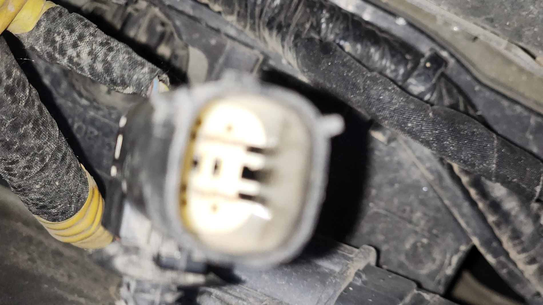

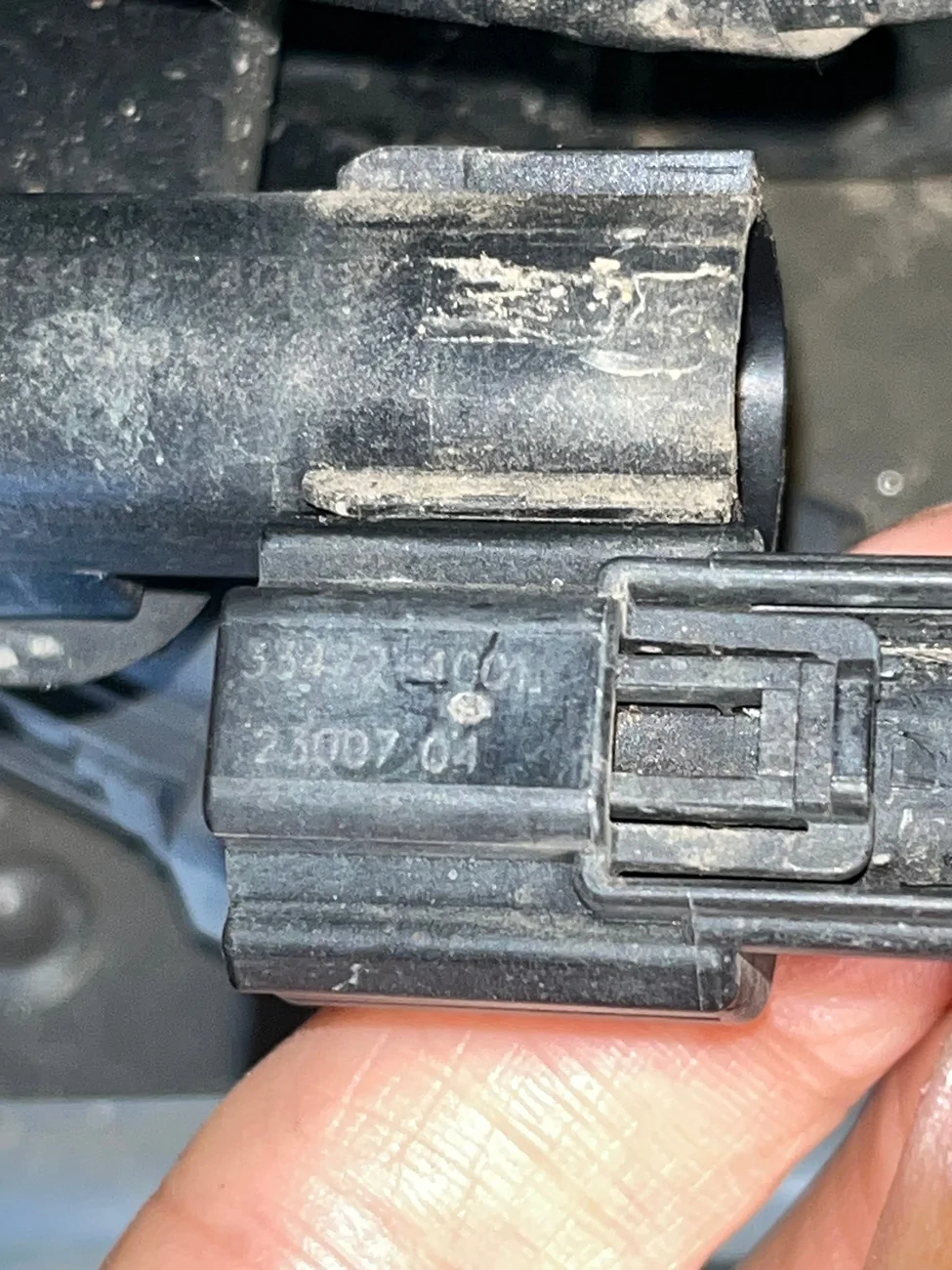

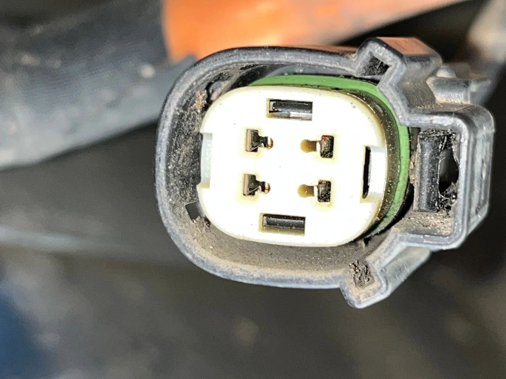

Seems like either clogged female terminals or debris at the female green o-ring that preventing the connectors mating.

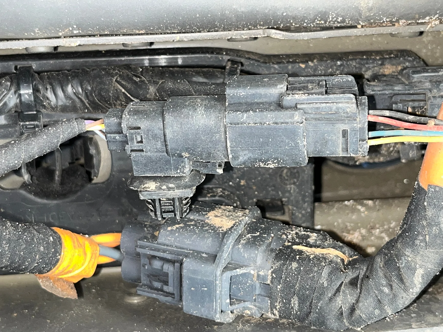

Today on my 1 week owned 2023 PowerBoost the 4-pin 7.2kW PPOB connector:
Ford F-150 Lightning Pro Power bed outlets not working: Fix#13 PPOB 4-Pin Connectors Male & Female - IMG_8500
Female as found when disconnected from the male.
Ford F-150 Lightning Pro Power bed outlets not working: Fix#13 PPOB 4-Pin Female - Dusty As Found - IMG_8492
Female dusted out.
Ford F-150 Lightning Pro Power bed outlets not working: Fix#13 PPOB 4-Pin Female - Dusted Out - IMG_8514
Ford F-150 Lightning Pro Power bed outlets not working: Fix#13 PPOB 4-Pin Male - IMG_8509
4-pin and the 120/240V connectors.
Ford F-150 Lightning Pro Power bed outlets not working: Fix#13 PPOB Connectors w Dirt-Grit from RightRear Wheel - IMG_8453
Reactions: bc1
If they won't latch, there is a reason, something is in the way.
If you can't clean them out - maybe there is bad corrosion in there that can't be cleaned easily - you could remove the connectors and 1) replace them with new connectors or 2) connect the wires together without the plug-socket connector.
I think (1) would be the preferred way.
good luck

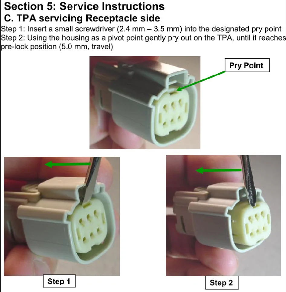

Well I finally got it working the other day. Had to wait between rains and when I was on a dry surface wearing something so I could crawl under. Basically took a small screw driver and pried out the female white TPA so that it popped out around a quarter inch outside of the black plastic outer plug casing.
I noticed it had a couple slots in back to insert something in to pry it out as well. On the recessed male white TPA I couldn't get to the body of it but I read about possible loose pins being the problem so when I began pulling on each of the 4 male prongs and it also popped up a quarter inch into the unlocked position. It was still recessed inside the casing to protect the pins.
I pushed it together and it worked.
Also figured out that the top tab that I thought was supposed to slide under the U shaped latch on top (like plugs I've dealt with for years) of the black plastic outer plug casing was still too far away. Upon further looking the U shaped latch is not the type that you pry up to release it before pulling the plugs apart but instead there are two prongs on the side of the U shape plastic latch that requires each one to be pried inwards to release them so that the plugs can be pulled apart.
So mine is together, latched, and working now without driving to a dealer for a day of service. Thanks to all.
