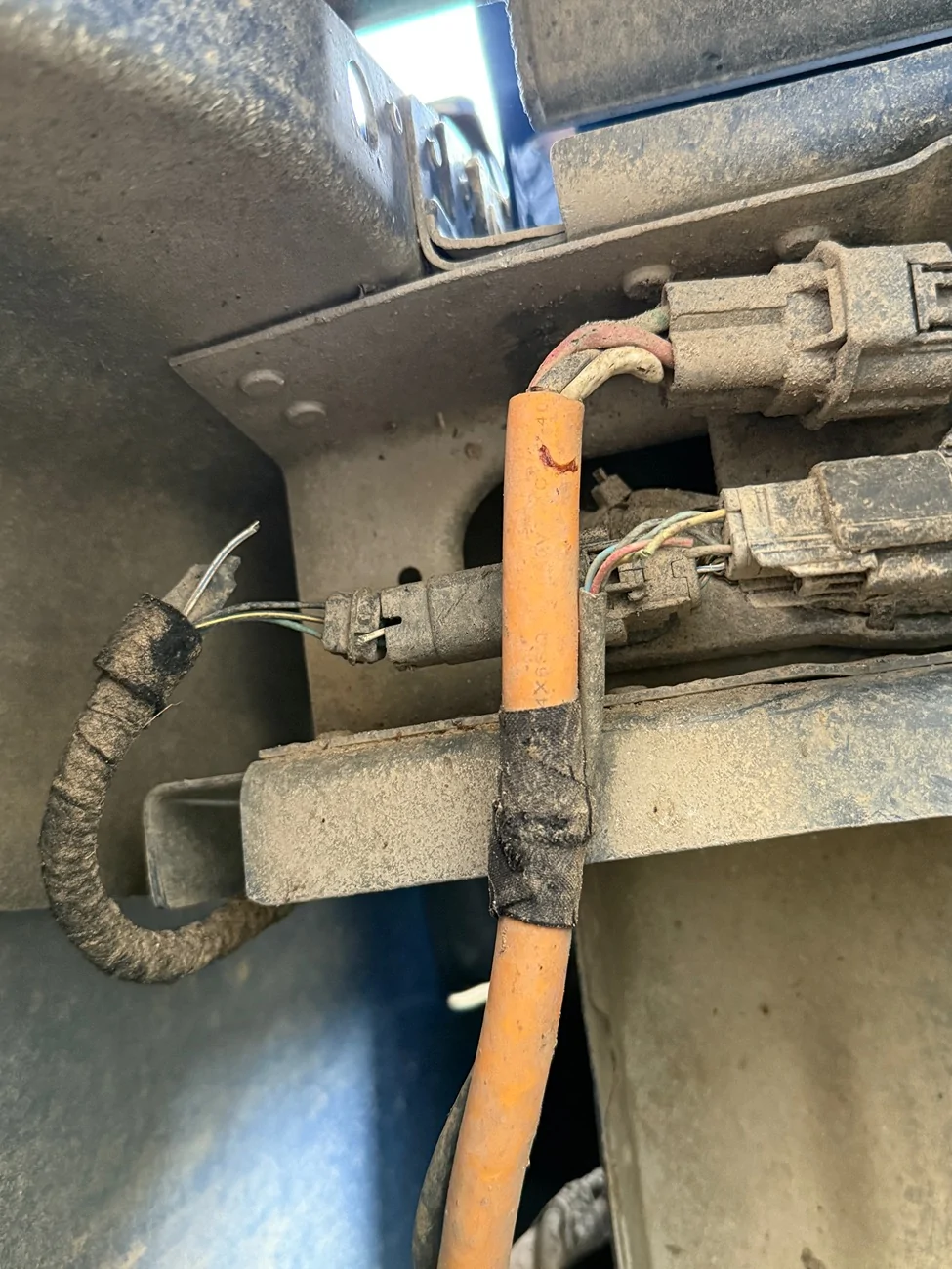

What the? How did that even happen? A rock hit it just right?
No idea. I bought it used. I checked the frunk outlets at the dealer prior to purchase, but never the bed ones until I got home (250 miles away). Excitement leads to shortsightedness! They helped take care of it and got a new harness and entire outlet box by reimbursing me and letting my local dealer handle the repair. I will say, to quote them “It was driven down a dirt road” and they were not kidding with all of the mud and rocks lodged in the underside. I have ripped a bunch of trim off to clean up the caked dirt. I need to remove more this summer as it is still crying dirt lol

Looking at the photos in post 6, some of the under bed wiring was intentionally cut. Hard to say why the damage was done, but it wasn’t from rodents chewing on the wiring or the result of road debris.

Those cut wires are a mystery - clearly not the PPOB power, maybe 12v lighting in the bed or a connection to a trailer harness? I guess the dealership fixed that too?
