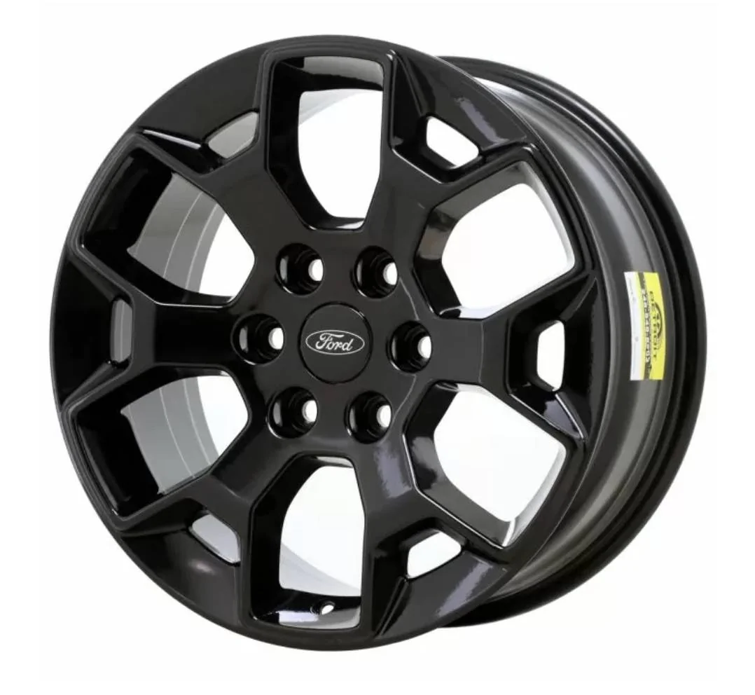

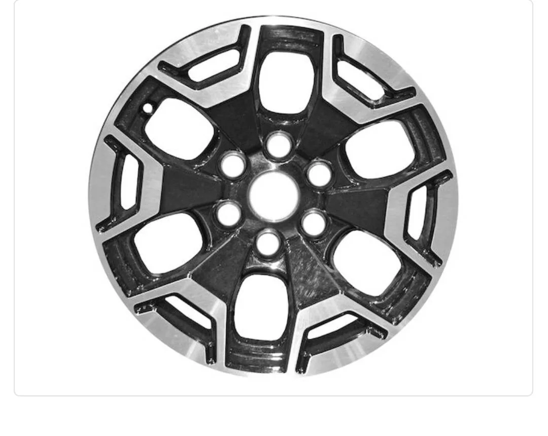

Long time lurker. The Dynapro AT tires on my 2023 Lariat ER are near done. Have hade the issue where the outside of the tire has worn almost to bald. Even with rotations and allignments. Over 40k miles so im at the point where i need new tires anyway.
I know most Ford wheels arent rated for the weight of the Lightning. I like the look of the Pro 18" wheels (powderckated all black) more than the Lariat 20"s but havent really found any for sale around me. Ive found some Heavy duty payload package 18"s.
The look is pretty similar, is there a major difference between the two? Are the lightning wheels lighter or have better aero?
Ford F-150 Lightning Pro wheels vs HDPP wheels Screenshot_20241113_124049_Chrom
Ford F-150 Lightning Pro wheels vs HDPP wheels Screenshot_20241113_123921_Chrom
Amanzo81
Dec 8, 2021
2012 Acura TL SH-AWD, 1999 Jeep Cherokee Limited
Sorry, Pro wheels on top, HDPP wheels (powdercoated black) on bottom.
Henry Ford
Dec 21, 2022
1,690
2,514
2022 F150 Lightning Platinum
The black wheels are the only wheels on the Ford Accessory website that don't specifically say they aren't "validated" for Lightning. They are a bit more see-through than any Lightning OEM wheels which leads me to believe they are a bit less aero-efficient.
They look great. If you aren't super efficiency sensitive they are probably a good option. They will probably be a little less efficient but they aren't going to cut your range in half.
