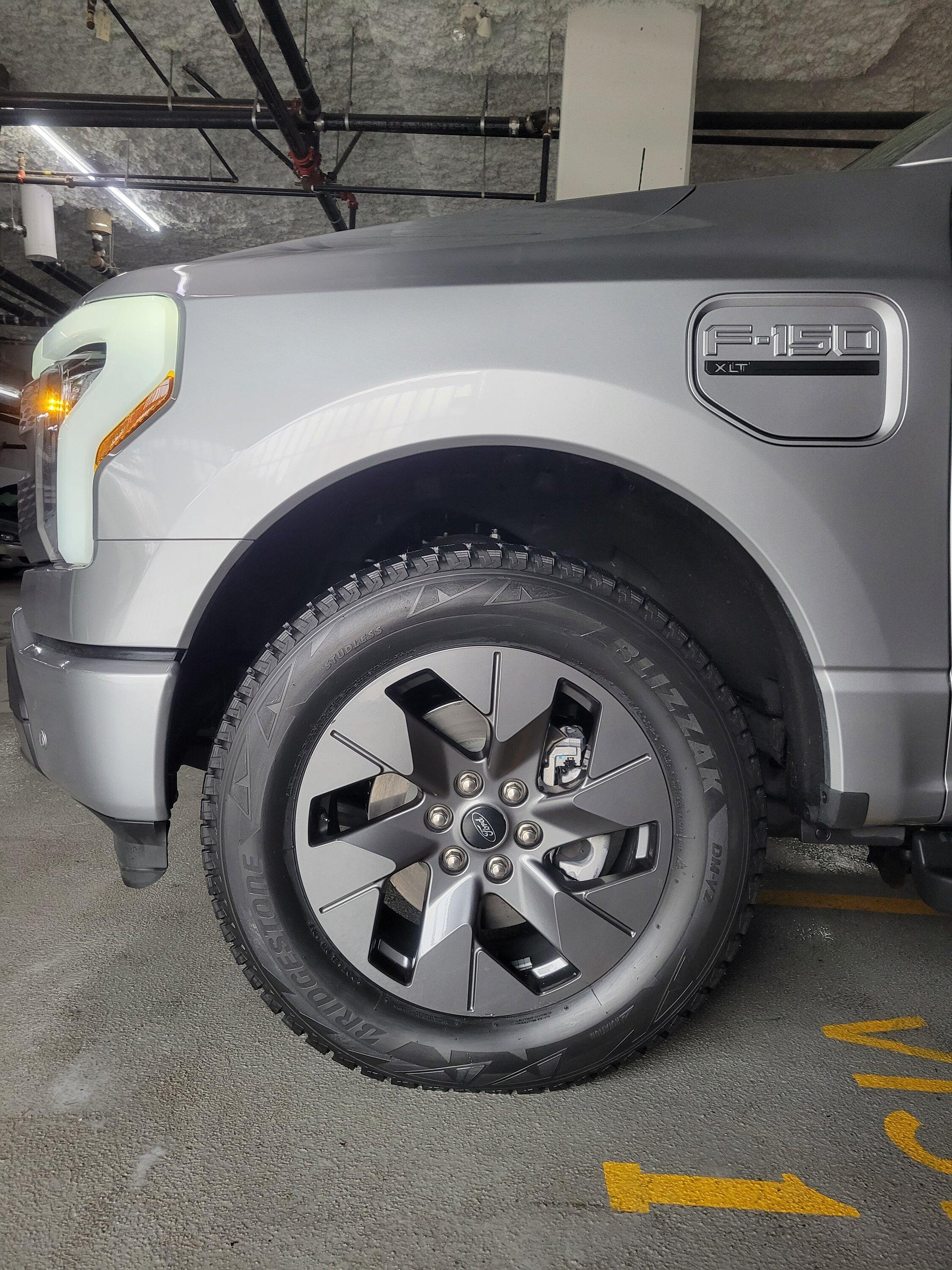

What are you paying for the 18" Pro wheels? I wanted to buy a set with my Lariat ER, for winter use, back in June last year, and they weren't even in the dealer's parts database but he was verbally told nearly $1000 *per wheel* when he called Michigan to ask.
I ended up finding a set of 18" HDPP wheels (the "64H" wheels) on eBay - these are the only other 18" wheels rated for the weight of the ER Lightnings.

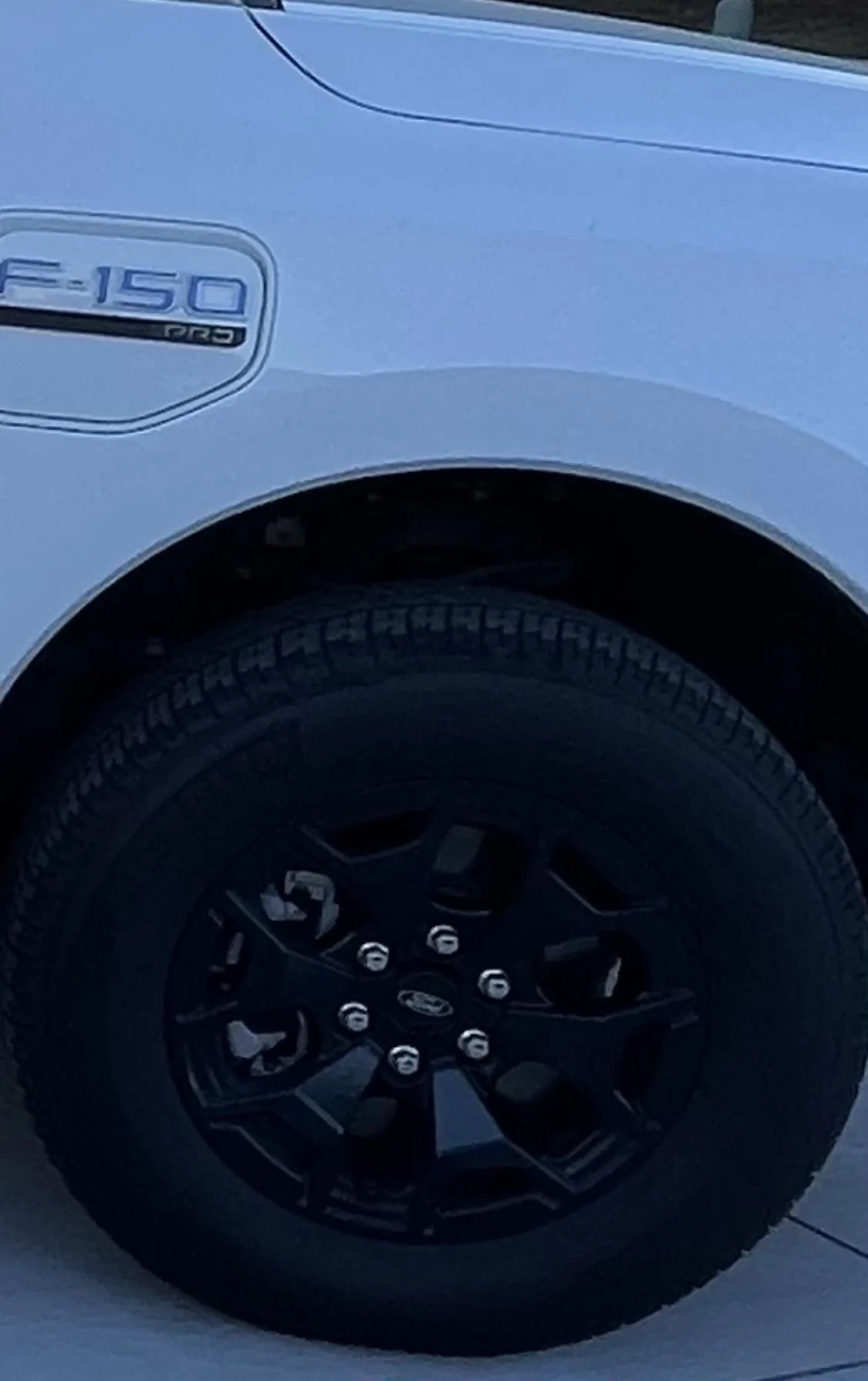

I’m upgrading to a Platinum from a Pro. I had my Pro 18s powder coated gloss black.
That looks nice! Any pics of the whole side of the truck with the wheels? Thanks.
