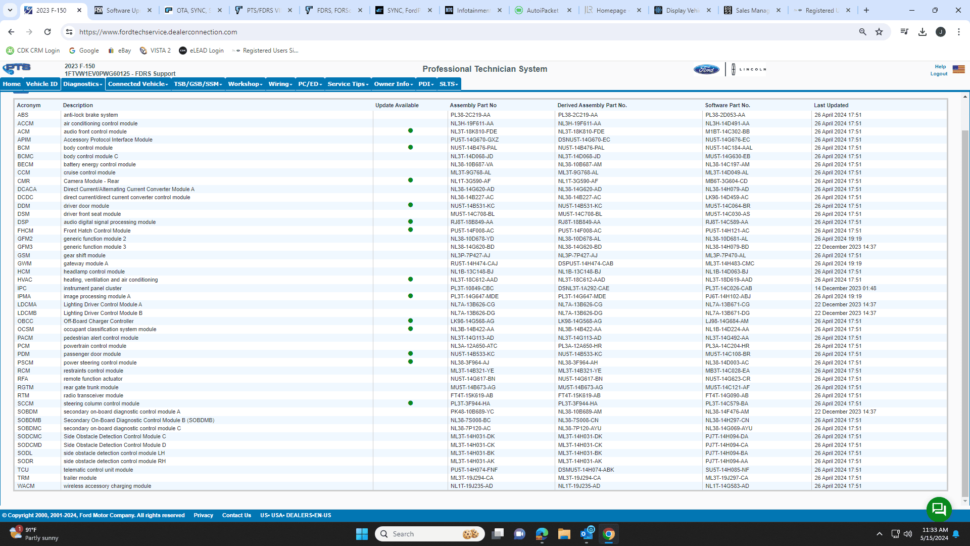

The VIN in the photo is for some else’s truck (my fault for not providing it again during the flood). Here’s mine again:
1FTVW1EV0PWG60125
Based on the Sync version you're on, you also need updates to the APIM, GWM, TCU and IPC that are not showing below.

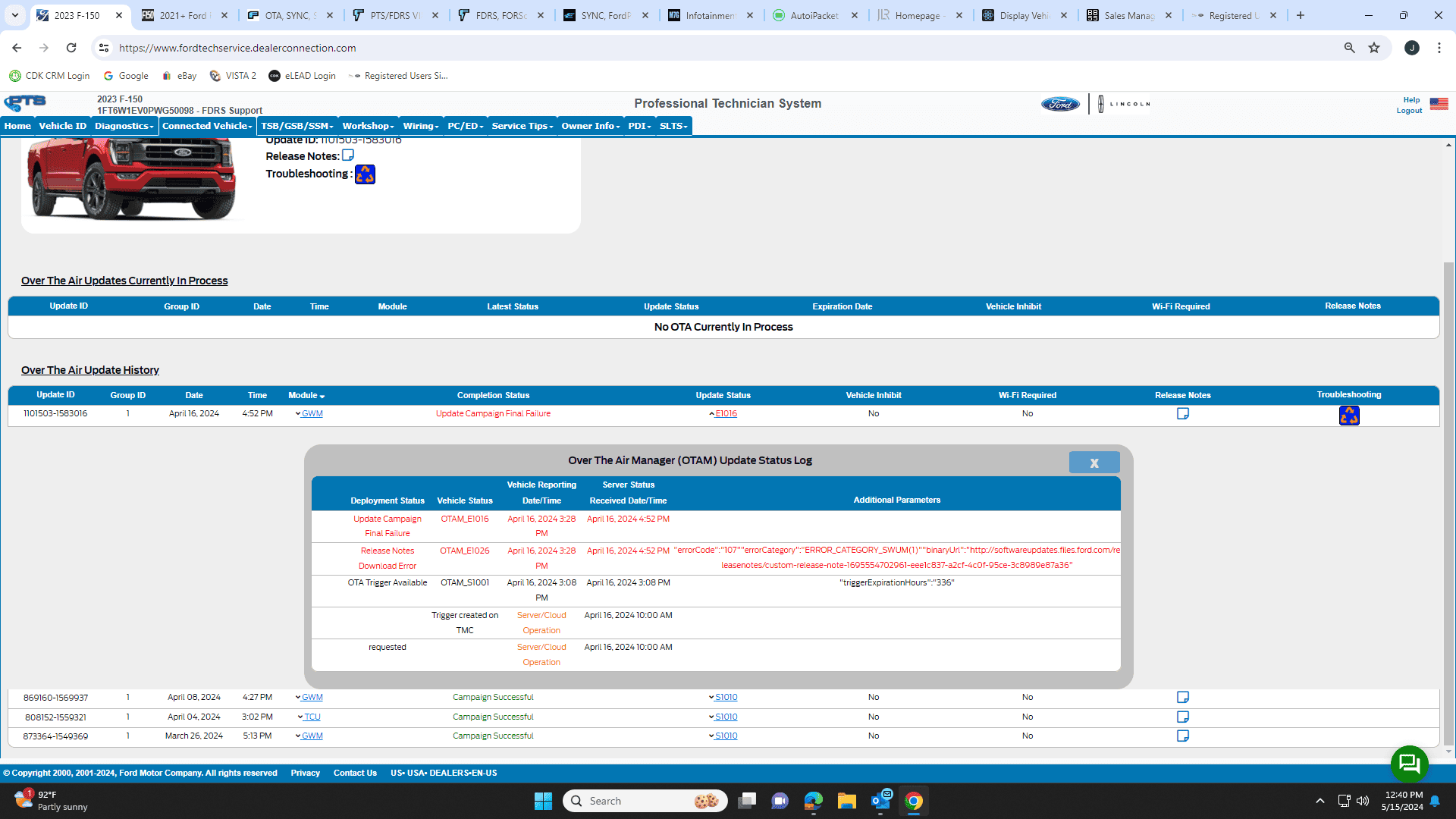

Hello can you check my VIN: 1FT6W1EV0PWG50098
Purchased on March 2024.
thank you for checking!

Last OTA attempt was 6.1.0 last month, but it failed due to a release note error. Not the first time I see that and idk why it happens. Nothing you did wrong or could have done differently; you just gotta wait for it to be resent.

Thank you for looking it up. Sounds like black magic with these updates. Hopefully it works next time.

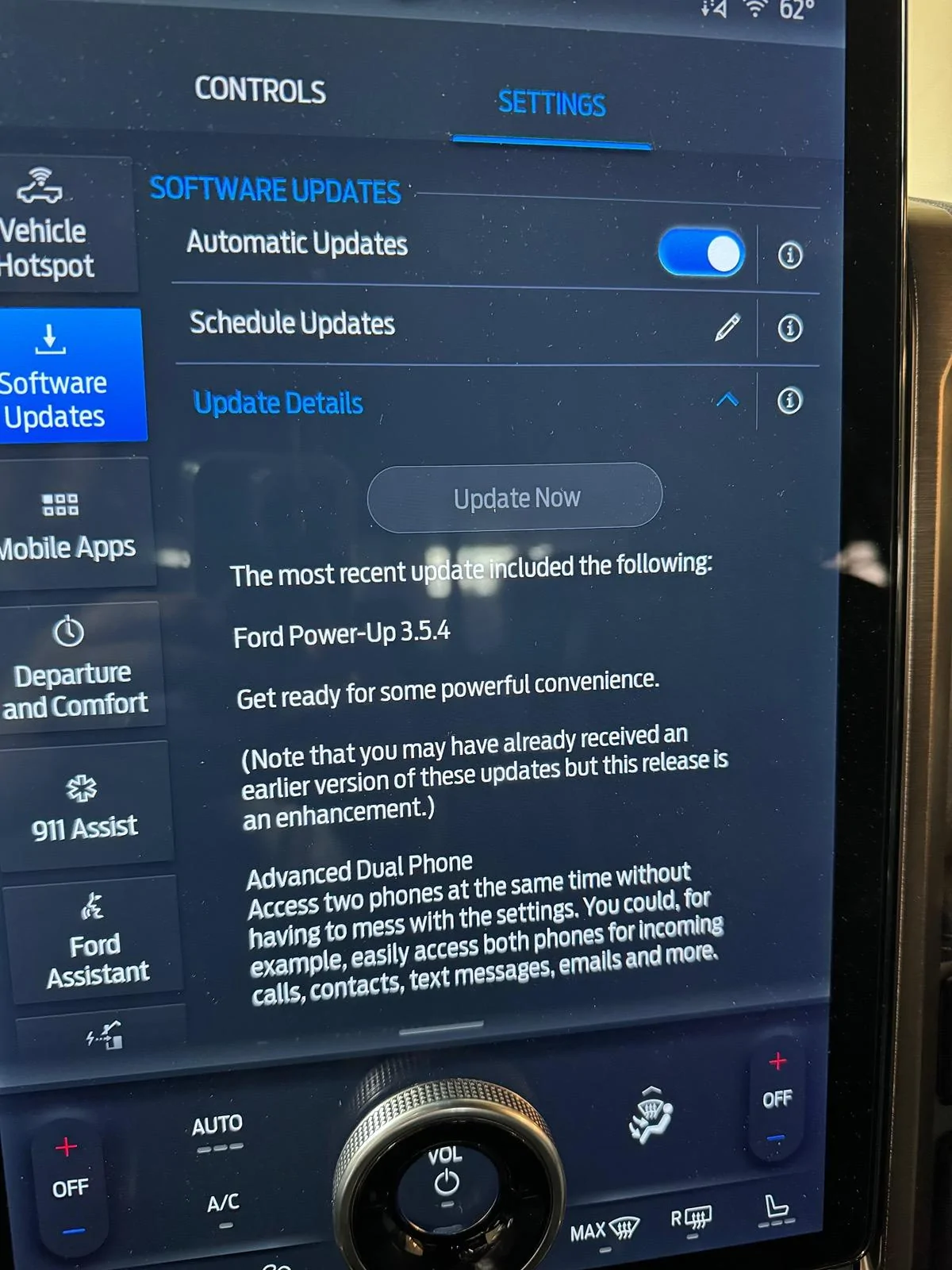

Hello:
Would you you kindly check 1FT6W1EV0NWG14215
I haven't taken an OTA in well over 1yr, and this is the screen that has appeared since my last update (again, 12+mos ago)
Thank you!

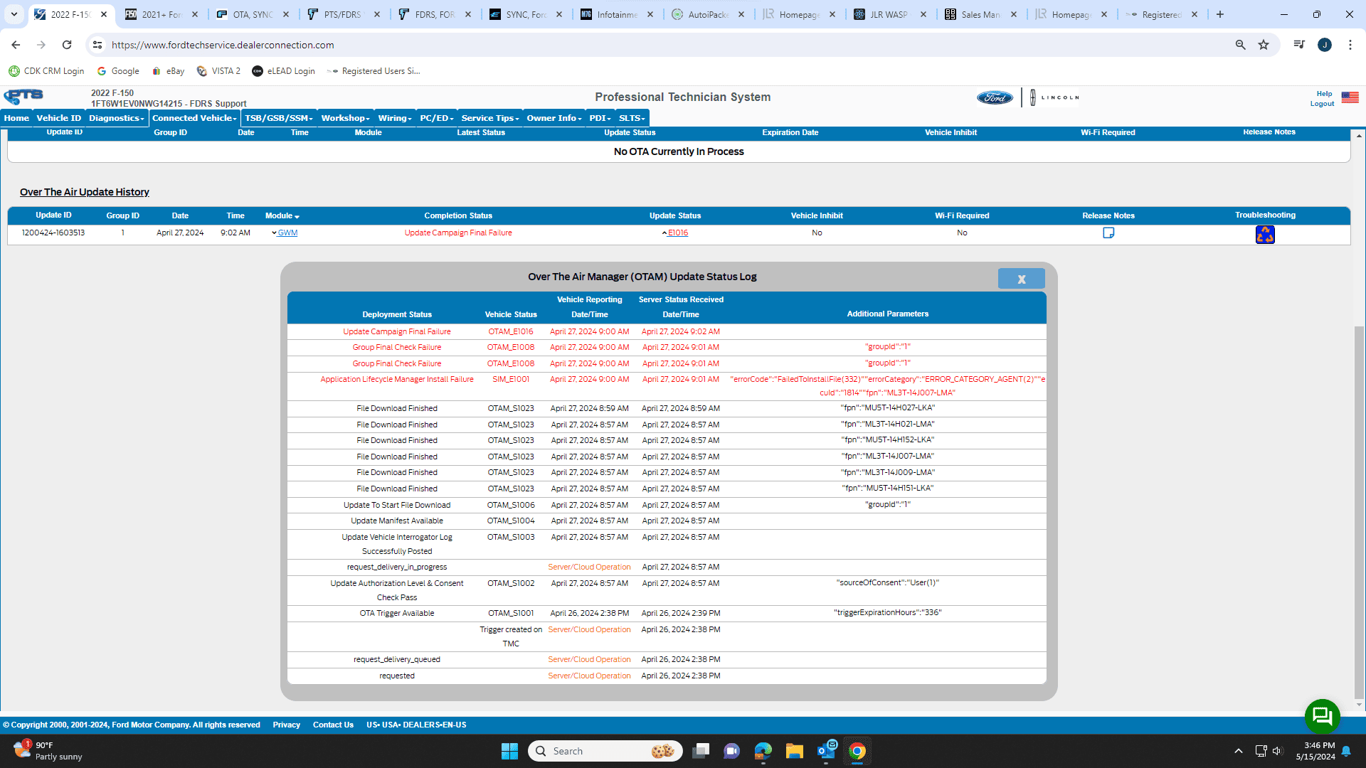

Yea, that update is pretty old. You were actually sent the next update due for you 4.2.1 on 4/27 but it failed trying to install one of the files. Hopefully it gets resent to you soon.

Thank you! I received a message that day on my dash saying the vehicle was un-drivable due to failed update - it eventually cleared after I parked for some time.
How long would you suggest I give it to try again?

Your guess is as good as mine. There is not way to force an OTA to be sent to you.

Got it. Does the error message as to why it failed give you any insight?

Not at all. I posted the screenshot to include the error code for you to see. It just says "failed to install file" and then goes on to tell you which file it was, but that is it. It is virtually impossible to diagnose why an OTA failed from what we can see in PTS.

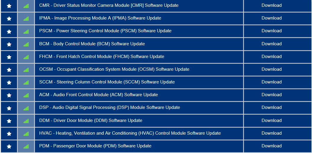

Nothing pending in queue for an OTA at this time. Modules with pending updates are below.

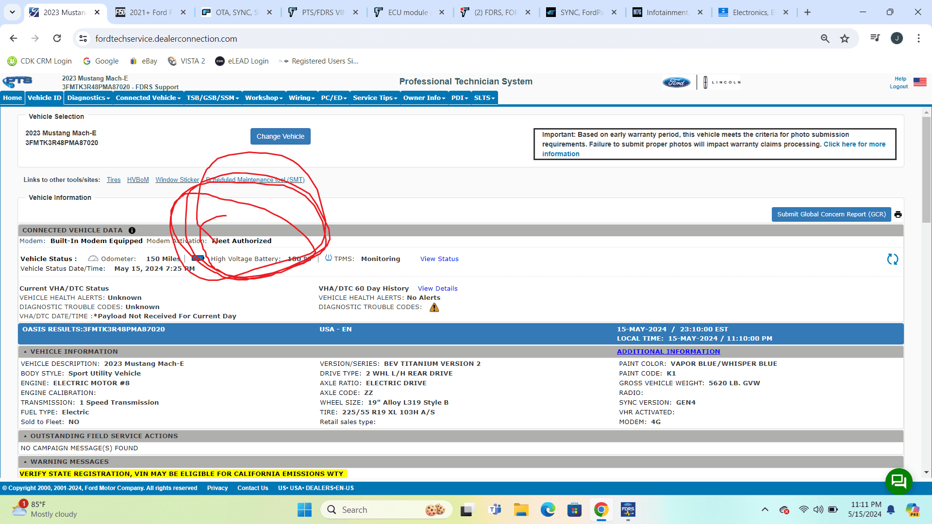

I just purchased a 2023 Mach-E to go with my Lightning. Could you please check 3FMTK3R48PMA87020 so I can see how this car is configured from the dealer? Thanks!
The modem needs to be activated or you will not have any connectivity or get any updates. Warranty hasn't started yet. Did you buy it or are about to buy it? The modem needs to appear as retail authorized and not fleet.

Thanks! I bought the car today and will pick it up tomorrow. I suppose that the modem won't get activated until I set up the car with Ford Pass.
