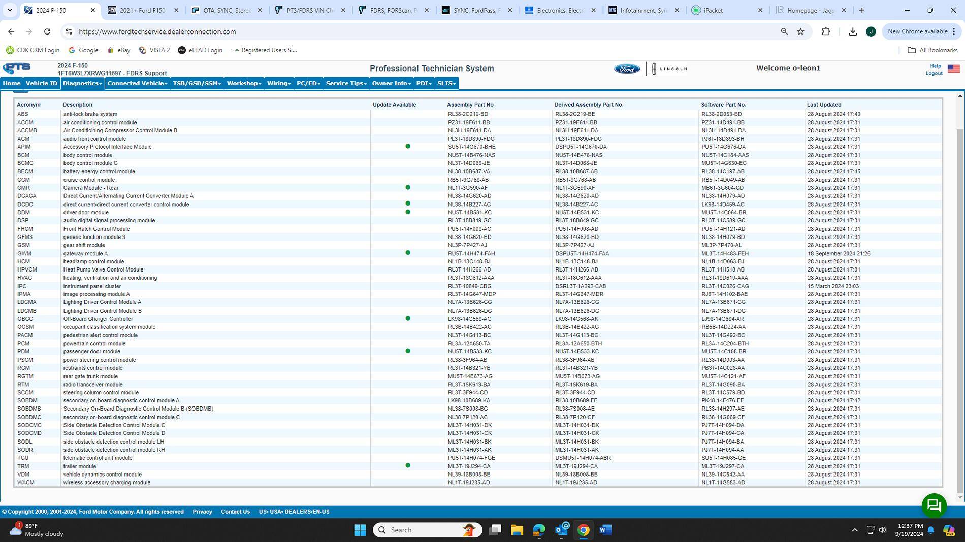

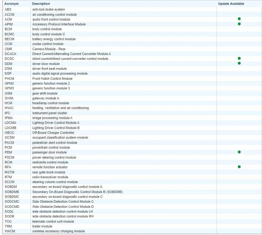

Your list is below. Your truck has the latest IPMA software (BAE) and it seems like it has the config for lane change assist. Go to your driver assist menu and cruise control settings. Do you see the options there to enable lane change assist, in-lane repo and predictive speed assist?

Remember lane change assist works by tapping the turn signal and not fully engaging it until it clicks. If you do not see the toggles for those features in your touch screen, try it anyway. Lmk what happens.

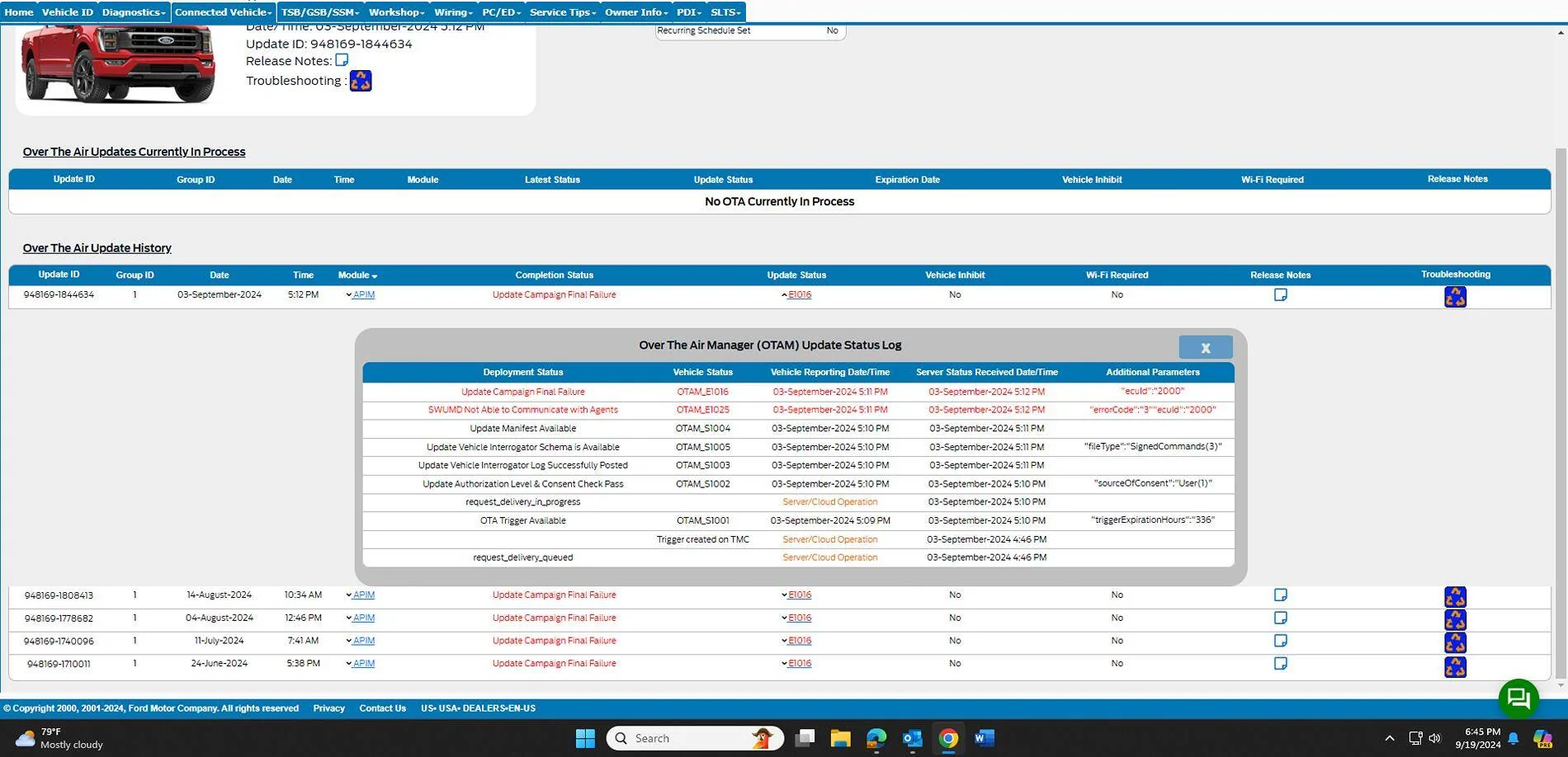

Yea, you're on Sync 22228 which is pretty old. You show a ton of pending updates. OTA dashboard shows you have been sent an APIM update repeatedly which continues to fail with the same errors shown below. This behavior is not normal. I would take it to the dealer and show this to them and see if they update the APIM manually for you to get you over this hump.
Question: On your touchscreen when you check for updates, does it say "up to date", does it show a failed update, or does it just stay checking and nothing happens?

Makes sense. Thanks so much. It just says up to date.
