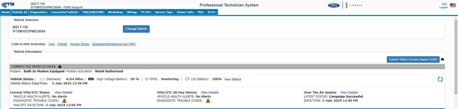

Ford Lightning XLT 2023 ER
You have OTA 6.4.0 sitting in your queue since 7/1, but your truck is not downloading the files for some reason. Also, your truck is reporting an entire boatload of lost comms codes between many modules within the network. Like, A LOT of codes. Any issues with your truck, or is it working fine?
I had issues with communication last weekend so I pull fuse 35 I think to reset the module. Not sure if this cause the errors. I just got back home and I unplug the 12v battery for 2-3 minutes, the truck is downloading power up 6.4....
Thanks
Yea, it shows it is working now. It also shows 6.4.0 installed successfully.

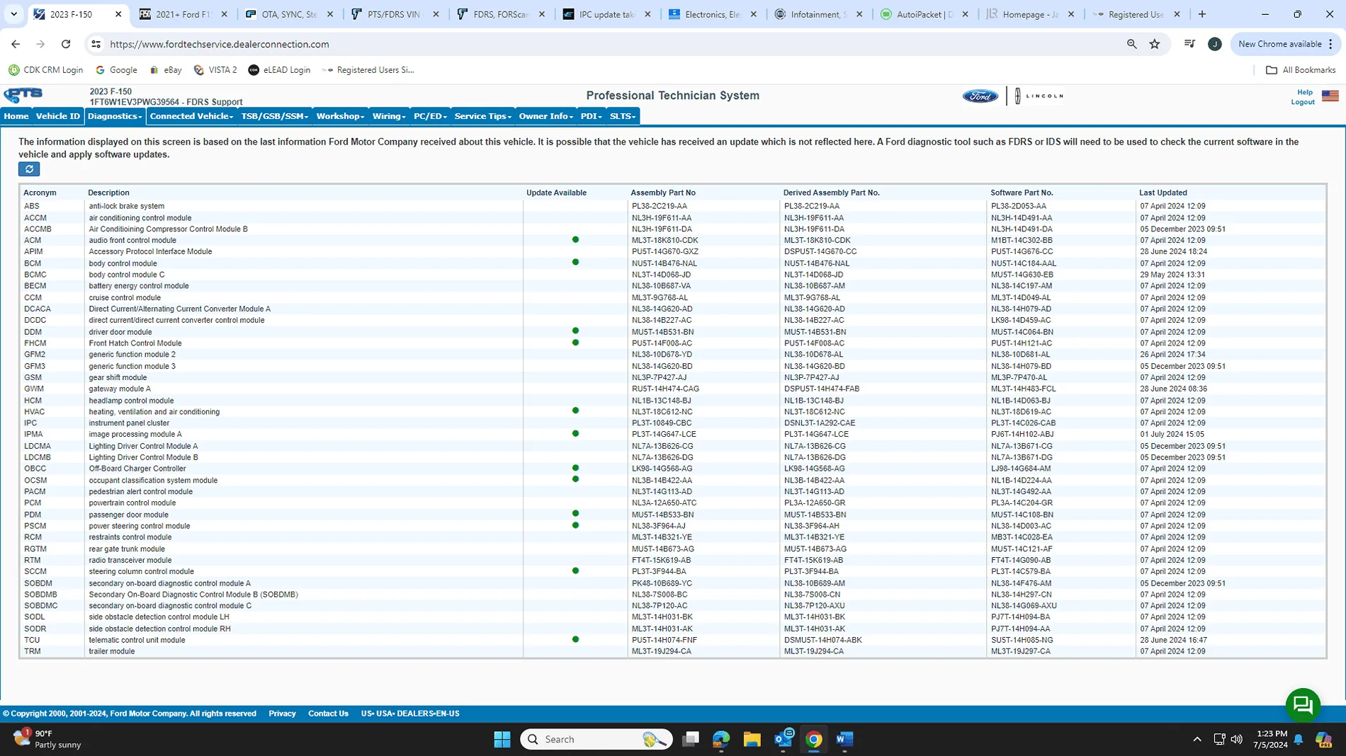

Hey @rugedraw I had them do "as many updates as they could" before taking delivery, which got me a personal call from the dealership owner saying that normally they charge for this, but honoured it for free when I informed him the software was ancient on a 117k MSRP truck lol. They started on the 27th and just finished on Tuesday :oops: but there was a holiday weekend in there too.
Would you be able to run the VIN (1FT6W1EV6PWG28493) again and see if they truly updated stuff? I'm attaching the Service Order the tech gave me detailing what was done, but for a layman like me, it's light on details.

It seems like they did everything that was showing. Your truck is on Sync 22326, and I see they tried updating the APIM a couple of time with no success. The update you are looking for that shows the % is for the IPC. However, that update requires other updates being installed before that one can be installed. Because they were not able to update the APIM, they were able to get far along the process in terms of the key modules that need to be updated before that IPC updates gets released on the server side.
I do not have a good explanation as to why the APIM update failed. What I can tell you is that if it were my truck and I was updating it and the APIM update failed, I would have kept trying until it went through. With that said, they went way above and beyond what they are required to do by doing what they did. You'll have to wait for the OTA process to get you what you're missing.
