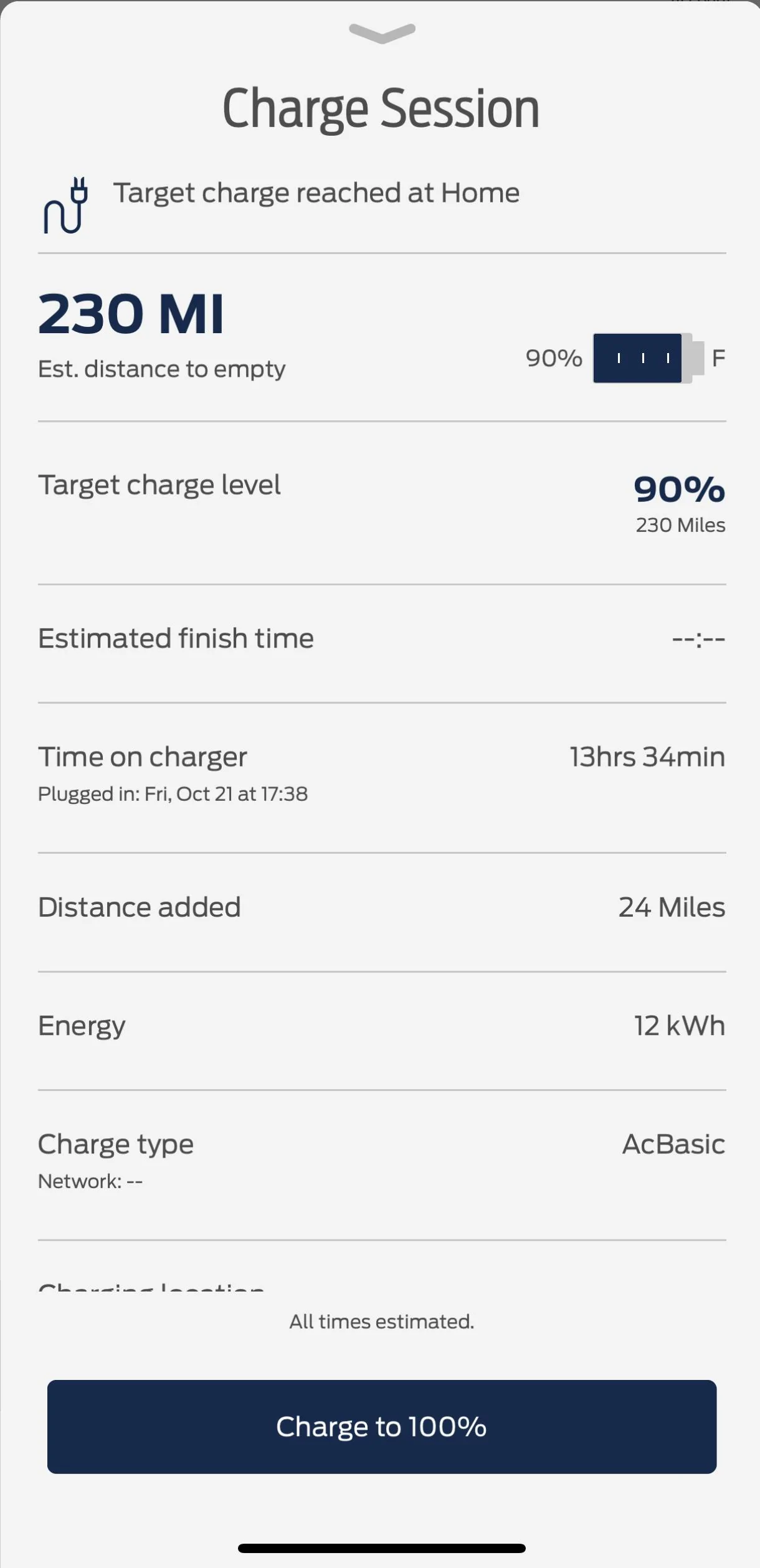

The OP needs to set his appointment for service so he can be told everything is normal or told something is defective. At this point we are all guessing.
Here you go OP, you arent the only one. Again, this is all expected and normal. But take it to service and see what they say.
Ford F-150 Lightning Range took a huge drop 69975515-E632-480C-A303-3096EA712140
