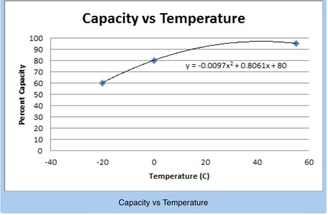

Battery capacity changes with temperature.
Typical lithium ion curve…

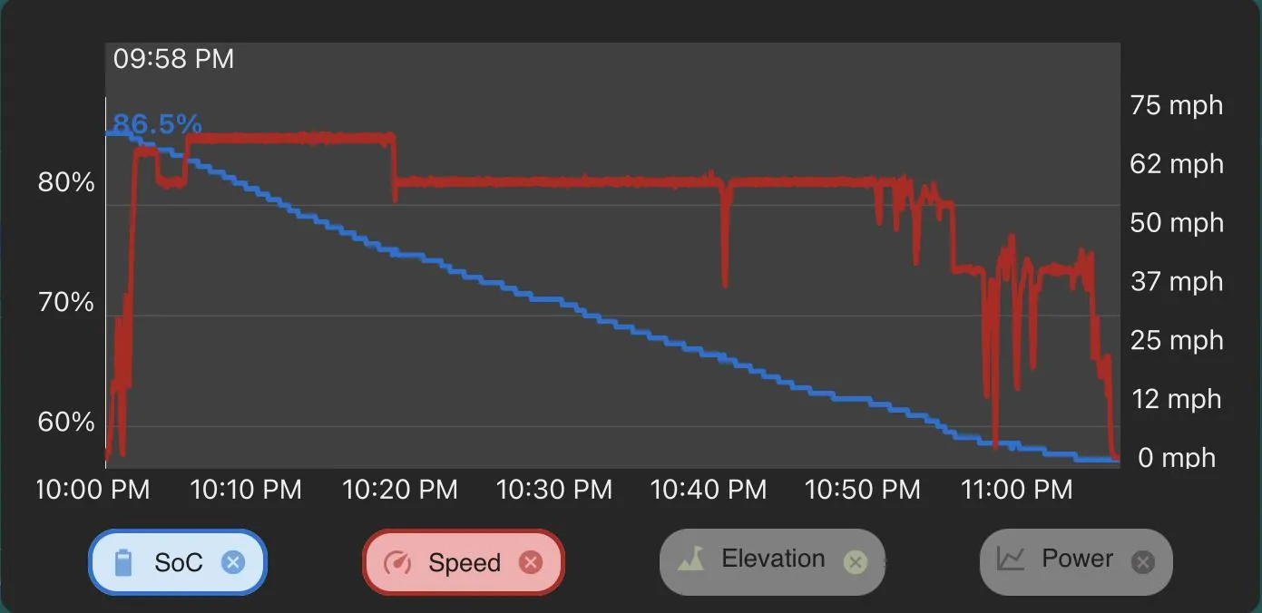

FWIW, I completed a 270+ mi mostly freeway trip last night (Net ~190 ft. elevation gain, Cabin heat @ 68 deg. F, ~700 lbs total added load including passengers, tonneau cover - no other mods)).
Results: Great trip and no surprises 😏 thanks to all of the info shared on this forum👍👍. I probably could have made the entire trip w/o a charge, but the first 120 kW Charger was at the restaurant and I wanted to try the second newly installed/upgraded 350 kW EVgo Charger.
ABRP Calibration (~90% certainty)
Starting:
2.1 mi./kWh @ 65 mph
Ending: 1.93 mi./kWh @ 65 mph
1st - 101 mi. Leg after preconditioning: 2.14 mi./kWh @ ~49 mph ave. - [Rush Hour slowdown after 1st hour] (BlueCruise mostly set to 69 mph, 1-pedal) w/ 40-44 deg. F and a total 230‘ elevation drop.

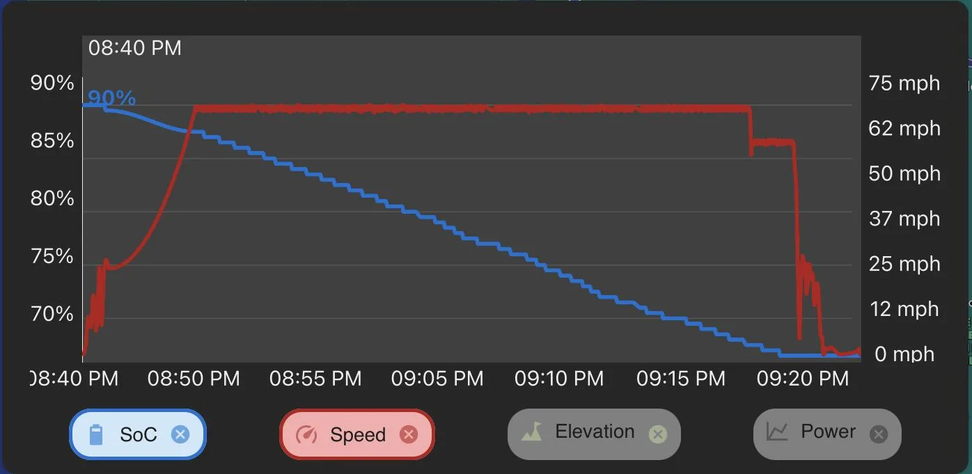

2nd - 50 mi. Leg after 1 hr dinner/fast charge stop: 1.4 mi./kWh @ ~63 ave. mph (BlueCruise set to 74 mph, 1-pedal) w/ 31-33 deg. F and 128’ total elevation gain.

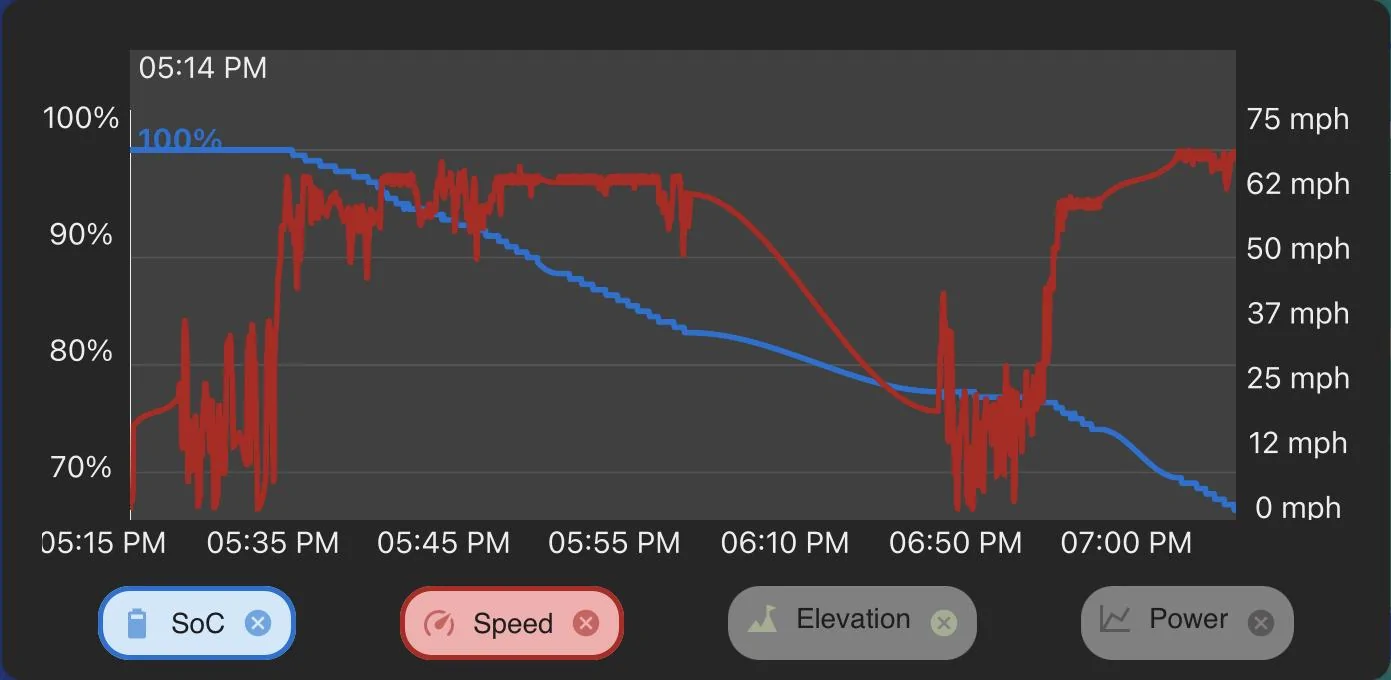

3rd - 73 mi. Leg after 15 min. fast charge: 1.6 mi./kWh @ 60 mph ave. (BlueCruise mostly set to 64 mph, 1-pedal) w/ 34-38 deg. F and 314‘ total elevation gain.
