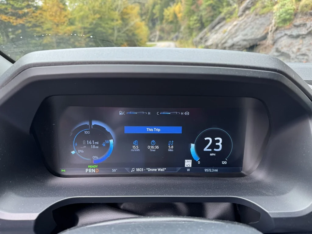

Test it.
From 70 mph, come to a complete stop with 1 pedal by taking your foot off the accelerator and watch your peak regen power. You don’t hit max regen power, 210 kW, or two major ticks.
Try again feathering the brake pedal and you’ll see the regen power increase closer to the 210 kW max scale.
Both cases produce a 100 % brake coach score. That just means you didn’t engage the brake pads. You can stop slightly faster, in a slightly shorter distance, and recover a tiny bit more energy feathering the brake pedal.
Ford should report the energy returned to the battery, in Wh, so you can better see the difference. (Though, you’ll be disappointed: An extra 30 kW of regen braking for 1s is a whole 8Wh, so it’s not that significant)
