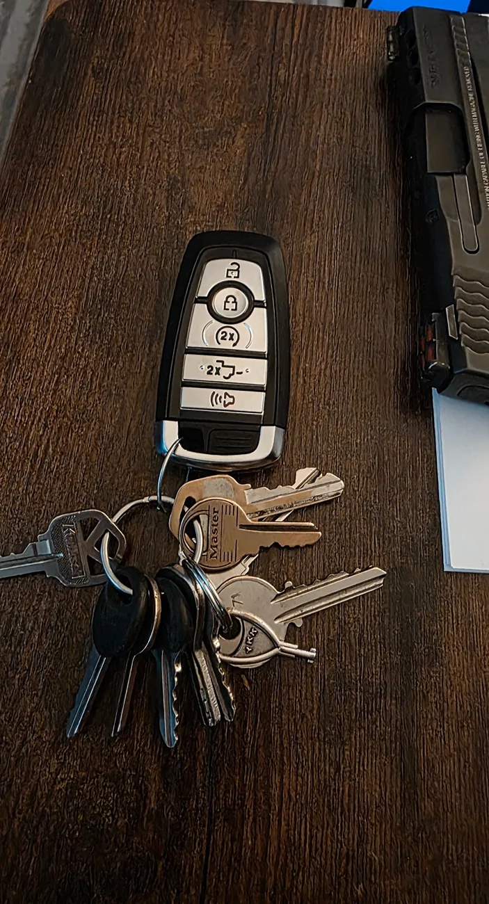

Wait.....you can start it with your Key Fob??
Yep, I bought a fob for an ICE truck and used the owners manual method to program it. Only caveat is you lose the frunk button.
How do you find the range on the keyfob Climate start? I've had mixed results with range on the current keyfob.
About the same as my other truck, It's adequate.
What kills range on the fob is dash cams, cell phone chargers etc. including in those parked near me.
