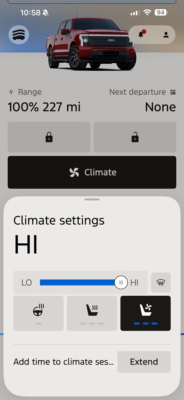

Temps have been in the 90's the last week or so here in Upstate NY. Before I leave work, I remote start the truck via the app by clicking on the fan-Climate button. I can see the white lights on my truck activate from my office window a few seconds later, indicating it has "remote started". This is what appears on my app (note the seats show three blue dots):
Ford F-150 Lightning Remote start HVAC control IMG_6850
About 10-15 minutes later, I get in the truck and it is obvious that the drivers seat heater is on rather than the cooling.
When I press the seat icon on the Sync screen, it shows three red dots under the seat (heating) rather than the blue dots (cooling).

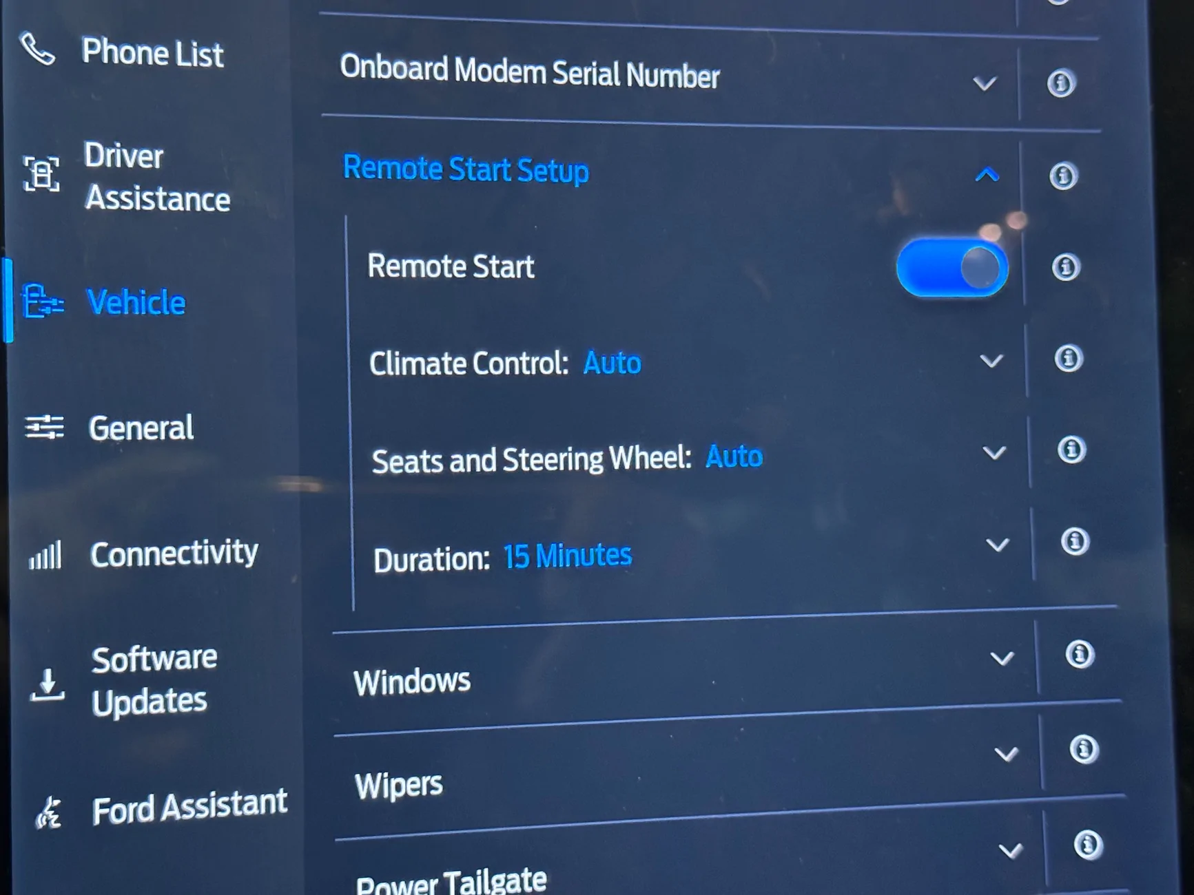

I checked the remote start setup in the vehicle settings via the Sync screen and both climate control and seats & steering wheel are set to AUTO:
Ford F-150 Lightning Remote start HVAC control IMG_6901
How do I get the seats to cool when remote starting and the temperature outside is HOT?
On occasion, I'll cycle through the Cool or Warm levels then transmit an EXTEND command, that usually ensures the proper mode of operation has been received by the truck.
Also make sure the temperature level is corrected, you're showing HI aka (HOT), lower that to 60's or COLD (LOW)
2,770
3,052
This is likely 100% of the problem. The seats don't cool, they just circulate air from the cabin into the seat. If the air in the cabin is hot, then it will blow that hot air into/through the seats. The button on the screen always defaults to heat on the seats, if it wasn't on already. I think lowering the temperature slider to a cooler temp should do the trick.

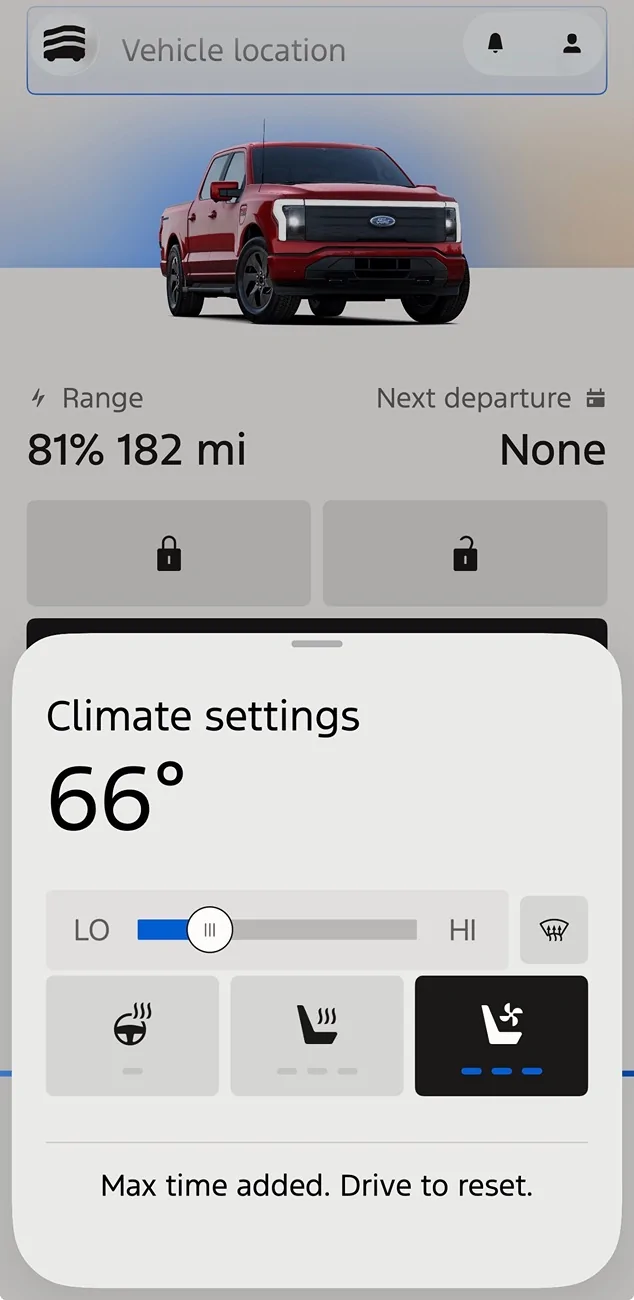

i incorrectly believed that the HI-LO slider was for the fan setting.
Once I activated the remote start and moved the slider, numbers appeared, indicating the temperature.
I set the slider to 66 and the seats cooled and A/C was on.
Thank you for the help addressing my issue, now resolved.
