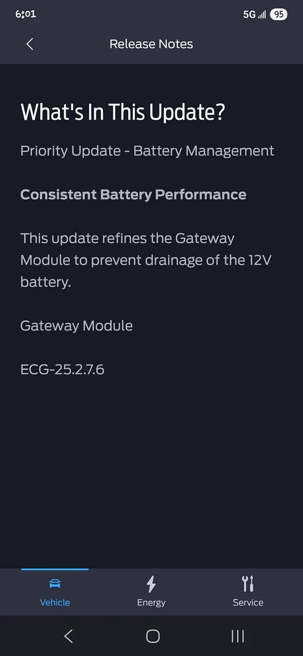

Just had a GWM update come thru for my truck OTA Says something about battery drain though, nothing about coms.

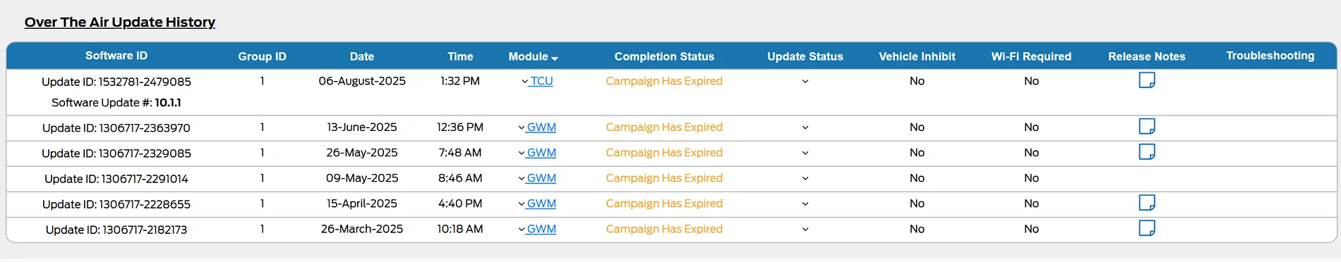

He has had MULTIPLE GAteway OTA attempts. I have helped several dealers with these situations and they were all gateway modules.
Ford F-150 Lightning Repair Nightmare - Ford engineers taking incorrect SW approach 1755359838908-yf
The TCU going bad is very unlikely. The most common reasons for connectivity issues are Software bad due to a bad OTA, ethernet codes which this truck has. THe ethernet codes are key here because that is how the TCU communicates with everything. THe CanBus is not primary for the tcu data.
I do BELIEVE the gateway to be the most likely culprit. Hard to say for certain sometimes but going off the several I have helped DEALERS fix across the country the gateway is the culprit. Reason being the ethernet is all routed from the gateway.
It could be a As build situation but looking online(Which can be inaccurate to what is in the truck) I dont see anything. Situations like these its always nice to have forscan available to see the actual as build in the truck
I cant remember if they had already replaced the TCU or not in this situation.. I have helped a few people.
