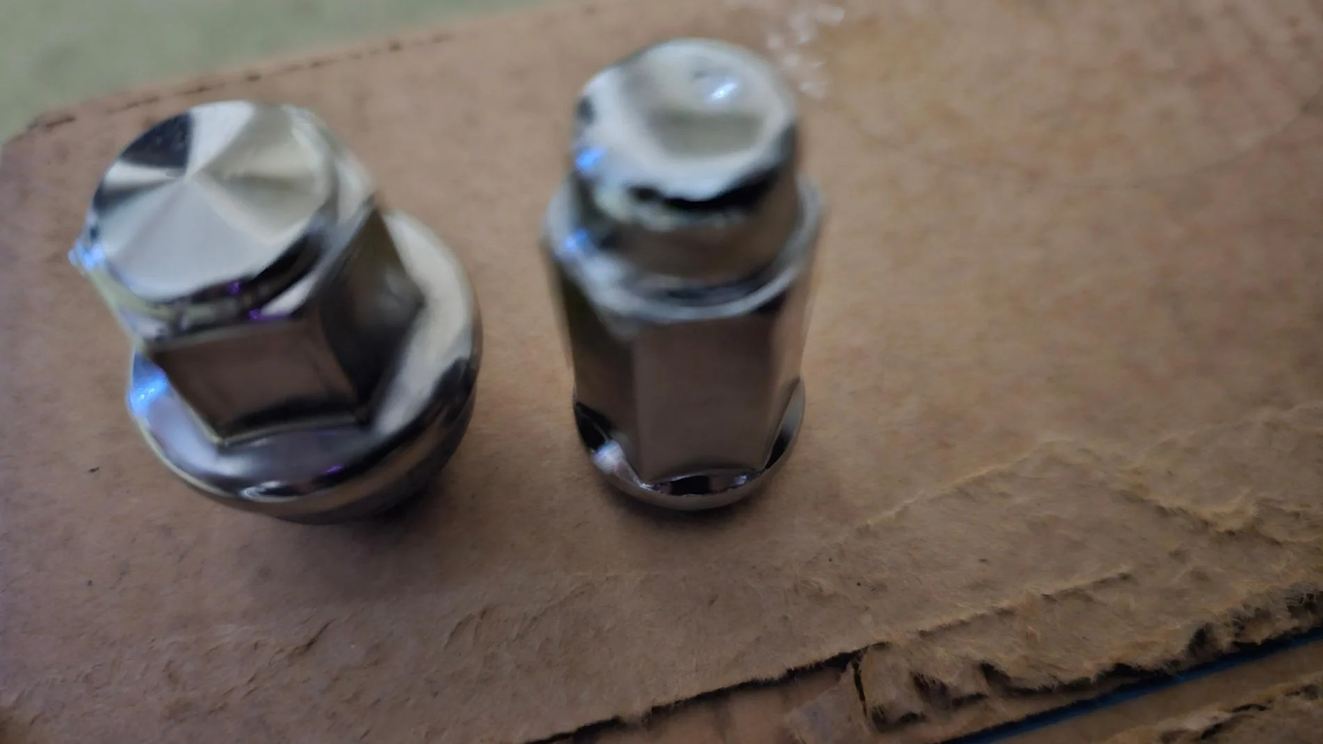

I bought a cheap set on Amazon for a 2012 F150. They worked, but I wasn’t real happy with them. The OD of the taper was undersized, so there was a very small part of the seating surface on the wheel exposed.

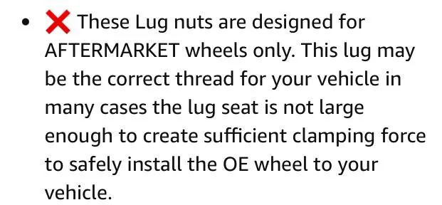

Did you notice this warning? It describes my issue exactly:

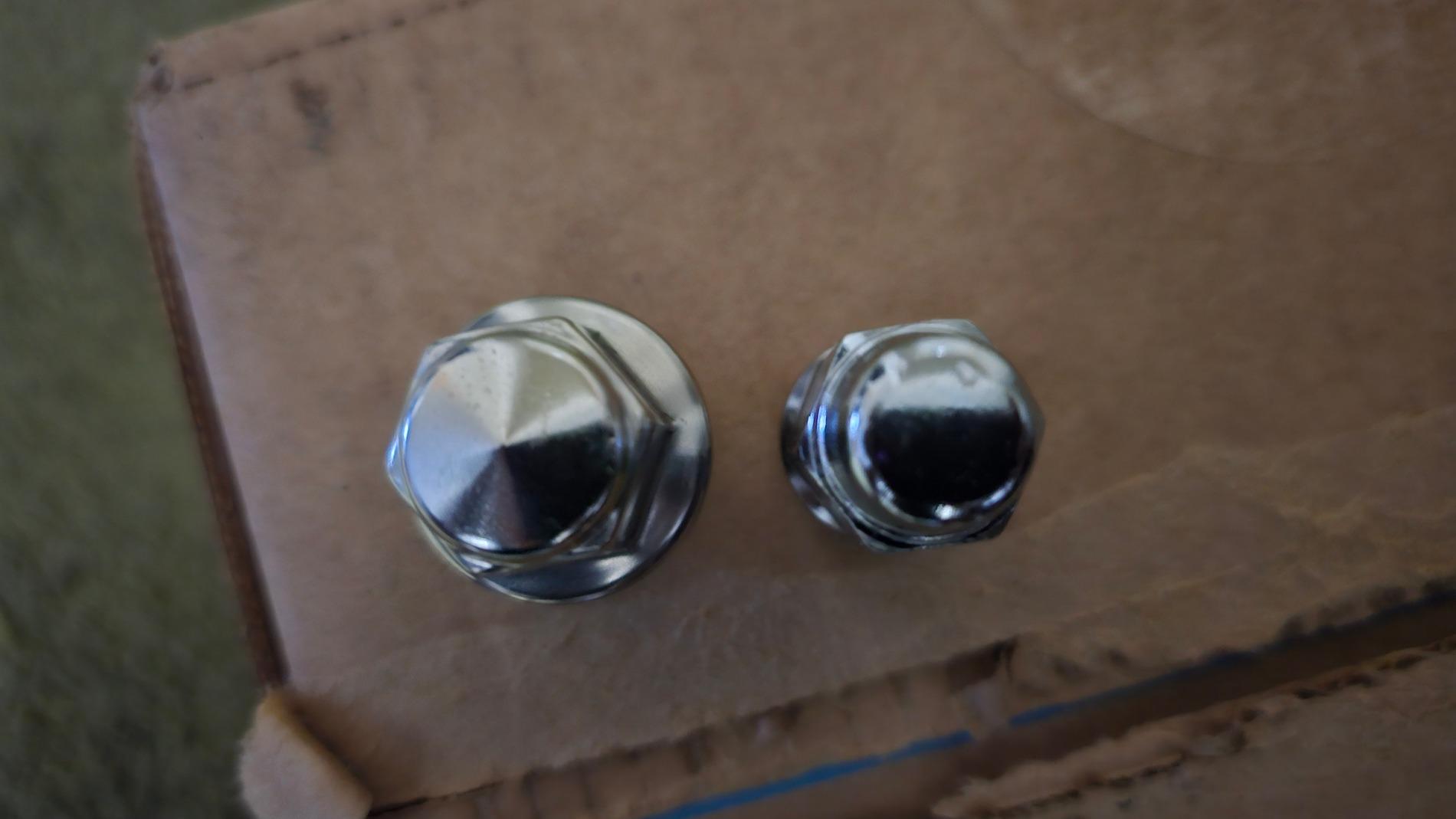

I’ve had good luck with Gorilla “OEM” style lug nuts. They seem identical in dimension to the stock ones. It is a common problem for aftermarket ones to have less contact area

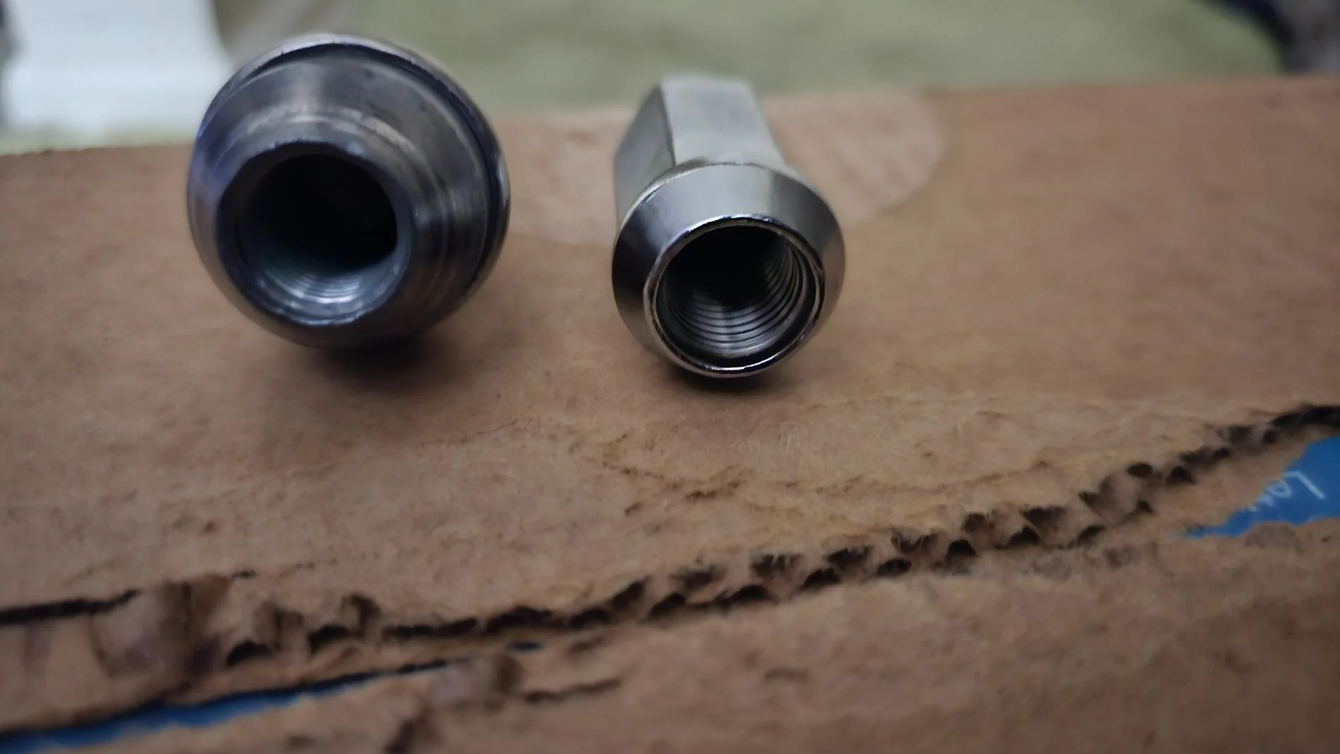

I thought I'd buy them from Amazon and compare them side by side and you are 100 percent right. They ought to be ashamed to even sell these. I'm returning them asap. Thanks.
Ford F-150 Lightning Replacing OEM lug nuts to avoid future swelling 20240811_220209
Ford F-150 Lightning Replacing OEM lug nuts to avoid future swelling 20240811_220214
Ford F-150 Lightning Replacing OEM lug nuts to avoid future swelling 20240811_220240
