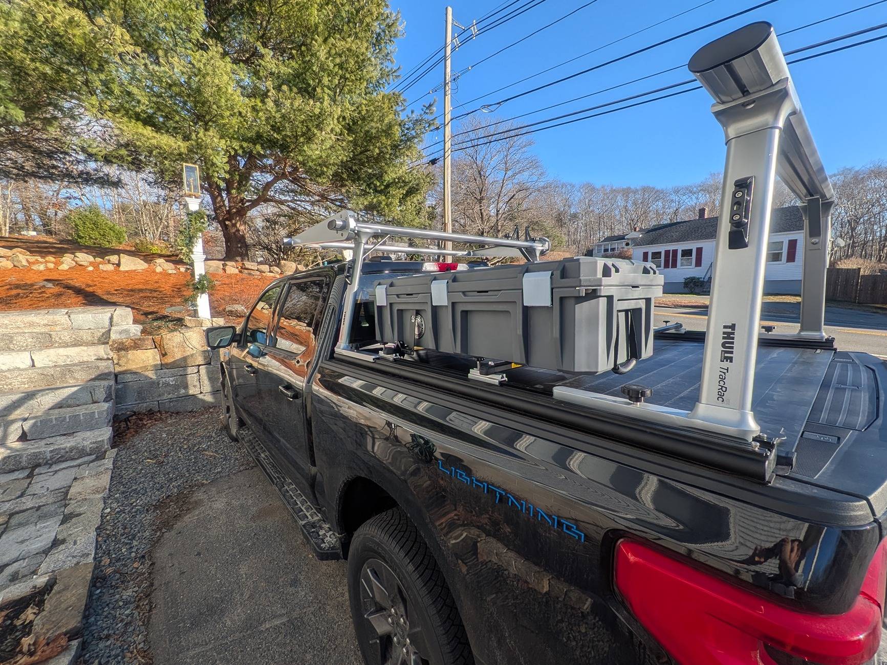

I have the Retrax Pro MX (this is the aluminum not the poly one), I wanted to get the motorized one but all the installers I called warned me against it, plus i couldn't get my wife onboard. I went with Retrax cause I also installed a Thule TraxRac ladder rack which seems to be the best tonneau cover combination I could find.
I had it installed in October, however the other day after some snow and alittle melt, it was indeed frozen shut. I think if i had cleaned it off better and opened it when it was warmer out before everything froze it could have been fine. So something i suppose you can deal with, i didn't particularly need to open it that badly when I noticed it, however I'm not sure what I would have done if I had needed to open it.
Also as said above the canister does take a fair amount of space, which make a small bed even smaller. I've resorted to roof boxes mounted above the bed rails and looking at getting one of those hitch mounted cargo carriers for when we go on trips.
Overall I'm happy with it and would buy again.

I have the same rack/tonneau setup and thought about the same cross rail system. Looks like you cut a TracRac toolbox mount and used it for the cross rails. I was going to do the same, any issues? Nice cargo box also, which one is it? Thx!
Dglambert
Devin
Dec 9, 2024
2024 F150 lightning Lariet ER
Software engineer
Yup! They are the toolbox mounts. I can't say i can take credit for it though, as i got the idea from this guy. Had a few other thing you'll need, lubricating oil, square nuts, low profile replacement thumbscrews. Overall im happy with it. It was a really pain before I added the oil though, so definitely needs to be lubricated. Also I had to cut the slides down so that I could mount two bars, I cut them short so they didn't have to take up as much room when I push them towards the cab out of the way, however having them short like that just means they don't slide as stable together, as when they are longer, but not really a problem just an FYI
Toolbox slides - https://www.amazon.com/dp/B0002IGGH6
Inno cross bars (79 inch) - https://www.amazon.com/dp/B004TRIHLO
PTFE Oil - https://www.amazon.com/dp/B000UKUHXK
Replacement thumbscrews - https://www.amazon.com/dp/B0CRZ8S13M
Square nuts - https://www.amazon.com/dp/B07TDSPQWT
The box is this one. I shopped around a ton, and realized this design had been ripped off so many times, so i just found the company who had it for the lowest price, however you have to get two pairs of the mounts, and 4 more bar clamp style mounts to connect it to the rails. I actually just ordered a second box from Amazon open box.
Hard case - https://www.amazon.com/dp/B09Q7ZVL4Z
Hard case mounts (2) - https://www.amazon.com/dp/B0BX4QH3ZY
Bar clamp mounts (4) - https://www.amazon.com/dp/B0CT8W4ZN7

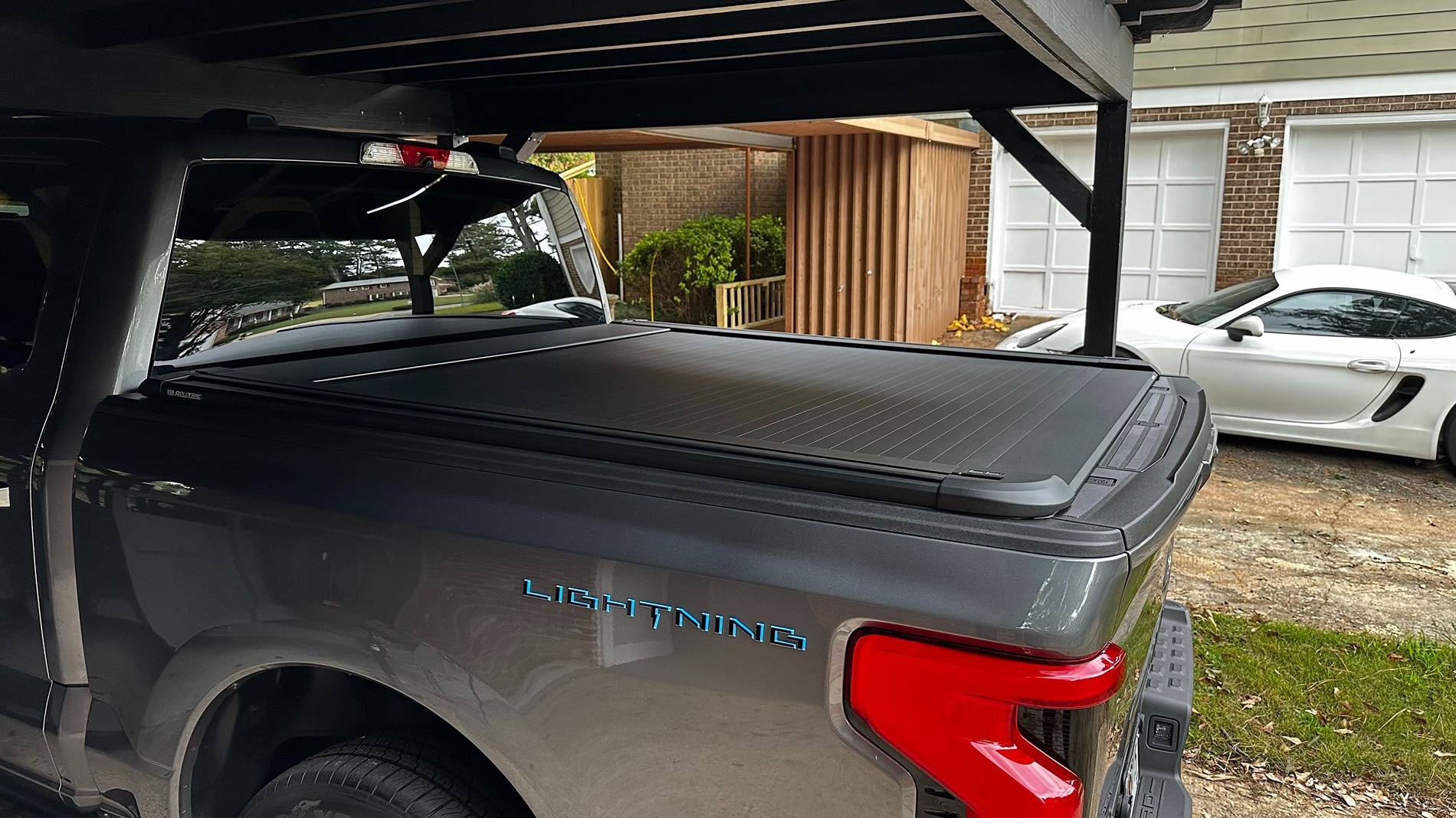

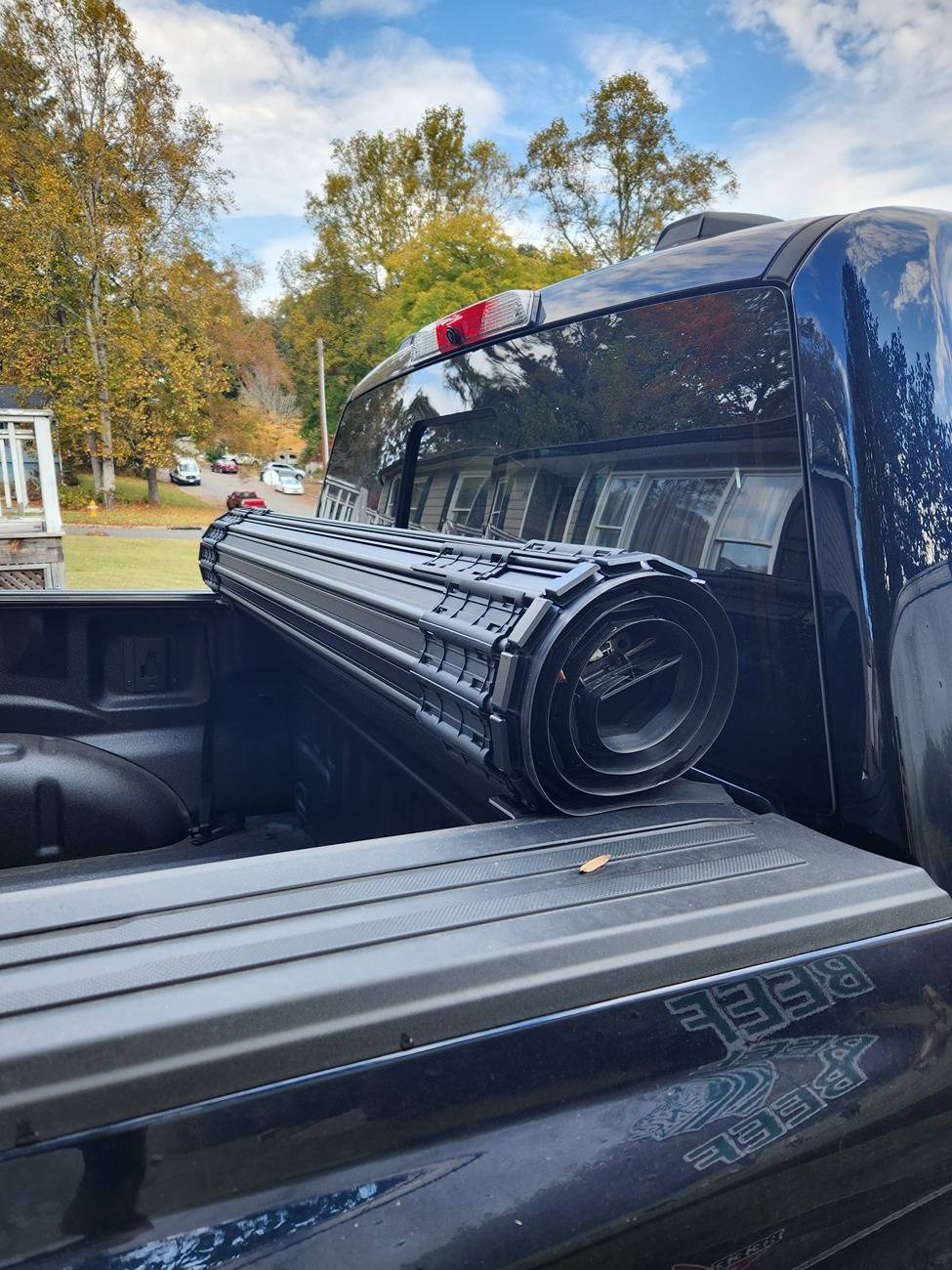

I love my egr rolltrac. I debated for months and this one finally won out. It's amazing and is a composite canister.

Did you install it yourself? If so, how was the difficulty?
I installed it with my friend and it wasn't terrible. If you ever get one I'll help you with any questions because some parts were a little weird, but it's totally doable with two people. The egr team, which is supporting, from Canada is really helpful.
Make sure you buy the 3M adhesive promoter if you buy it and when you align the side pieces to the retractable part it's best to do that sorta standing up instead of on the table so that gravity helps you line it up. You need a big table or floor for one part. And the door harness part is just tight, because it's just a tight fit in general. But it worked completely perfect for me the first time. Running the wire on the frame was also easier if you have the standard running boards it's a good channel to hide the wire.
