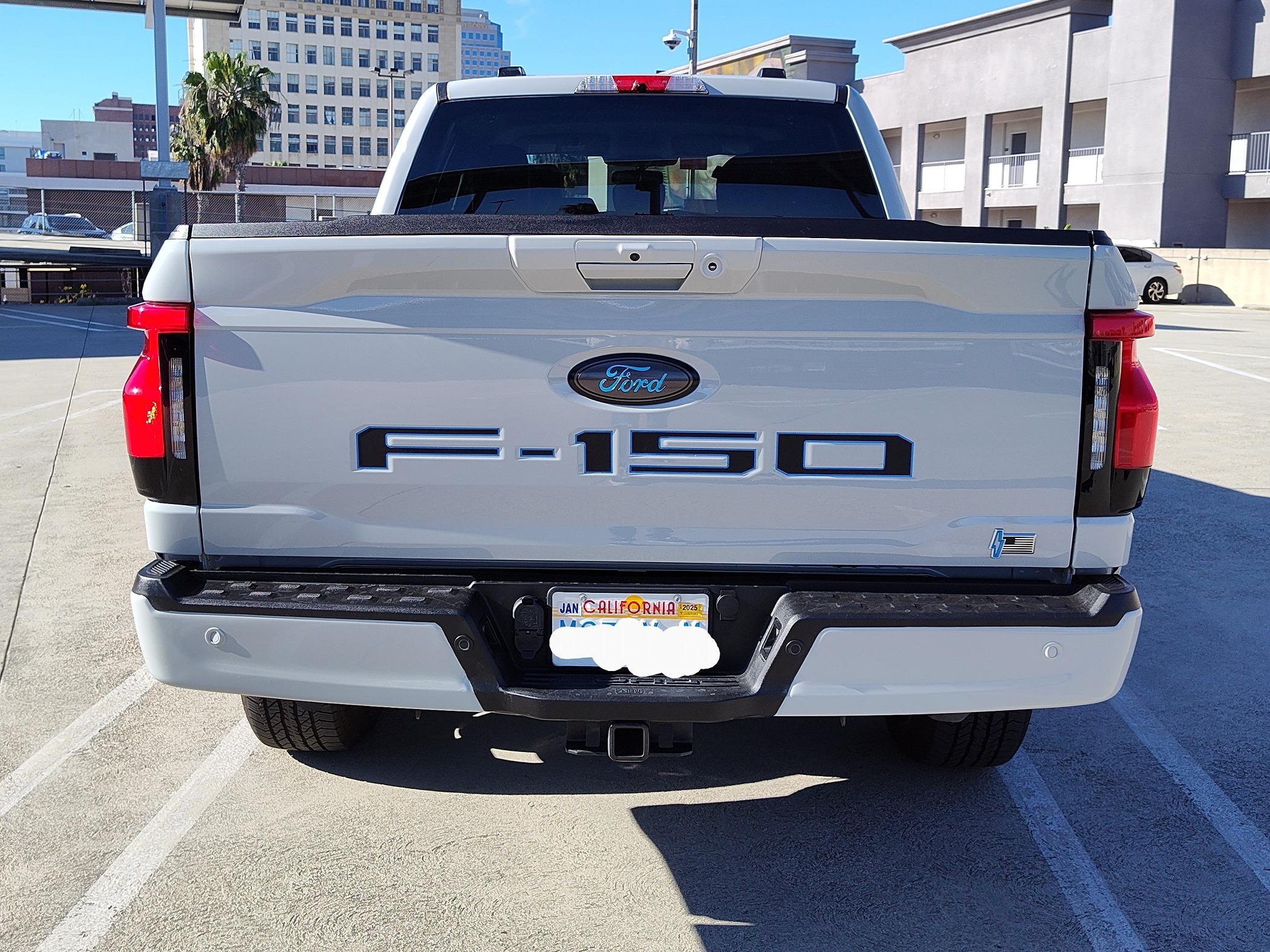

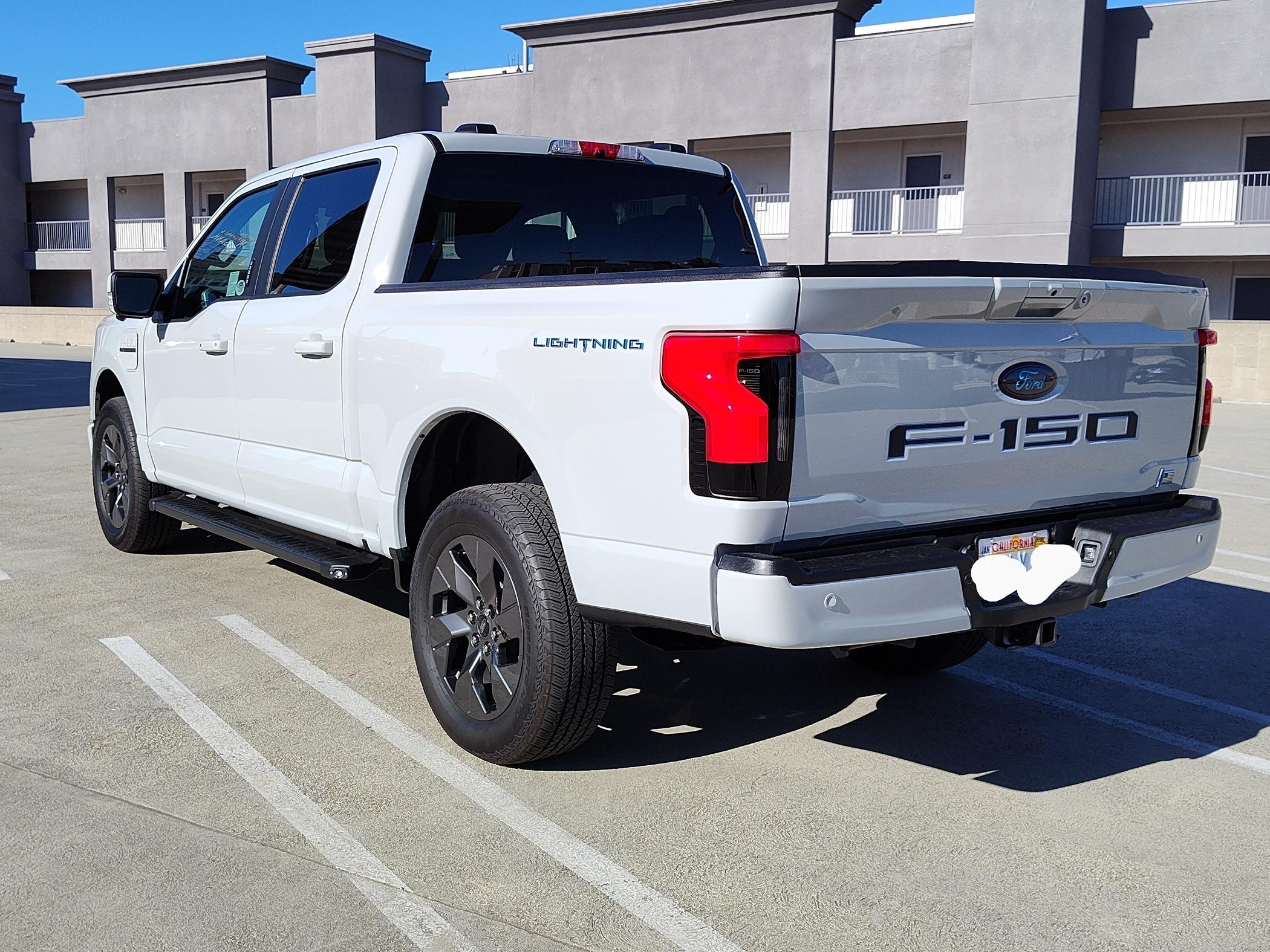

@Mcfly did you remove the bumpers before painting? what do you think of the paint job using a spray can?

I did not remove, I used painters tape and plastic sheeting to cover the hood and tailgate.
Link to the plastic sheet
Dura-Gold 16' x 350' Roll of Pure... https://www.amazon.com/dp/B09CVC13XB?ref=ppx_pop_mob_ap_share
It came out great, most people wouldn't notice it's not from the factory. I'm not sure how it would come out on metallic/pearl paint. But on mine it worked fine. These paint cans are really close to paint guns in quality. They don't splatter and cover evenly.

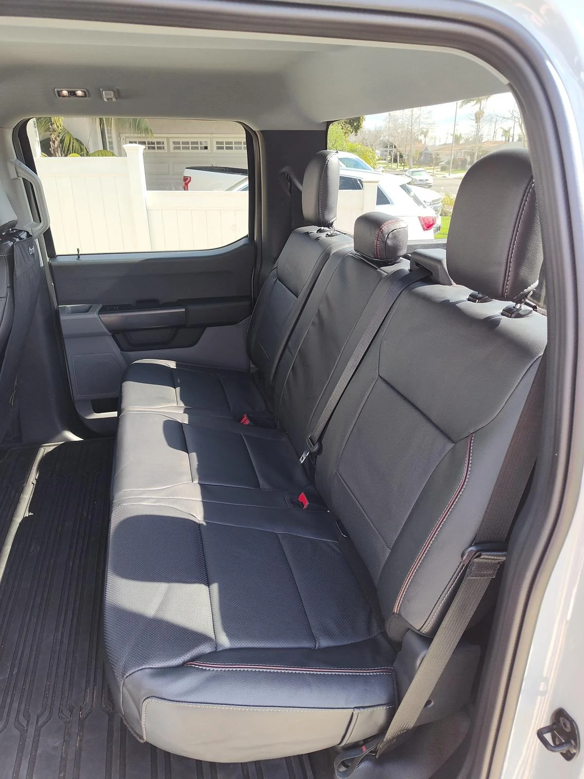

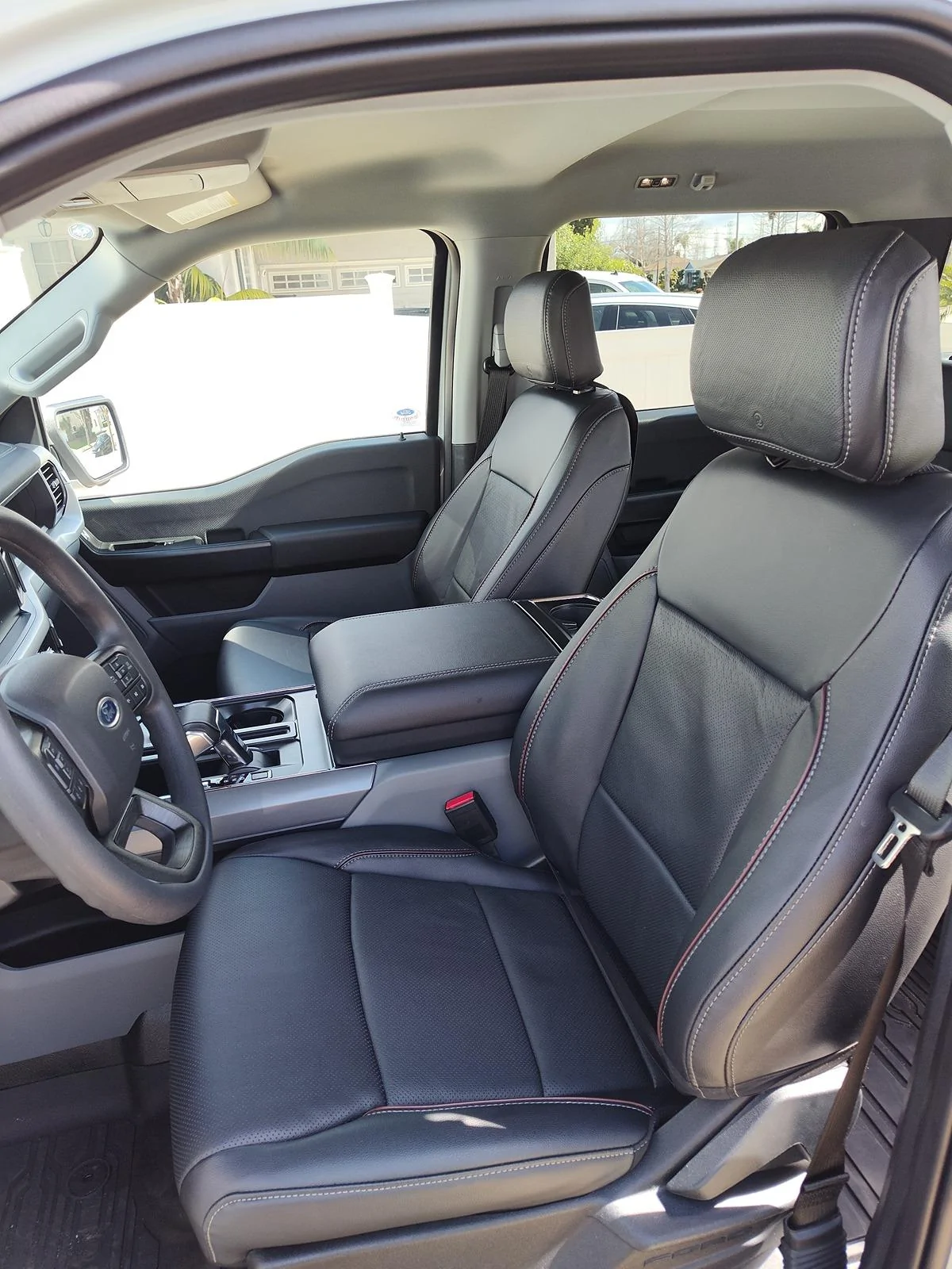

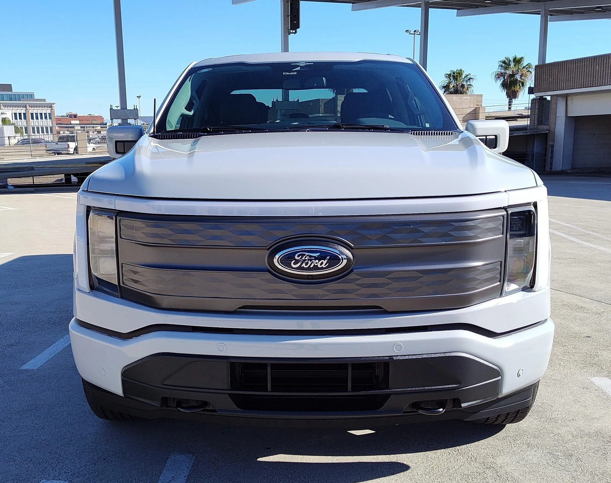

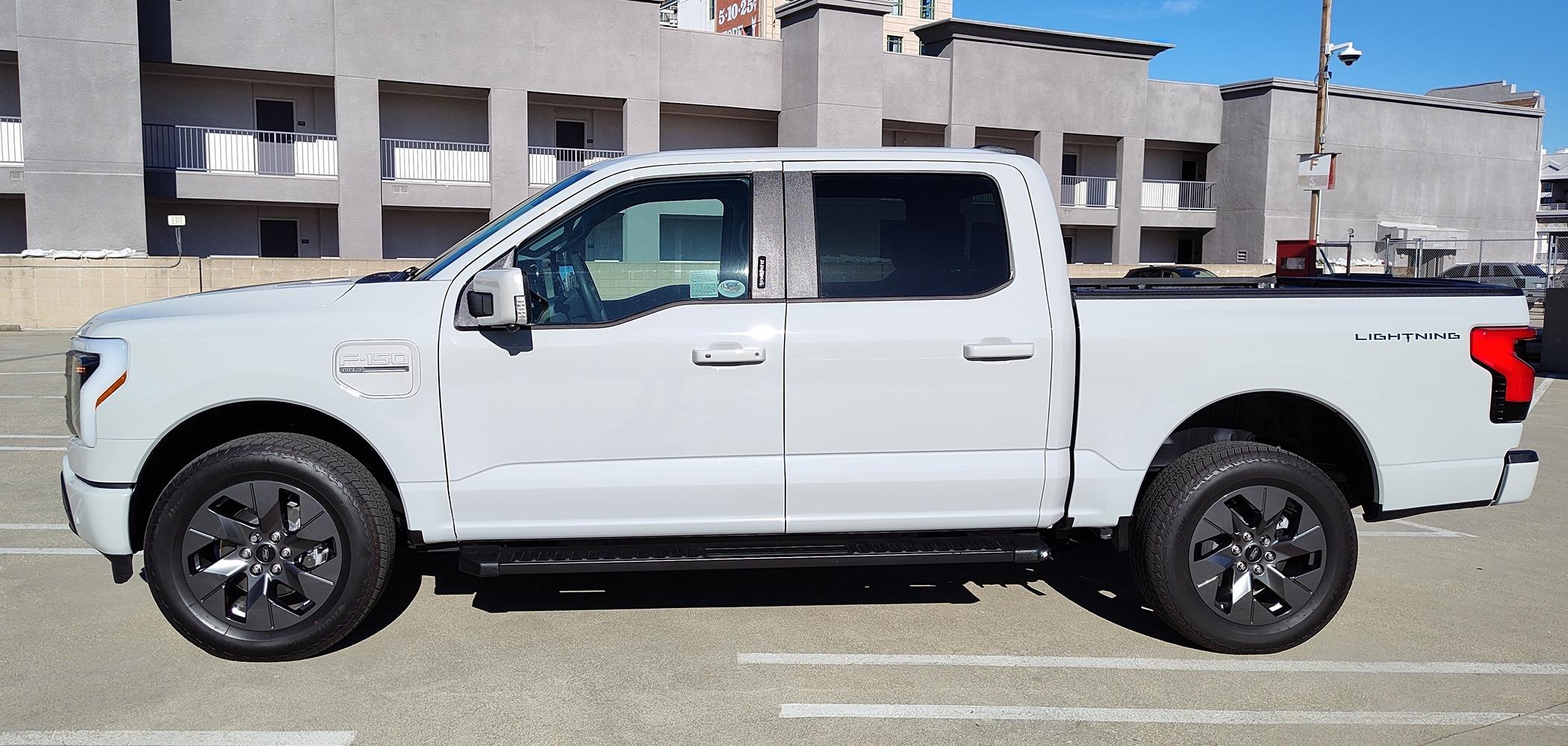

My goal was to transform my 23 pro into a budget XLT/Lariat. I was able to add some features my truck was missing thanks to trail blazers on this forum, glare free headlights, remote front windows down, bed lighting, passive keyless entry/lock, door keypad, front light bar, and adaptive cruise . All the paint matching on the handles, mirrors and bumpers was rattle can in my driveway. If anyone would like additional info let me know, I'll share some links and part numbers below. Down the road I want to add the upper glove box and a leather steering wheel.
Lariat Grille, purchased salvage off Ebay $300
Lariat Wheels, swapped with a forum member for my stock 18's
Steps, New Ice take offs Ebay $180

Leather seats, new Ice Lariat take offs Ebay $150
Door handle and mirror caps, https://www.trimillusion.com/oem-pa...vdbsnpy8DkUxJsgrHAatd52Dza0KauMIaAuEzEALw_wcB $120

Paint, primer, base and clear https://usa.specialistpaints.com/collections/kustom-canz-kits-custom-aerosol-can-kits $300

Very nicely done! This is something I would've totally copied you on if I hadn't traded in my Pro for an XLT ER.
