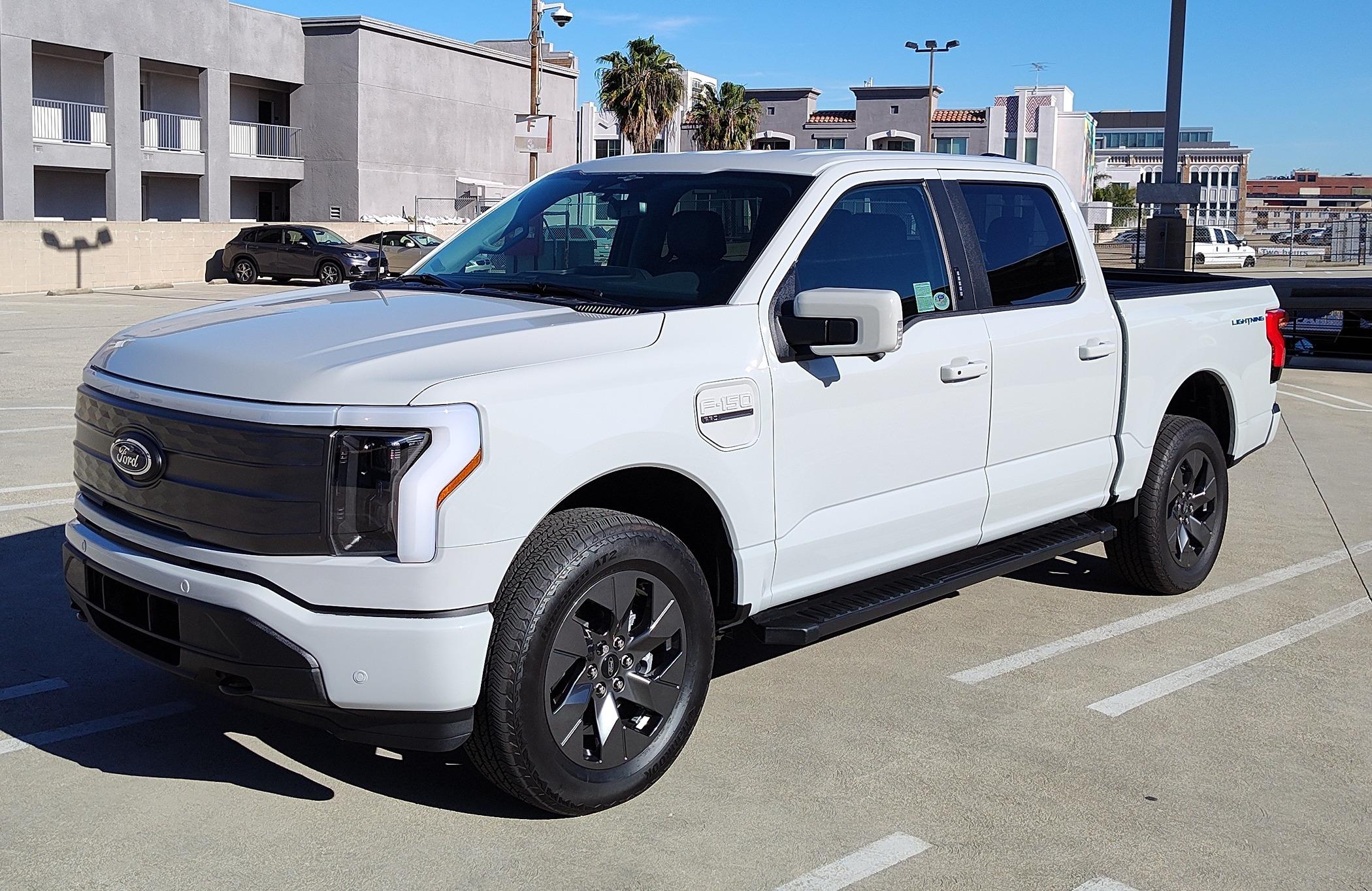

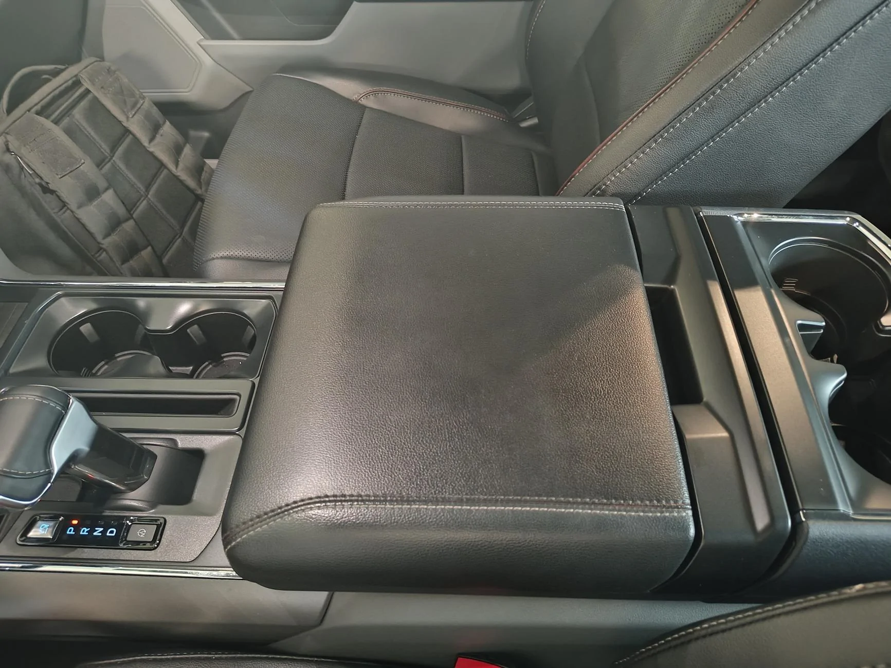

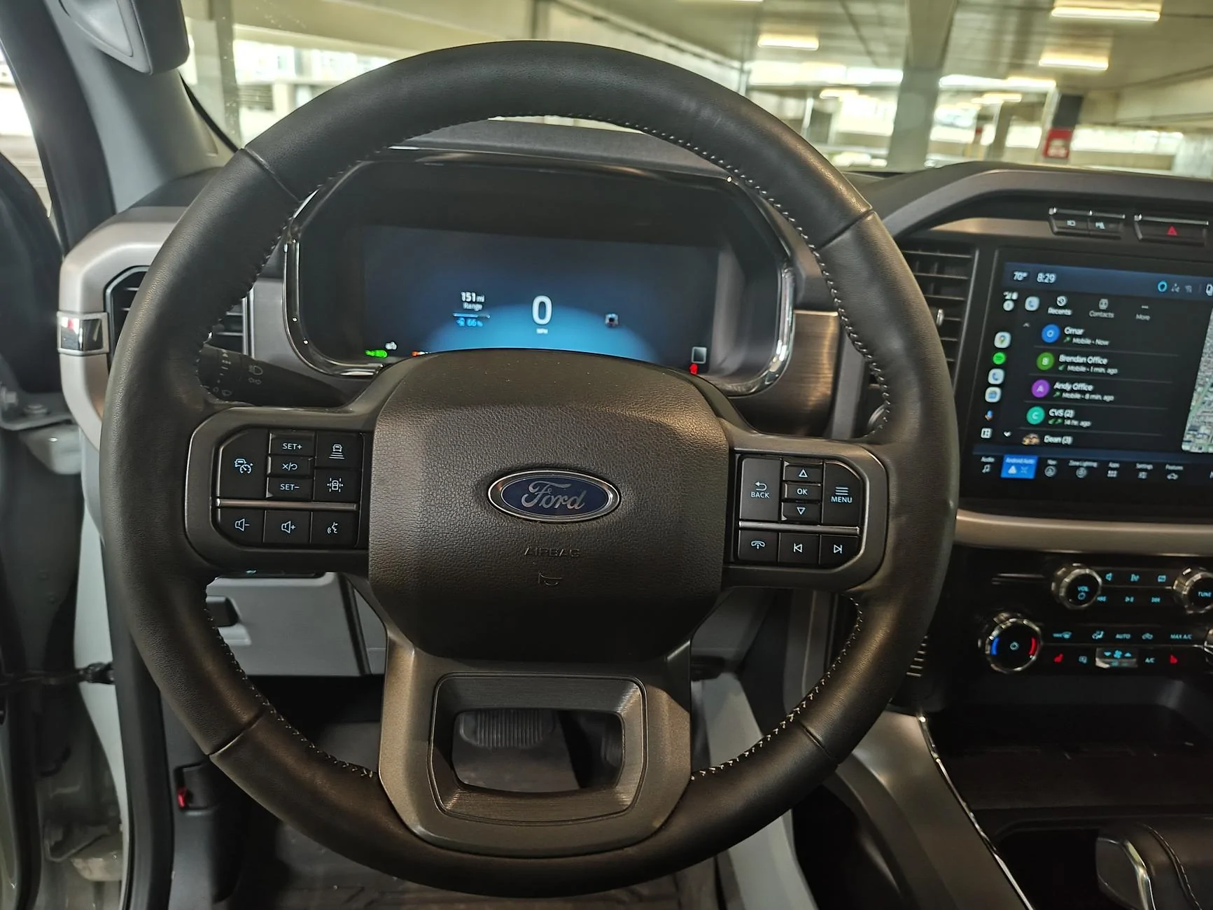

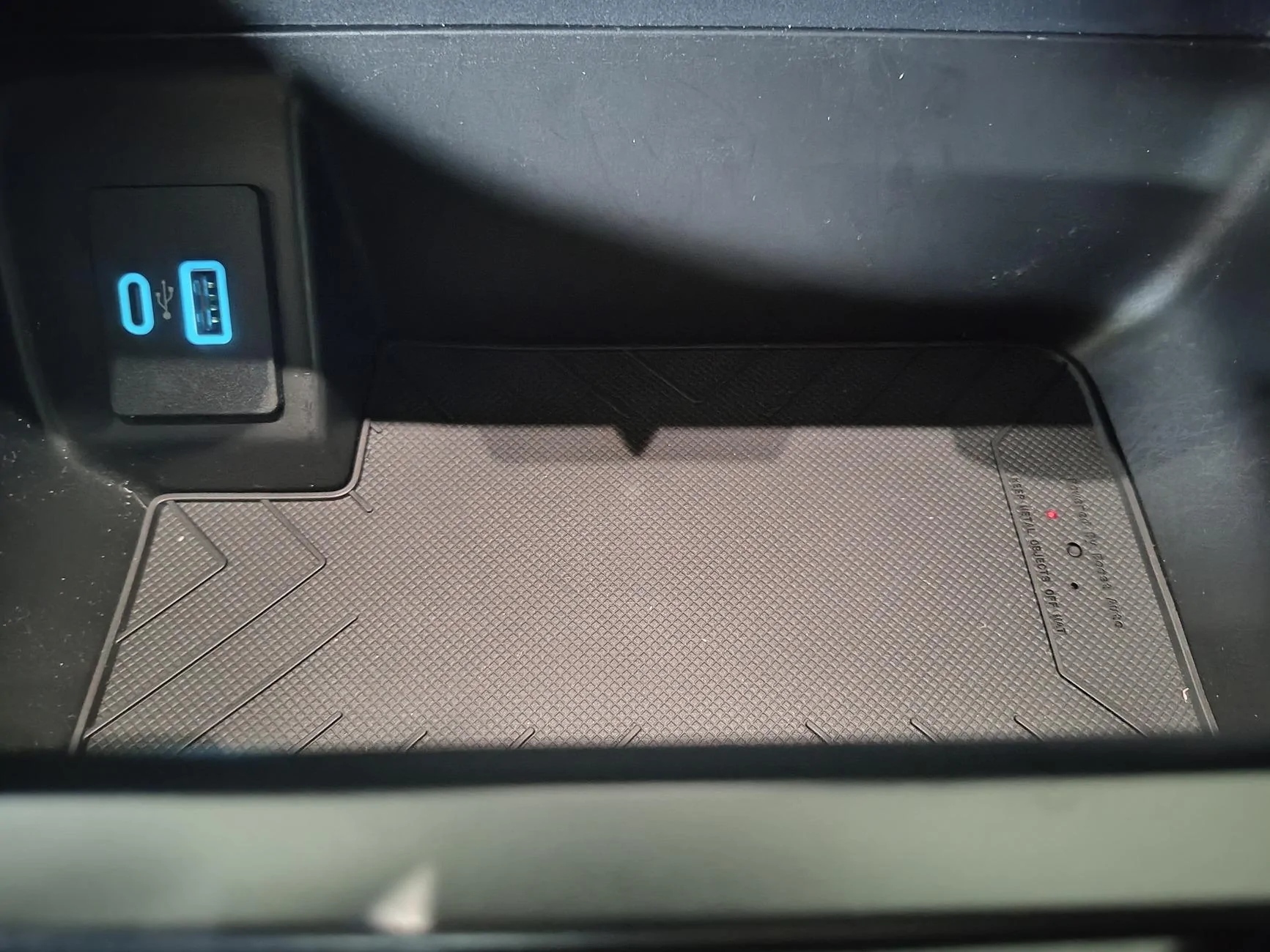

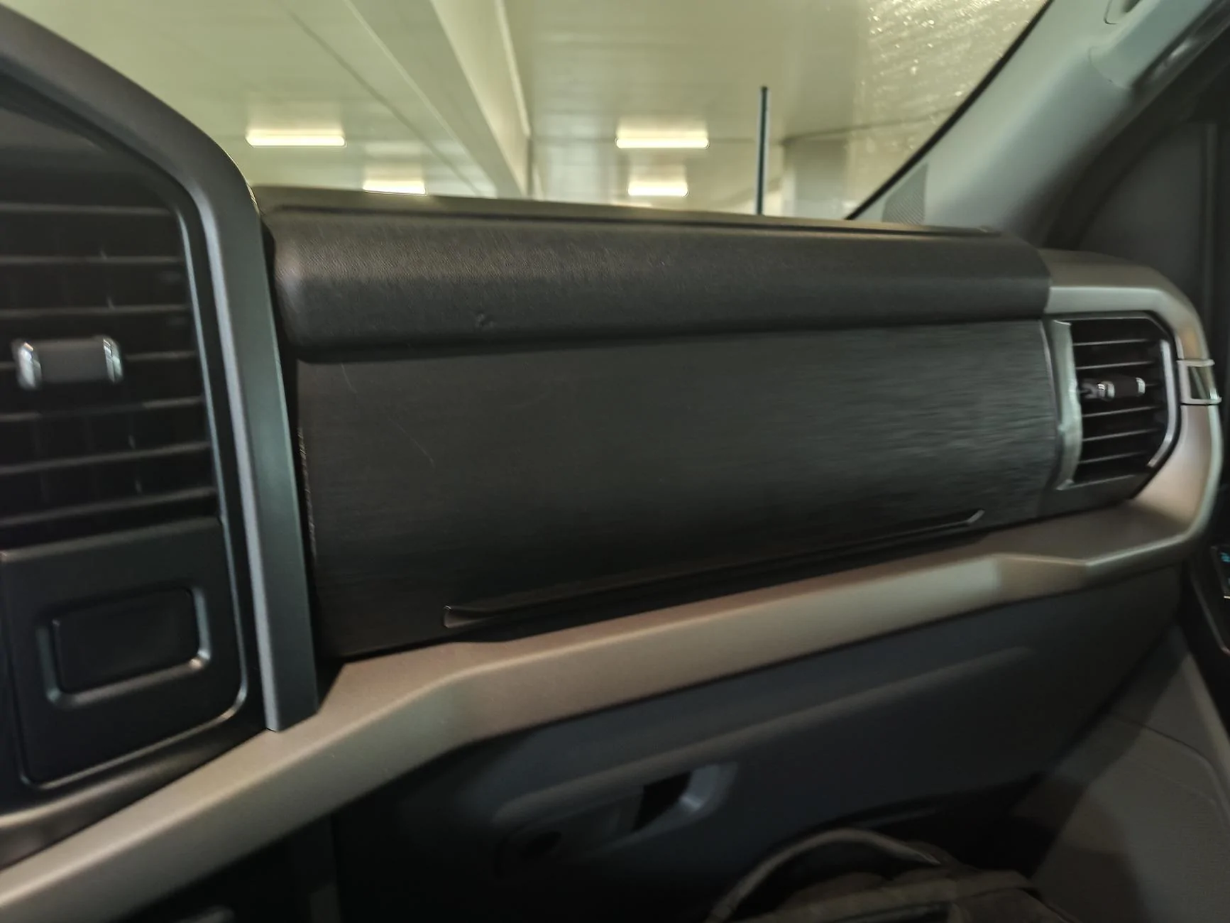

My goal was to transform my 23 pro into a budget XLT/Lariat. I was able to add some features my truck was missing thanks to trail blazers on this forum, glare free headlights, remote front windows down, bed lighting, passive keyless entry/lock, door keypad, front light bar, and adaptive cruise . All the paint matching on the handles, mirrors and bumpers was rattle can in my driveway. If anyone would like additional info let me know, I'll share some links and part numbers below.

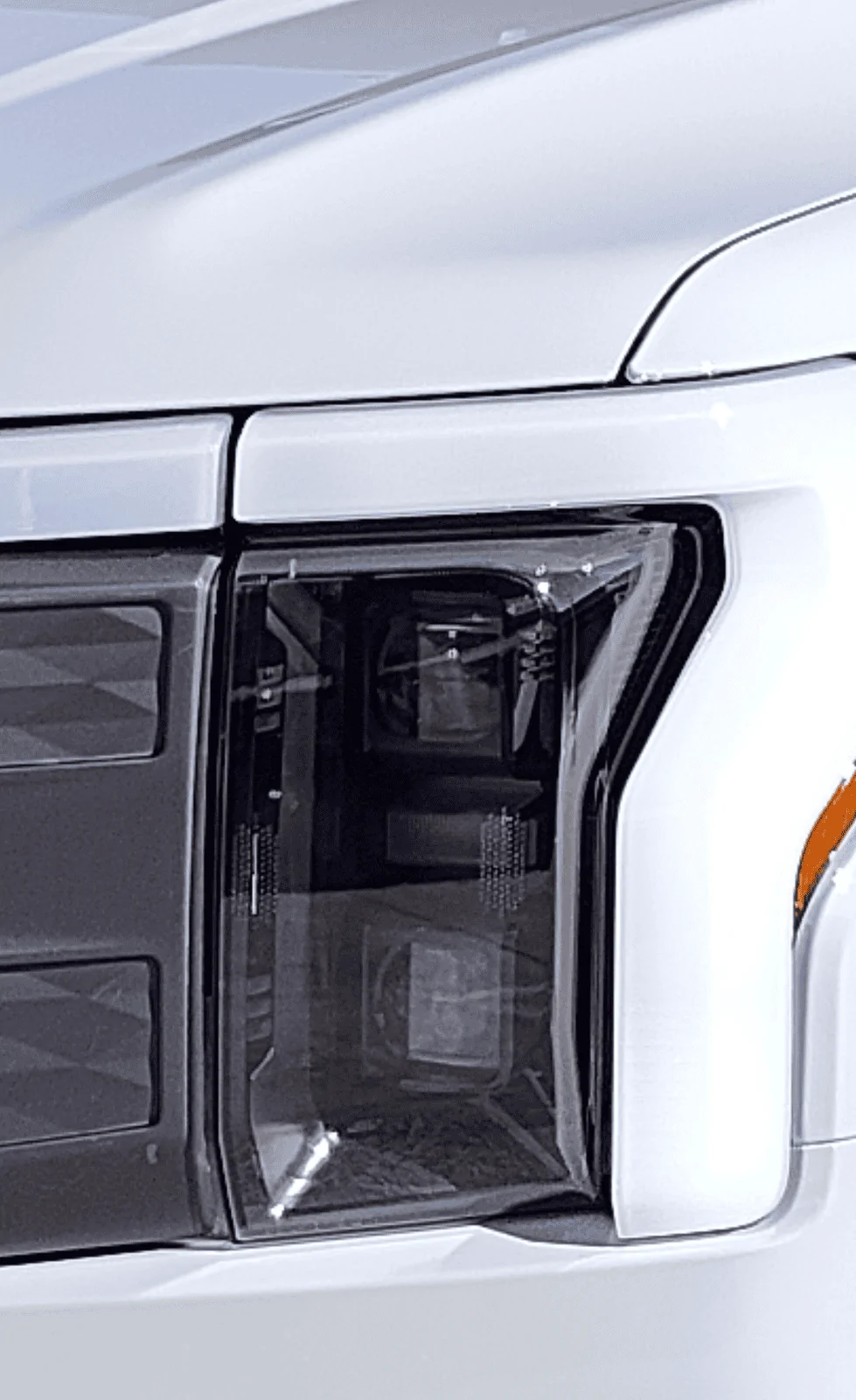

Everything looks really good, is your headlight broken?
Thank you!
No, but I see what you mean. Must be the lighting.
