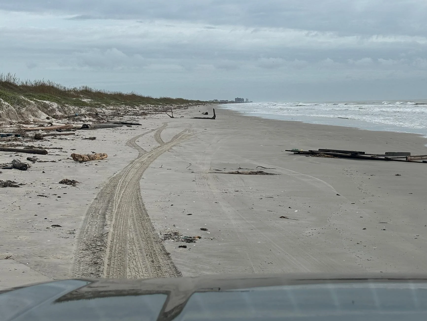

Good corroboration. This morning‘s drive looking for leftover hurricane surf. Beryl pushed a bunch of stuff up to the dunes.
Ford F-150 Lightning Sand Driving 1720447193933-et
