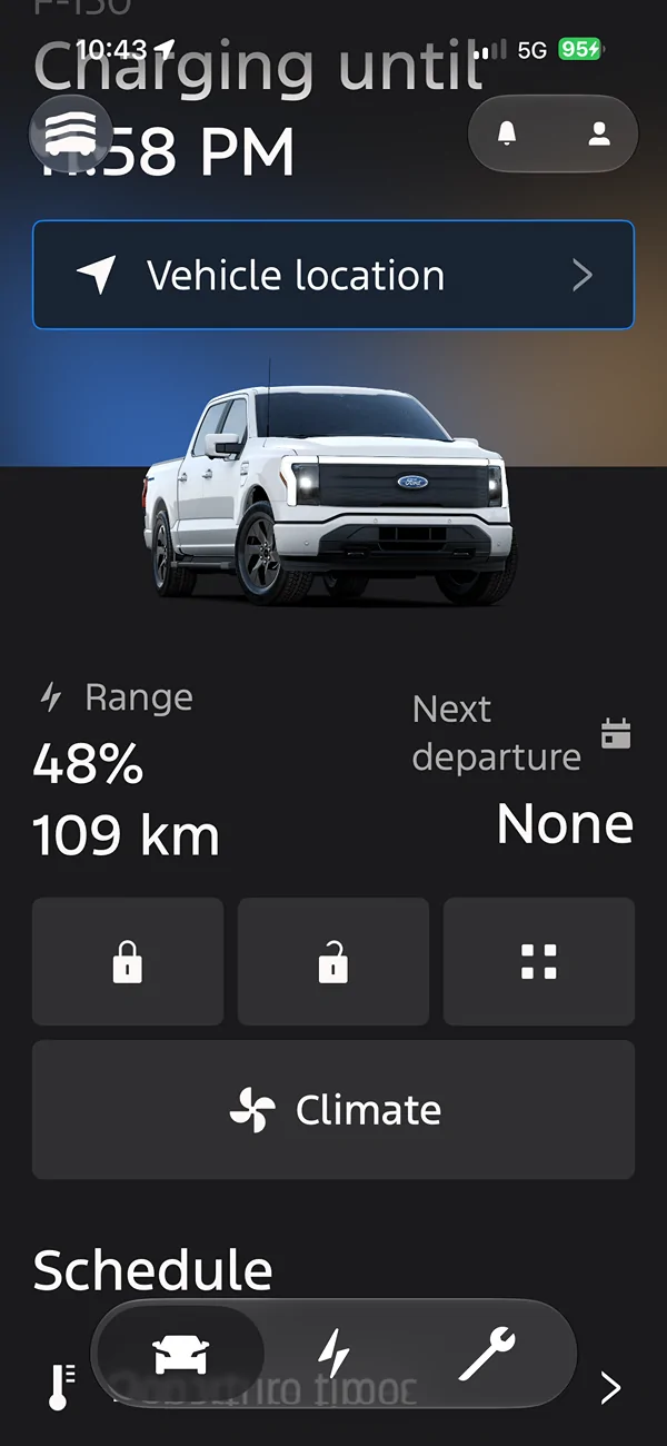

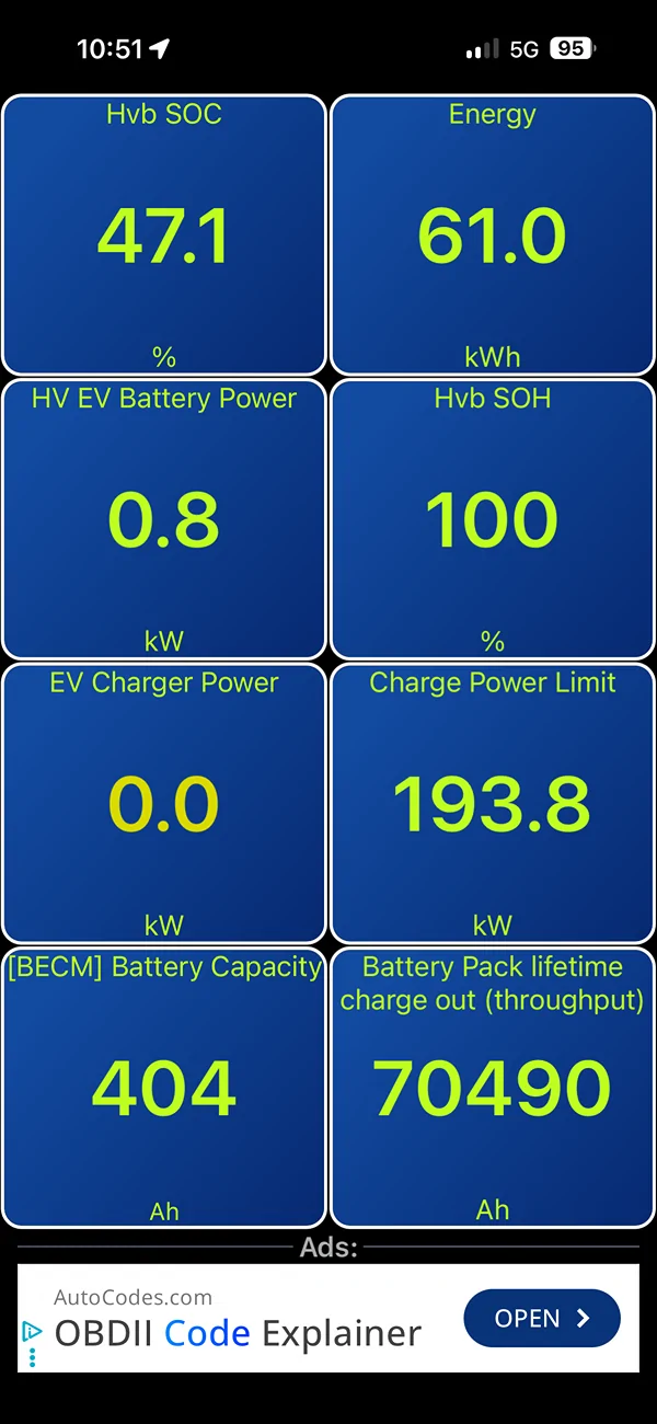

So 1 more question. Did a full factory and EV stat reset. I know GOM is not accurate but it’s so far out of line that it is bizarre. Currently at 49% charge and shows 109km range for an extended. Not terribly worried as my stats in Car Scanner look ok, but anyone ever seen this? With my Mach E it was always the opposite with the GOM being wildly over the top.

Figured it out! For some reason, it was stuck thinking it had a trailer attached
That was going to be my suggestion for you and future viewers of this thread, the pesky trailer attached is usually the culprit
if you tow a trailer, and disconnect the trailer with the truck off, you have to manually tell the truck you don't have a trailer attached.

Take energy / SOC (displayed) * efficiency. That's your current range.
