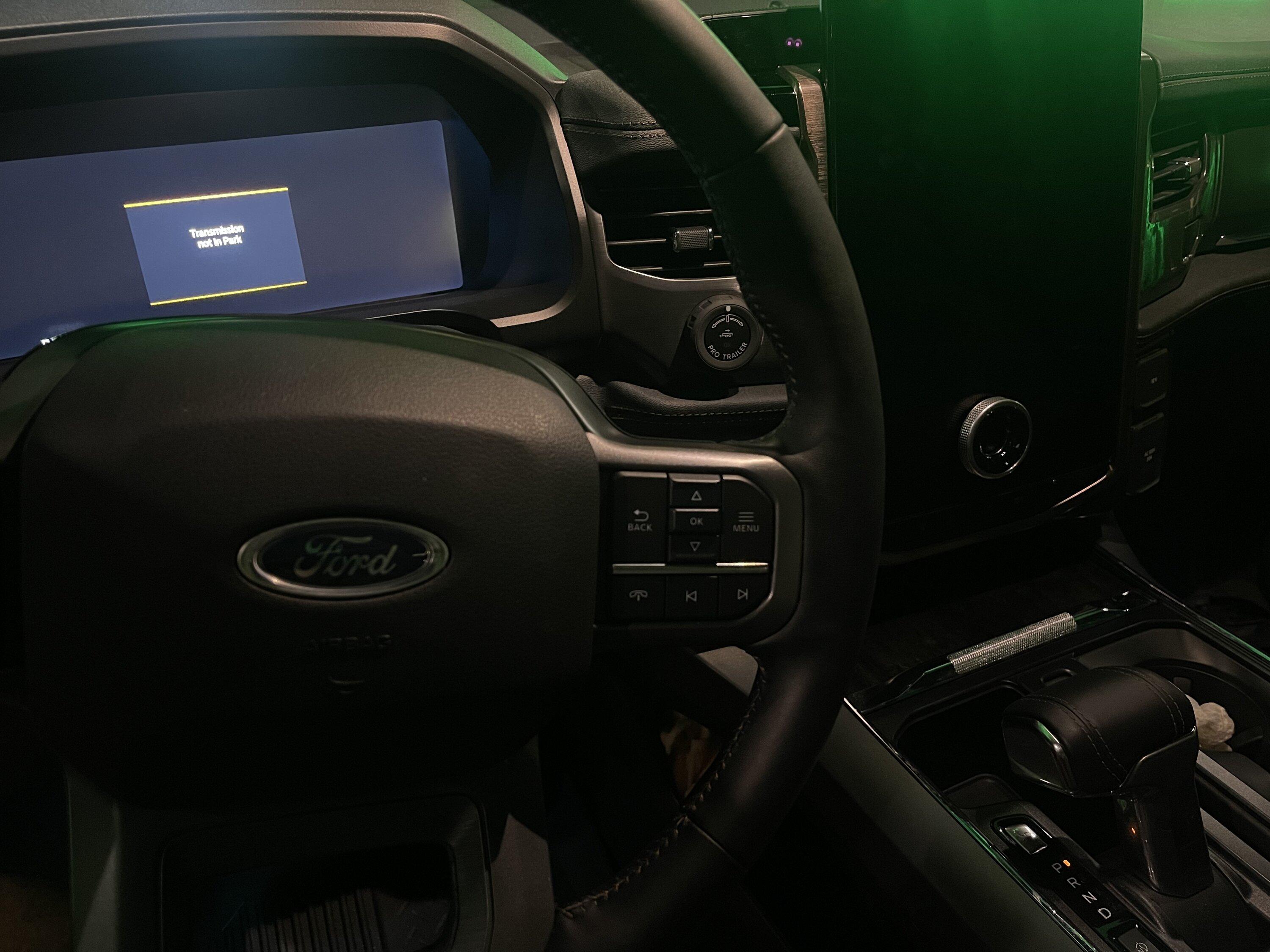

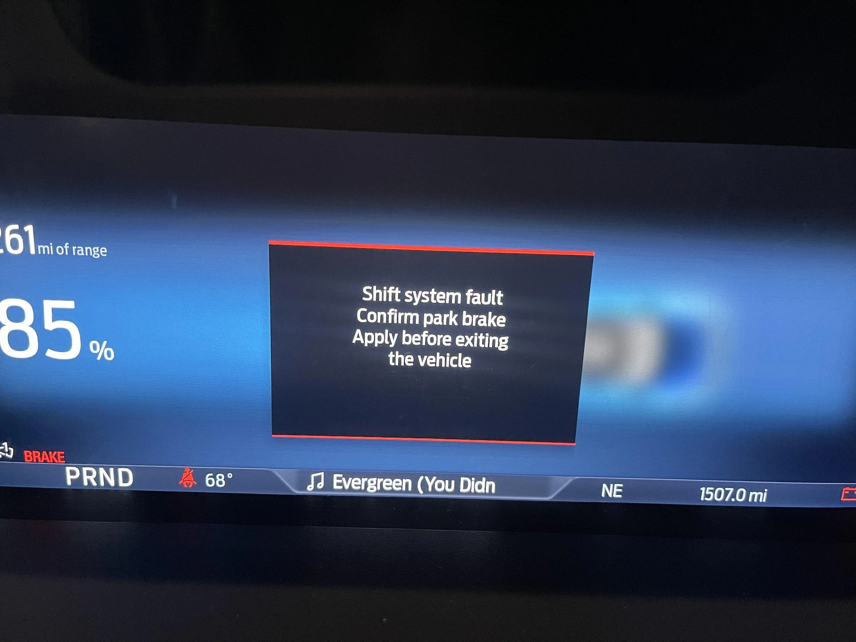

Does anyone know how to resolve this? The car was driving normally. I pulled into a parking spot and as soon as I exited the vehicular, it started beeping and flashing.
The P on the shifter is blinking, and when I power on the car, I get a message that the shift system has a fault.

Did you put the parking brake, confirm it's in park, then switch it off and hop out?
Give it a minute, then hop back in and see if you still have an issue.
I saw something like this when I opened the door when it was in motion and it got all hot and bothered... But there were no long lasting effects.

The parking brake is set. I was able to power off the car, hop out, let it sit for half an hour. The issue persisted.

I keep getting messages that the transmission is not in park. It’s in park, although the park indicator is flashing in the shifter

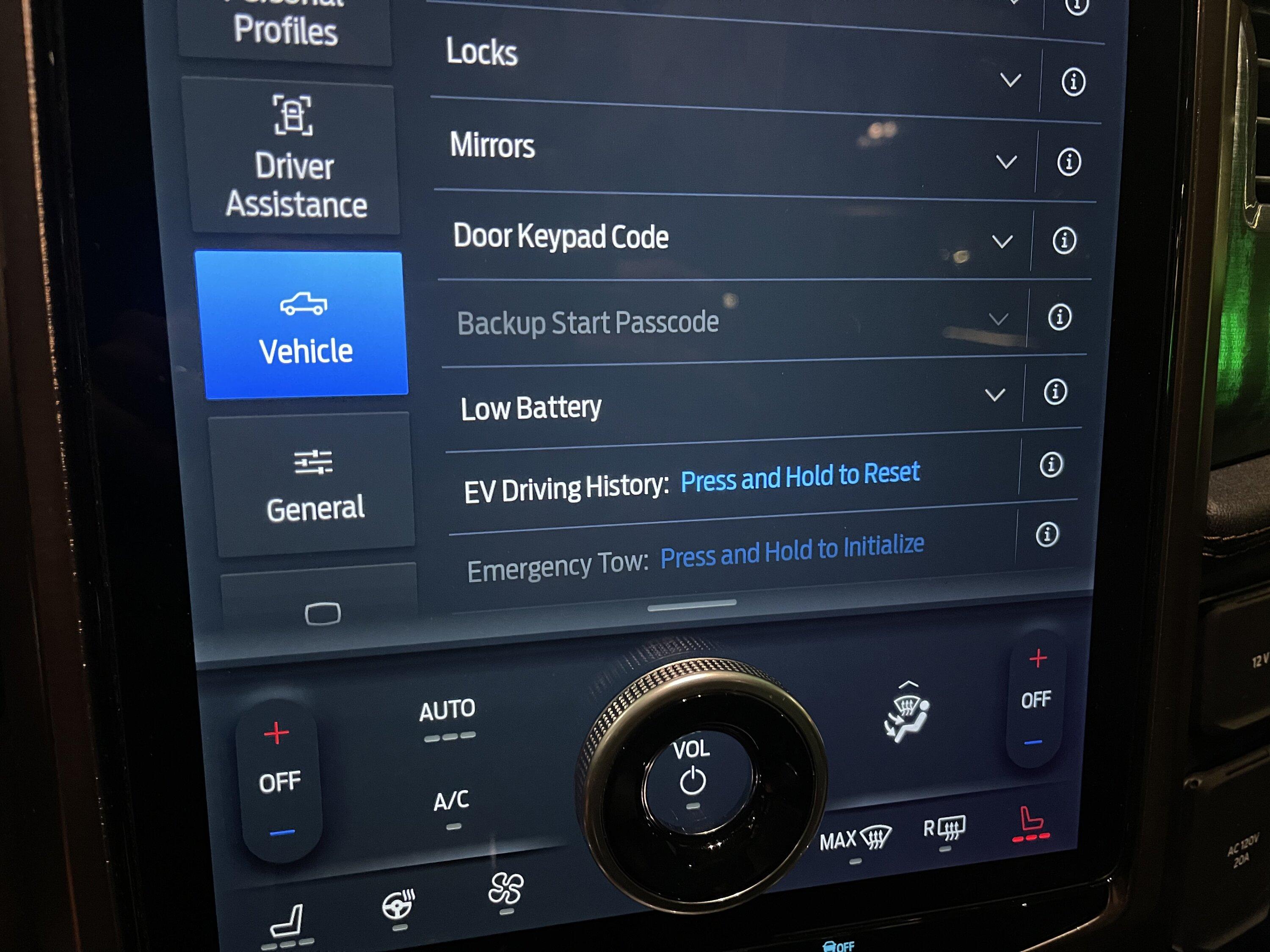

I’m also not able to put the car in neutral for it to be towed.
emergency tow is greyed out in the settings. Any ideas?

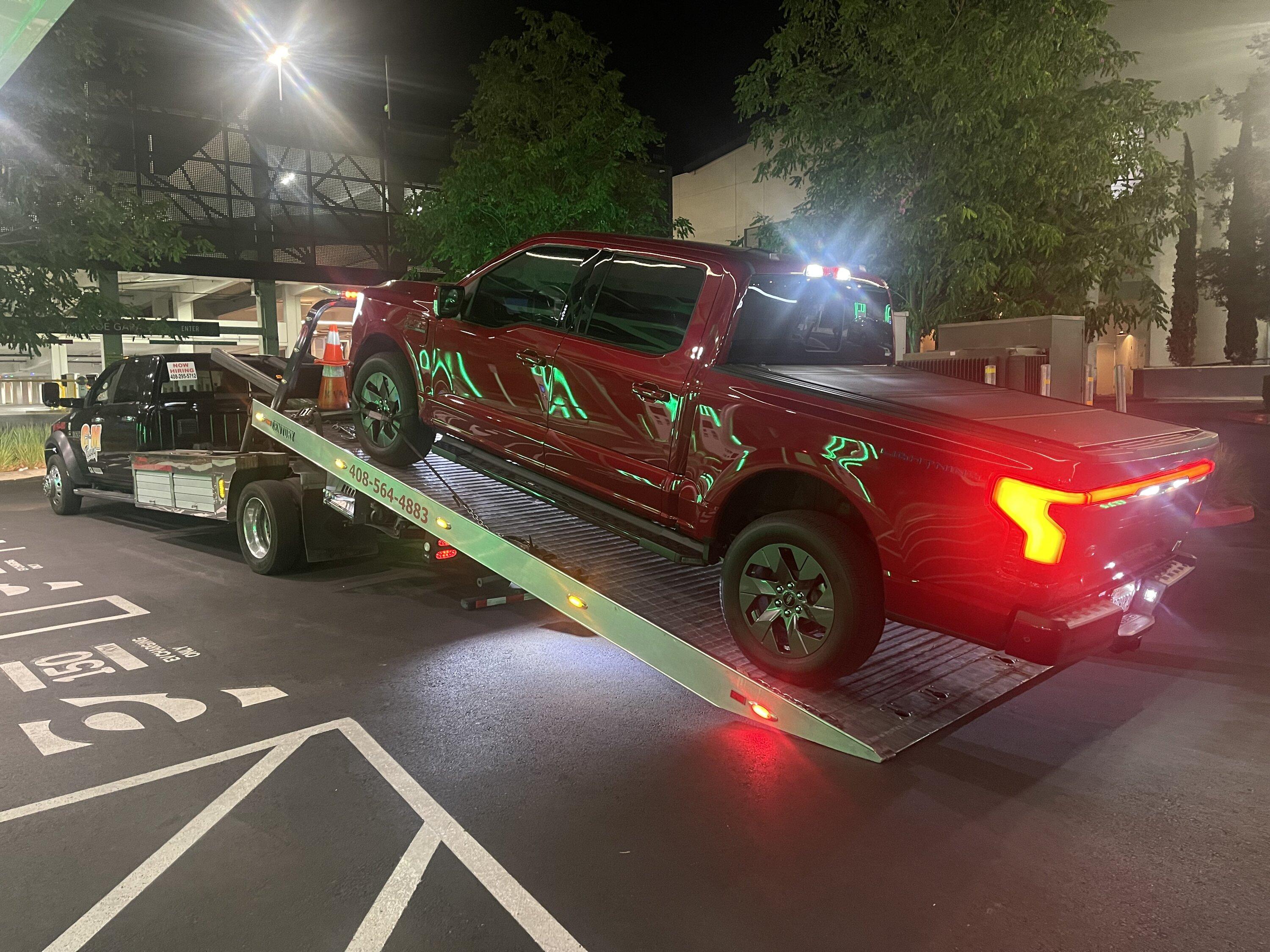

Alright, so last update for the night.
I called ford and they sent a tow truck. the tow truck driver and I figured out a way to get the car in neutral.
I found that when I pressed the brake pedal, held the parking brake down, and then released the brake pedal without releasing the parking break, the car would roll. so we were able to roll the car out of the parking spot, and onto a flat bed.
the car has been towed to a ford dealership. and I will call them in the morning and inform of them of the situation.
